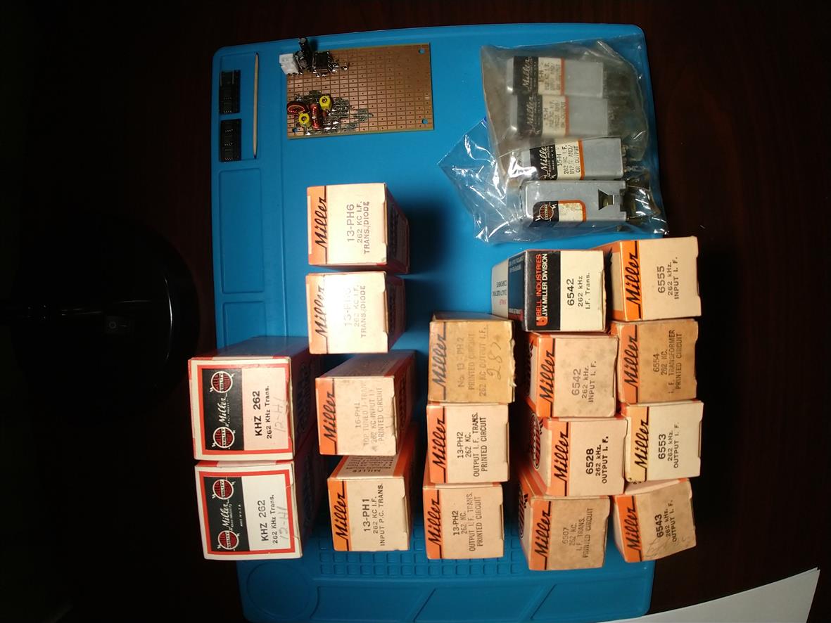

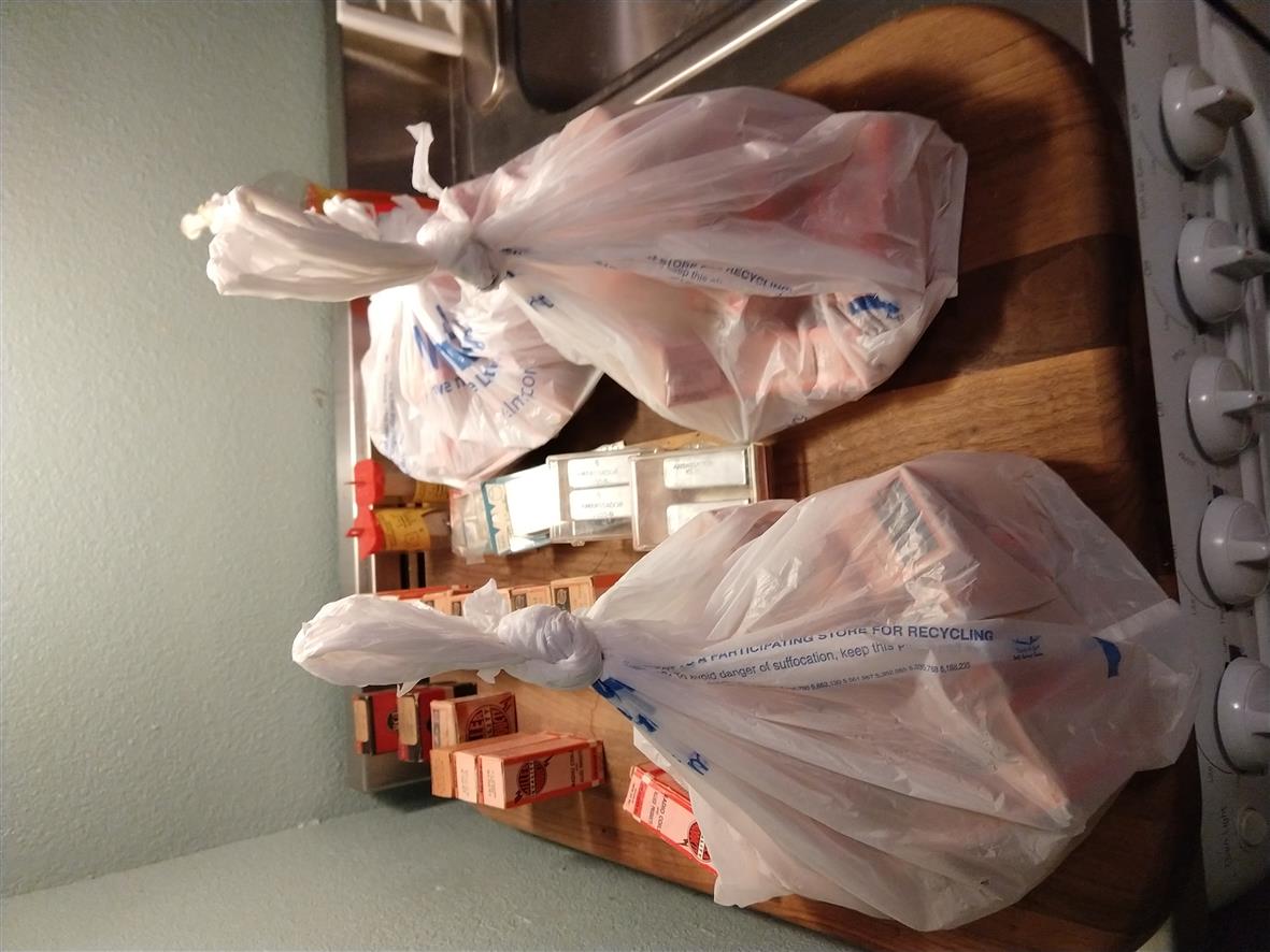

Ham shack at home is less than a mile from the office, so I ran home and found three more sacks of Miller coils.

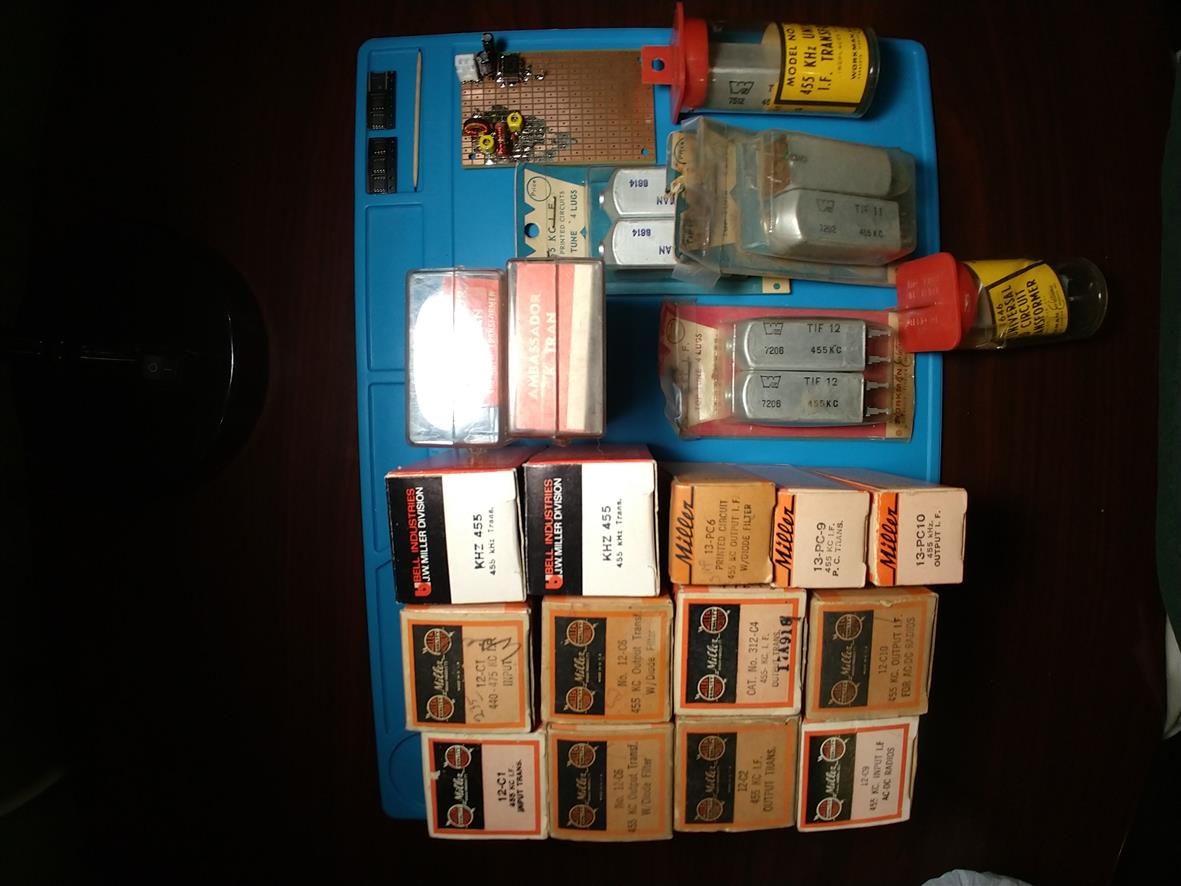

Tons of 262 and 455 KHz.

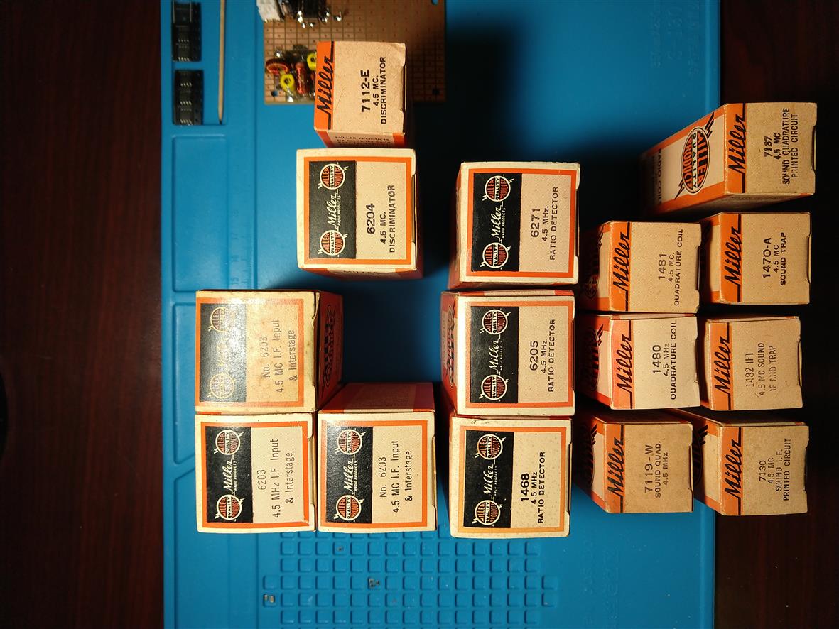

Several sets of 4.5 MHz.

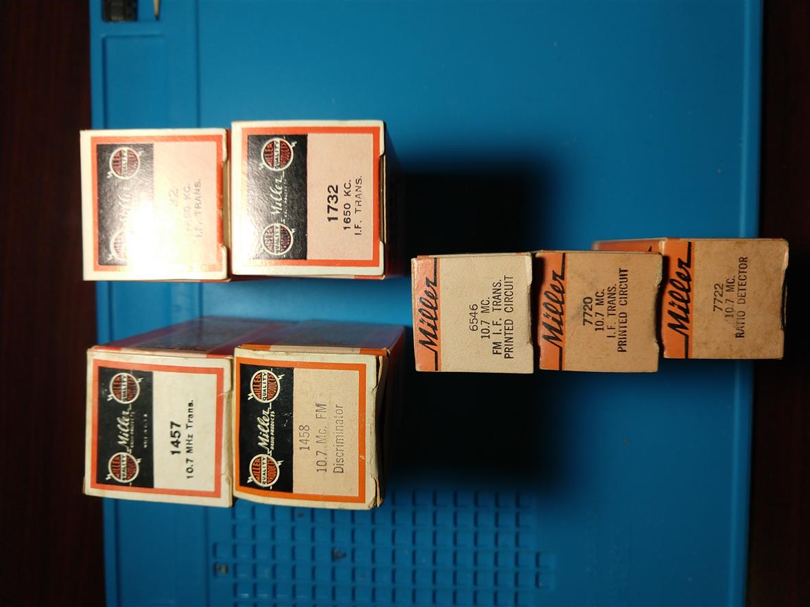

Not as many 10.7 MHz as I thought, unfortunately.
I pulled all the transistor parts, there are some of those, also.
I only have a dollar each in them, so it's like dollar daze for transformers ...

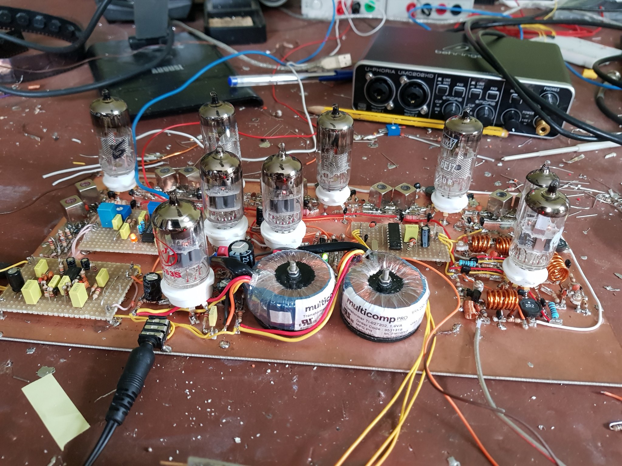

Hi Paba,
both kits you've suggested apear to be the same.
It's hard to believe that proper alignment is manageable without suitable equipment (sweep signal generator, o'scope). Look at those lose ferrite IF filter cores. Hence I'd fear great disappointment on the outcome.

Many thanks for the suggestions! Looks very interesting. I'd like to give it a try.

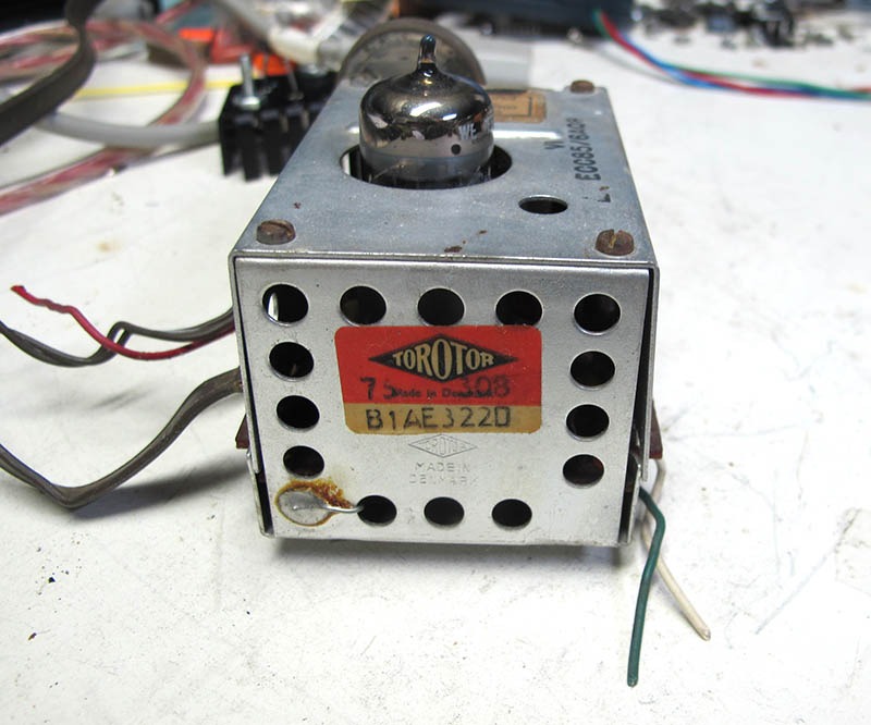

I do have a thought - perhaps you can locate some of the old Danish (?) tube based Torotor FM tuner modules and restore them - making them the basis of your project. These were commonly used in Eico tuners, and I suspect several 60s era European manufacturers used them as well. They inlcluded various IF strips and front ends and were pcb based.
Guess what I found:
Guess what I found:
With such a tuner I built my 1st FM radio. With two IF stages, last one limiter, dual diode for demodulation and a magic eye. No equipment available to measure sensitivity or AM rejection. The sound was great, 20 Hz to 20k as transmitters were mono. Experimenting, I soon discovered that 3 IF stages couldn't be useful AND stable on the relatively small chassis. That was the start to dual conversion and results were better, especially suppression of impulse noise interference (no spark "taming" back then).
