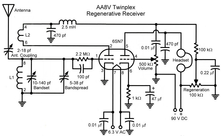

Here is my favourite, he explains each part of the circuit and how to build it.
The AA8V Twinplex Regenerative Receiver - Schematic Diagrams and Circuit
Descriptions

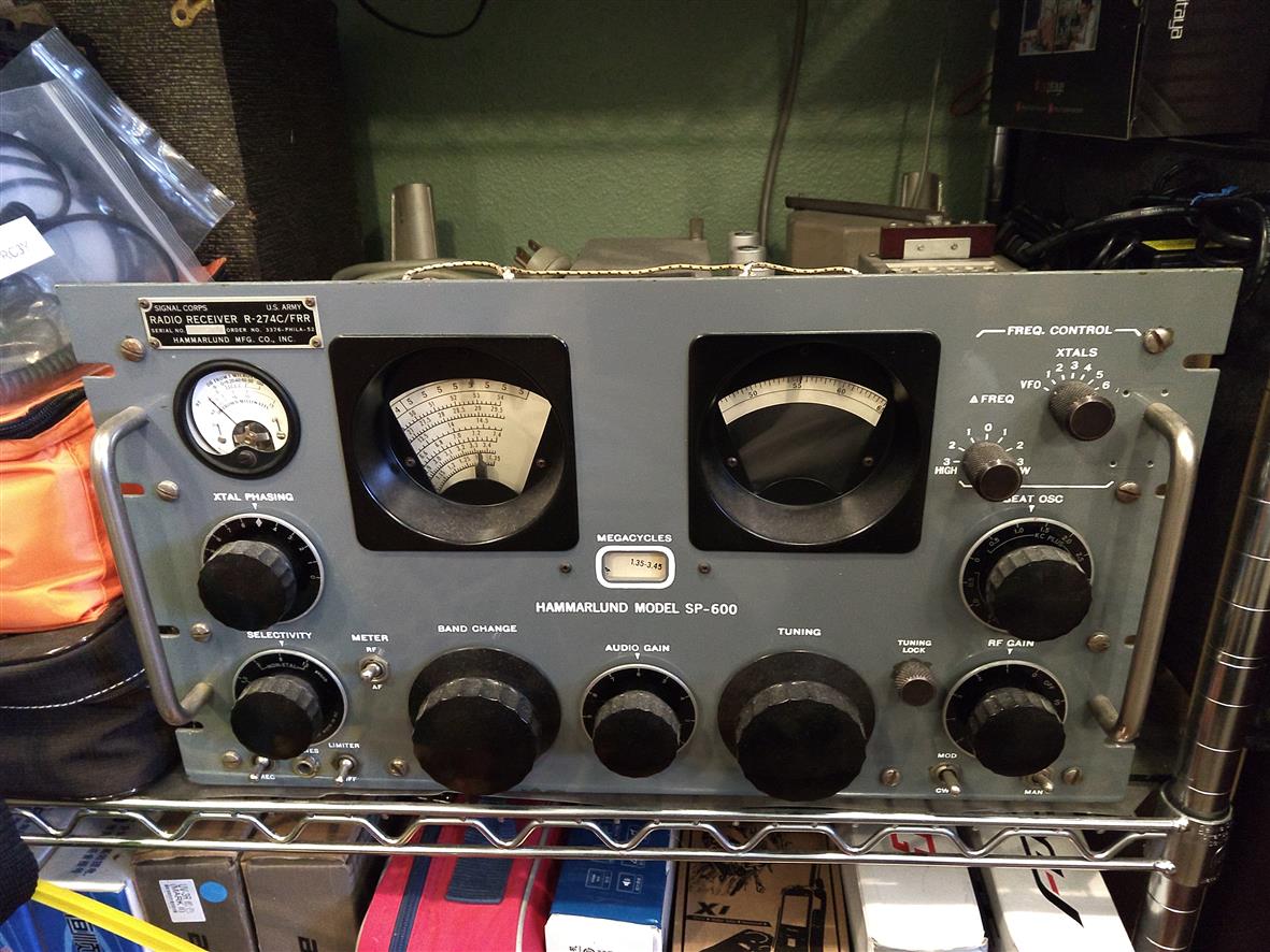

6A3Summer, did you have any of these R-274/C ( SP-600 ) on the ship? It has a ganged tuning capacitor that runs almost the depth of the radio, making it much more of a band cruiser than the R-390 or R-390A. I got this guy to replace my R-390A, rebuilt it, and ran it eight to ten hours a day at my office before I downsized to a smaller building.

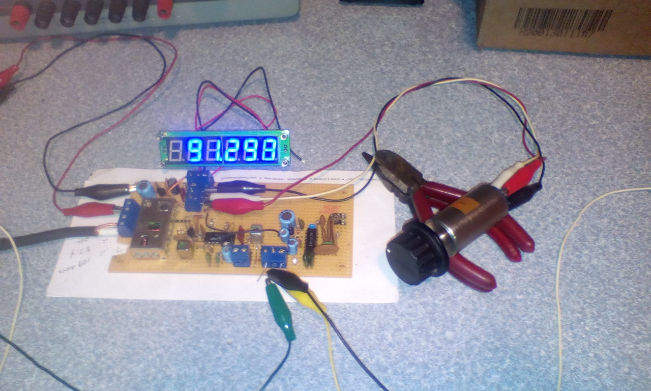

Years ago I thought about designing a vacuum tube transceiver for ham radio use. After some serious tinkering and testing I decided that it wasn't worth the effort. I used silicon instead. In my case it was free for filling out a sample request form.
I don't know anything about the R1050, but if is a somewhat dated design there is probably another reason for the input tube, intermodulation rejection performance. At the time I was looking into making my radio, a good old 5670 or 6386 tube in a balanced RF amp configuration was better able to eat a bunch of strong signals at once without blending them all together to mask the weak ones than the best transistors. That is no longer true.
Inadvertent transmitters ARE easy. Several of my vacuum tube audio amps have done the job quite well!
I was an RF engineer at Motorola for 41 years in my corporate life. I have done both transmitter and receiver design, and both present some serious design challenges, especially in todays super crowded RF environments.
Radios REQUIRE resonant tuned circuits for selecting which of the thousands of signals present at its antenna you want to hear. A resonant tuned circuit is made from a capacitor and an inductor. For continuous tuning, ONE of them MUST be variable. Variable capacitors are easier to make (or buy) than variable inductors, but you do not want them. There are solid state devices (varactor diodes) that do a fair job of emulating a variable capacitor, but they are off the list as well.
Yes, it is possible to use the variable space charge capacitance in a tube for tuning over a very narrow frequency range. AFC and FM modulation have been done via a "reactance tube." This can work up to maybe a 1% change in frequency. We need 300% for AM radio, and 20% for FM radio. Not good enough.
This leaves variable inductors. tuning can be accomplished by moving a ferrite slug into an inductor ( common in many car and military radios) or creating a variable inductor with a roller (common in transmitters). Mallory even created a spiral inductor on a PC board with a rotating wiper for tuning. It was called the Inductuner and used in Boonton RF signal generators in the 1970's. Older versions were used in many low powered application dating to the 1940's. At any rate you must find, or make some sort of variable tuning system.
It has been stated that FM can be received by "slope detection." This is technically true, but will not work on any FM station that transmits "HD radio." HD radio runs a second transmitter on exactly the same frequency as the primary transmitter, but employs a modified AM transmission scheme. This will keep the AM detector occupied such that it never sees the FM signal.
Typical FM demodulation is done by a ratio detector, a Foster Seely discriminator, a pulse counter, or a phase locked loop. The last two do not easily lend themselves to vacuum tube implementation.
Both the ratio detector and discriminator are common in vacuum tube designs, but use tuned circuits which are done at a fixed frequency. This means a superhetrodyne design is the path of choice. The most common Intermediate Frequency for AM radio is 455KHz, and FM is usually 10.7 MHz.
You will need to build, and tune inductors, and transformers for these frequencies, or procure a set from an old radio. As mentioned ceramic filters for these frequencies are available, and technically not a semiconductor. This is the path that I would choose, and was going to use in my radio design many years ago. Impedance matching can be done with hand wound toroidal transformers.
As mentioned, attempting to make all the tuned circuits, get them tuned, and be able to align all of the RF circuits is not a trivial task, even with the proper equipment and knowledge.
Many of the old time ham radio operators DID make their own stuff, and get it all to work with minimal equipment. I did a lot of this as a kid long before I knew what Motorola was.
The trick I, and others used was to start with a working tube radio (an old Hallicrafters shortwave radio in my case), do my best to copy ONE STAGE at a time, wire it into the Hallicrafters (usually by pulling the tube for that stage) and get it working. Repeat until I had working copies of every part in that radio, then put it all together and play with it until it worked.
WARNING.....many tube radios have the line voltage DIRECTLY wired into their circuits. Attempting to connect ANYTHING into one of these can be DEADLY. Verify that this is not the case before proceeding. Do not go down this path unless you have an isolation transformer and fully understand why this is a problem before you stick anything into an unknown radio.
Note. Now that I am no longer employed by Motorola, I am no longer forbidden from designing and making radio equipment. Another much better ham radio device is in the works. Tubelab = KB4LRE I kept the old novice call since LRE was one of my hangouts as a kid

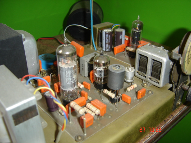

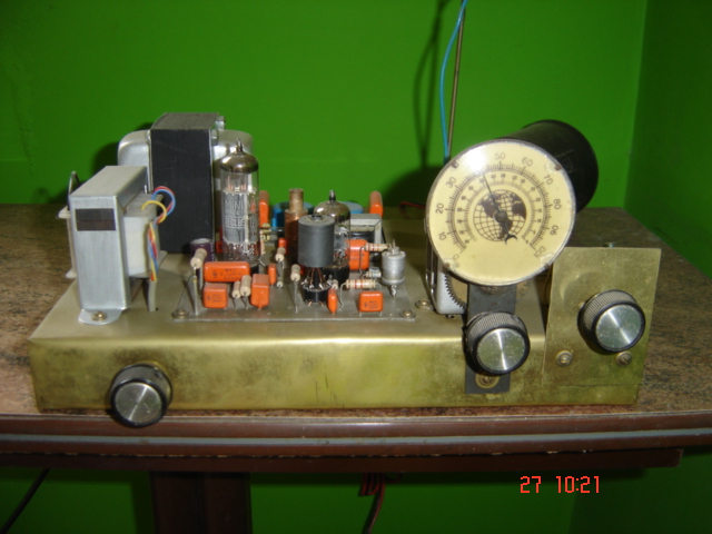

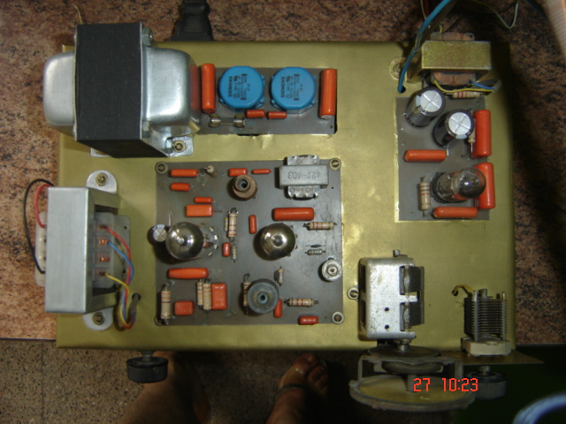

I think I tried to make an FM multiplex adapter in high school. Got the tubes to light up, but that was it... It was from http://www.tubebooks.org/tubedata/RC30.pdf which is an RCA Tube manual. Lots of challenging circuits in the back of that book. AM/FM radio, FM tuner...Color TV. I wonder if anyone ever made that successfully from scratch!?
Very interesting, Osvaldo!Regenerative receivers have better audio quality because of less stages distorting the signal. I have a couple of them.
I recognize a EZ81 rectifier tube in the HV PSU and a ECL85 as the AF amplifier. But what's the 3rd tube, and what does it do? According to the dual rotary cap, is this a regenerative with two resonant circuits?
Best regards!
Admittedly I'm not too sure, as the perceptible difference between both is their heights, and there's no reference in the pic to compare with.
Best regards!
Best regards!

Yes. The third valve is a ECF801. The pentode "Amplifies" a little the signal incoming through the ferrite rod, and separates it from the regenerative stage, the triode inside it. Initially, I regenerated in the ferrite coil itself, but result in a very unstable mechanically. This solution performs very well for local broadcasting stations and some distant low power ones.
The rectifier is a 6X4. Neither EZ80 nor 81.
I have the schematic in ASCII art if you want it.

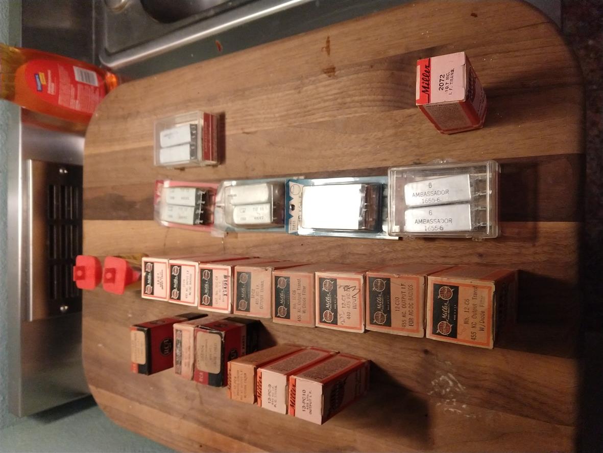

There is a little hamfest around here that frequently has NOS IF coils. The pic is the contents of just one sack I still had here at the office. I have more sacks ... I hate to see stuff like this head to a landfill ...
These are all 455 KHz, save one, but I know I have a bunch of 4.5 MHz, I feel sure I have some 10.7 MHz K - Trans including ratio transformers and maybe quad coils, and even 250-260 kc coils. I don't think I have any 21 or 44 MHz coils.
4.5 MHz was the "intercarrier" frequency for analog NTSC TV. They will work just fine for building an FM radio receiver with a 4.5 MHz IF, particularly if a complete set including the ratio detector or discriminator (quad coil) transformer can be found. The bandwidth for FM radio and TV audio are nearly the same.
252KHz, 255KHz, and 262KHz were common IF frequencies for AM radios in the early days. These are another valid option for AM. The lower frequency will tend to have a narrower bandwidth thus chopping off more of the high frequency information, but providing better adjacent channel rejection. That's why they were often used in car radios.
...and also for old b/w and PAL colour tv's here in Europe...4.5 MHz was the "intercarrier" frequency for analog NTSC TV. They will work just fine for building an FM radio receiver with a 4.5 MHz IF, particularly if a complete set including the ratio detector or discriminator (quad coil) transformer can be found. The bandwidth for FM radio and TV audio are nearly the same.
