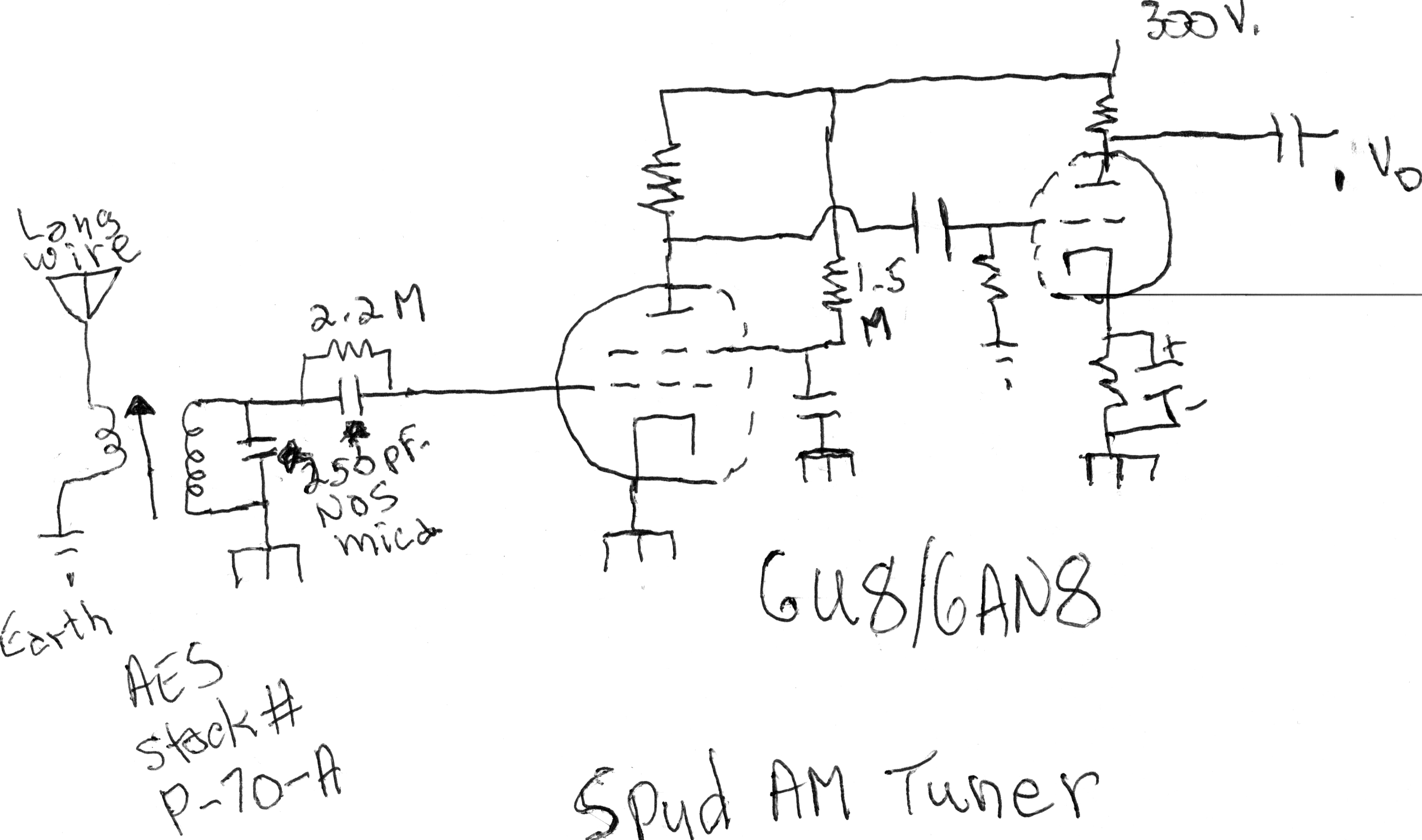

Dude,
Your wish list does NOT compute! Radio tuning is done by LC resonant circuits. Either you vary the C or you vary the L, to change the resonant frequency. Resistive control of the resonant freq. requires varicap diodes and that means SS.
You can tune a radio by moving 1 or more slugs inside the inductor(s). Some cheapy car stereos have brackets connected to the tuning knob that move 5 slugs: 3 for FM and 2 for AM.
Alignment of superheterodyne circuitry requires a highly sophisticated test bench. AF work is easy in comparison. FM alignment is truly difficult, as sweeps across the band are required. Do you have a signal generator with VHF capability?
Build a "spud" AM radio for starters. That's very easy and not particularly expensive. I've uploaded a crude schematic for a slug tuned "spud" AM tuner. Not all parts values have been specified, but critical info. has been provided.
The data sheet/wiring diagram for the coil may not be correct. The winding with many turns gets connected to the pentode, while the winding with few turns is in the antenna circuitry. It's a step up tuned trafo. You will have to glue a stick to the tuning slug, to give yourself a station adjustment.
BTW, earth here means exactly that. A cold water pipe will usually do.

Quite simply the most straightforward approach in any case will employ a tuning capacitor, possibly ganged tuning caps. 3 gangs are not uncommon. This is because some designs call for tuned circuits to track simultaneously as the knob is turned. You can obtain one of these from a hamfest, or simply raid an existing radio. It is obviously possible to use a varicap and a varying potential but this is a complication compared to a mechanically tuning cap. Inductor-tuned circuits are, in general, a PITA for amateur use.
