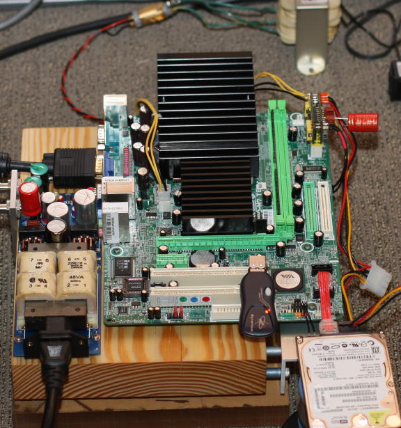

I can't resist - this one will really make you nuts
Yes. It is DIY. 😡
Yes it is short - 1/2 inch 😕
It uses silver wire god forbid
No it does not come from from walmart like those billions of proper USB cables, and
Yes this fool says it sounds even better than my 6" version.😉
The HORROR😱
Yes. It is DIY. 😡
The HORROR😱

Why be so silly, I and others have posted links to USB data, these guides are there to be followed. You have by your own admission no electronics background yet your playing with USB cables and totally ignoring the specifications, that is plain ignorance and is not the best way to learn electronics. The whole point of these specifications is so that USB and other interfaces work, but I suppose that's only for the 'engineering elite'
looking at your photo, I would recommend you look at some other 'engineering elite' documentation regarding SELV and other electrical safety issues.
For 1/2 inch connection you can use almost anything, as EM and transmission line theory says. A bad 1/2 inch cable is likely to sound better than a bad 6 inch cable. Thanks for mounting an experiment which confirms what we have been telling you, even though it might not be what you thought you were doing.
Looking at the photo, I would imagine it will all be rich in EMC noise, as computer motherboards and power supplies are not put in (to some extent) screened metal enclosures for nothing.
