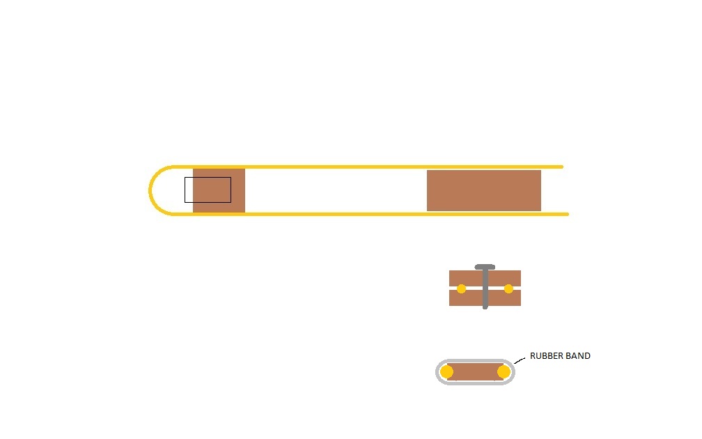

I thought of an easy way to make the arm length adjustable
its simply a brass rod, bent into two paralel
thicker material for gass welding might do it
if the mounting point of your armbase doesn't fit the angle, you can instead adjust with angle pickup headshell
somewhere in the middle of music grooves the needle/headshell should be perfectly angled in relation to groove
its the only point where you have near perfect tracking
in all other positions you have tracking error
its about finding best compromise
antiskating is another issue
some like to deal with it
other don't
depends
it can be tricky to make a good antiskating device
many have negative 'side effects' on arm function
hmm.. you call that length adjustable... i call that a reminder that i played trombone in gradeschool... so im assuming your idea of length adjustable was inspired by a trombone?... it would work... you could make a single tube length adjustable just by making it telescoping... if you cut a piece out of one side of the end piece, fixed a screw on the piece attached to the base, the presence of the screw would prevent the forward piece from twisting in relation to it... and you could just tighten the screw to lock it in place
trombone idea works too, but surely you would need some way of holding it at a desired length so the act of tracking doesnt pull it out...
or did you want it to be able to pulled out so that the tracking can dictate the length needed to remain parallel to the groove? in which case you would get fluctuations in pitch due to it...
now what if you had a headshell that could pivot as the arm tracked... maybe have some kind of a pulley mounted to the base of the table and the headshell... so as the arm moves, the headshell would be automatically turned to counter that, resulting in a static angle relative to the groove being played, and atleast reduce much of the tracking error

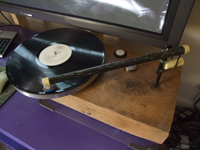

I thought I should share pics of the turntable I built just to show how simply it can be done. I started with a pioneer belt drive TT I bought off of some guy from craigslist. I just screwed/bolted/glued the relevant parts to a big chunk of oak. I did it in my kitchen. Antiskate/tracking/downforce I'm sure were all horrible. But not having any resonances from a cheap turntable body and tonearm produced really great sound.
