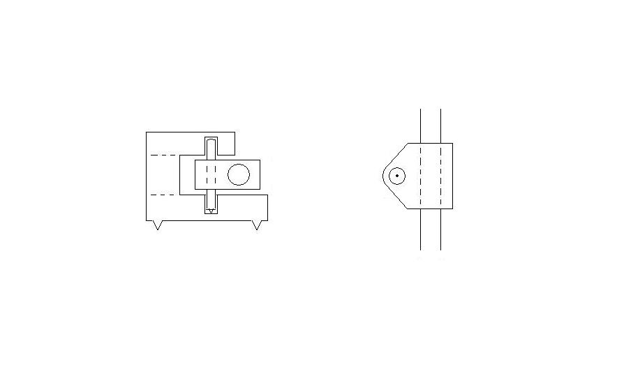

basic principle of unipivot
personally I think full adjustability in all directions is essential
the uni pivot bearing point itself is the easy part
that's the beauty of the principle
note that there is room for thick grease to dampen
thats the Hadcock trick
please note that I have not seen any of the new Hadcock versions

the three ball solution...
small bearing assemblies such as these have been used forever (or so it seems) in audio. I have a bunch of old tonearms in pieces that use three or four capative balls in a metal carrier. If the "needle point" is not the correct angle it can bind.
As promised, here is my unipivot suggestion ...... I used 1/8" balls because they are easier to find ....The balls could be carbide or some semi-precious stone ....

that last photo tinitus posted.. thats EXACTLY the impression i had that the unipivot bearing had to be, the pin had to be a sharper point than the pocket itself to allow the arm to tilt up and down for moving it into place, and playing warped records

just so that you know, ball bearings are the worst
bushings are way better
though, ball bearings may be convenient if there is any end play to deal with
but if its possible to use bushings, its way better
its all them moving parts
a uni pivot point 'bearing' is almost like no bearing at all
but both pivot point and cup needs to a very precise match ;)
or else you will get 'play' movement

I don't believe that existing unipivot tone arms actually use a pin in a hole with a sharp point.
While it is easy to machine a pin with a sharp point, it is not easy to machine a hole with a sharp point at the bottom. All tools wear the first time they are used. that means, by the time you drill the tenth tone arm, you don't have a sharp point anymore.
I think that manufacturers drill the hole as sharp as they can and then machine a small radius on the mating pin so that the pin will always ride on the tapered part of the hole and never in its point.
I've attached two drawings scale 10:1 and 20:1 to illustrate my point. (no pun intended)

those PDFs look a tad backwards, in those you have the hole being perfectly sharp but the pin not being perfectly sharp.. surely its easier to sharpen the pin.. however, with weight riding on it i doubt itll stay sharp for long which leads me to believe 3 bearing balls and a pin would probably be the best idea.. but will the arm move smoothly?

... which leads me to believe 3 bearing balls and a pin would probably be the best idea.. but will the arm move smoothly?
now that think about it, I think the hadcock actually did use a small ball bearing
btw, maybe you could use a wolfram tig welding electrode for the pin
I would use a sharp punch to make the counterpart cup
if it wears out ? hey, its DIY ;)
i think a bolt would be easiest tinitus.. i mean, i can put a bolt into my drill press chuck and sharpen it with some steel files i have... then thread it into a threaded bushing glued into the table for height adjustment
on the tonearm i think ill just drill out a hole, glue in a small piece of steel tubing to sleeve the hole i drilled, maybe glue a magnet into the pocket, and place the 3 bearing balls in and be done with it forever

First off regarding the uni-pivot. In general the pin would be a socket that received a gem stone ground to an appropriate point. There is also the option of using a material like carbide or tungsten for the point both of which are very hard. The socket will be the ware site. There are a number of ways to fabricate it. The best is again going to be a dimple in a gem that is bonded or captured in a cup. The second would be to again use carbide, tungsten, or another hard metal and EDM it to finish. Most any material that would be suitable to the job and have long term life will be unmachinable due to hardness.
