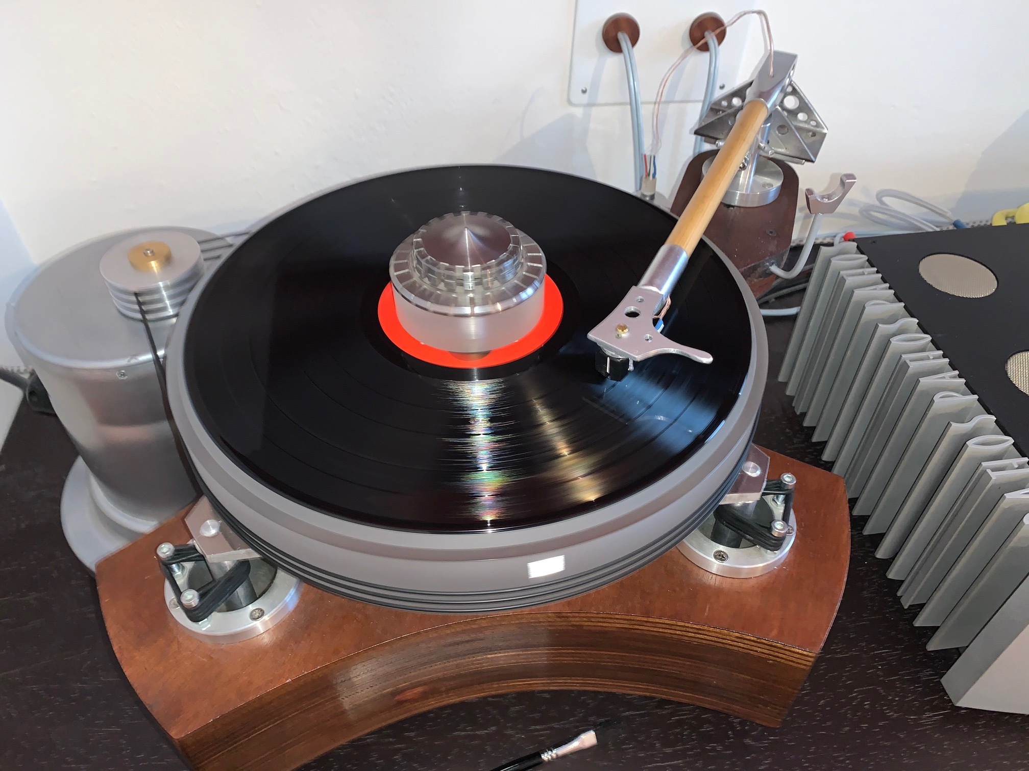

I made my own TT about 15 years ago.
Bearing was lathe under my spec by an ex colleague at that time. Shaft is 13mm with spere 5mm and the sleeve are lathe from a solid single piece of bronze. This year I have replaced the thrust plate while the bushes are in great shape and allowance still. Oil bath of course.
Platter 4.5 Kg in Acrylic purchased from Scheu Analogue at that time.
Floating system with 3 mags lev of my design.
Bearing support made from a special aluminium plate sound proof treated.
Plint made from wood birch , two type and leads insert in each layer of the wood.
Motor using a 5.5 inch floppy motor and a PC feeder separated from the plinth.
3 belts drive, single pulley.
I try to make a double motor 3 belt drive with fly wheel ala VPI, but I failed as the mechanical precision of the fly wheel was nt up to the task. The stability anyhow was great. This project is on a stand by position.
Tonearm. I first bought a Rega RB 250, made some tweaking to the stub and offset weight, ground wire. I do not currently use it and is boxed.
Second I bought a new telco 750 L 12 inch, used for a while and replaced, now is boxed.
I made my own unipivot wood 12 inch tonearm with high mass for Denon DL 103. I still use it.
I also attempt to make a clone of the Schroeder Ref 1 TA with bamboo arm wand. I have used recently and I was pleased of its sound , so I make the micro VTA weight adjustment, fitted an arm lift and going to change the inner wire with better one. Soon I will fit again on the TT.
Price wise the TT was not that cheap as I paid about 400 Euro only for the acrylic platter, several parts needed to be made by a lathe guy and not for free.
If you can manage to make your own TA may pretty well worth it because to buy a TT on the same sounding level you would spend few thousand euros, lets say around 4000 to 5000 Euro.
Look? I think mine is not too bad considering the original mag floating system.
Attached a pic with the previous Fly wheel and 2 motors drive unit.
Rgds
Adelmo

The bearing is a standard one, the bearing support is floating by Mags.
I do not like much the mag bearings.
The 3 mags are in the 3 plinth feet and they isolate well from the floor back noise the bearing and platter. If I knock on the plinth while playing no effect at all on the sound.
Rgds
Adelmo

Hi,This is an amazing TT. Feel free to post more info. Very interested in how you put it together. And please post more pics.
Some time ago I posted some pictures here on page 7 of the pictured project. At the present I am using single motor with 3 belts and a clone of the Supatrac TA.

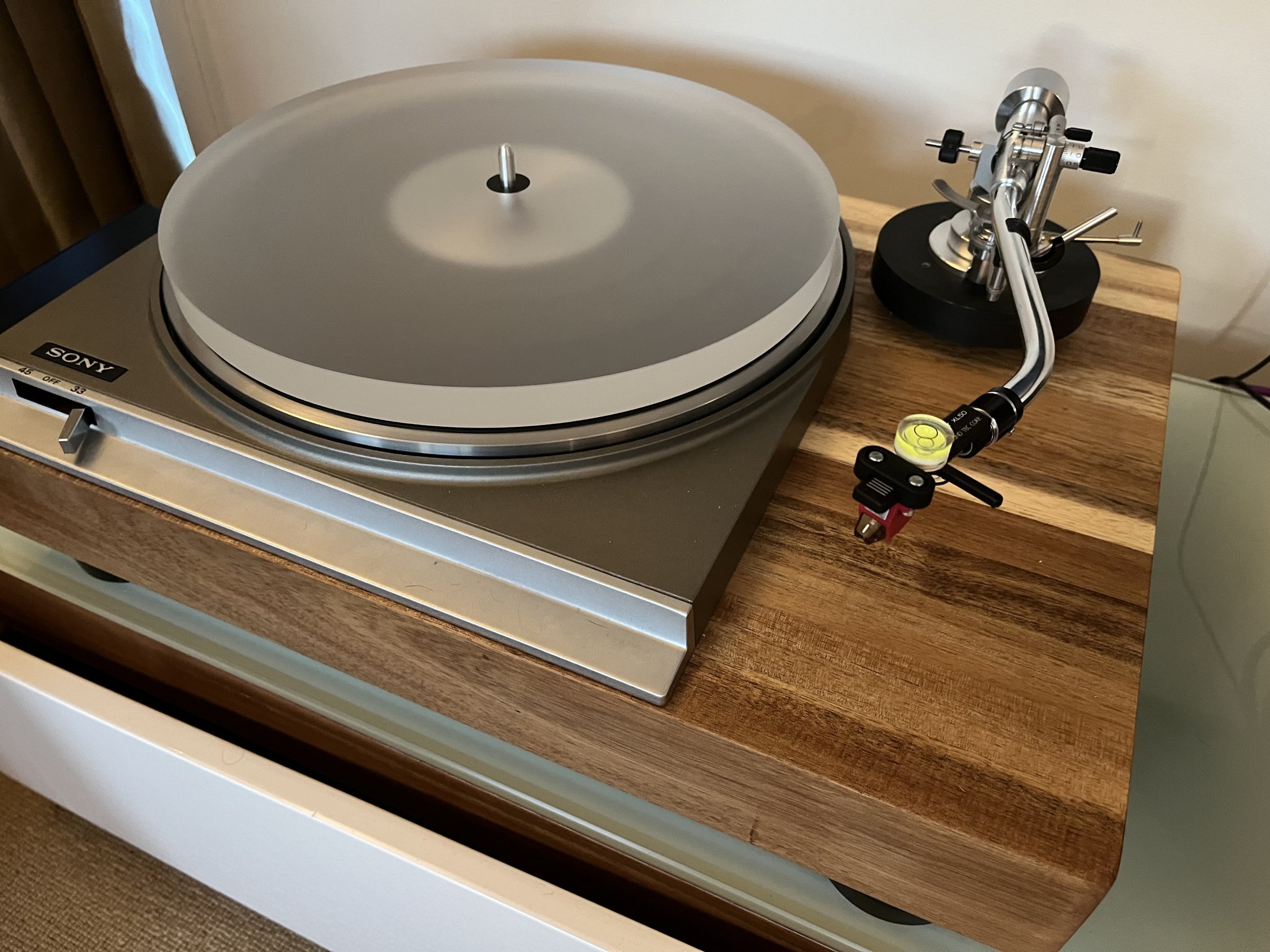

Here's my DIY build. Sony belt-drive TT bearing and platter, mounted on a chopping board, converted to DD using a Technics coreless motor (still using Sony bearing tho). Pro-ject acrylic platter used as a "mat". Only needed a battery drill and router to build it.
Cheers, Mike

Hi Mikey,
Nice!
I also want to use for my new TT project the Project Acrylic platter as thick mat and also because I like Acrylic as well. Can you pls tell me which Project acrylic platter did u use and how you stacked in the Sony platter.
I was planning to use a 20mm thick platter Acrylic IT E but I do not know how to interface it with the original Lenco L 75 aluminum platter.
Thank you in advance if you can help me, best regards
Adelmo
