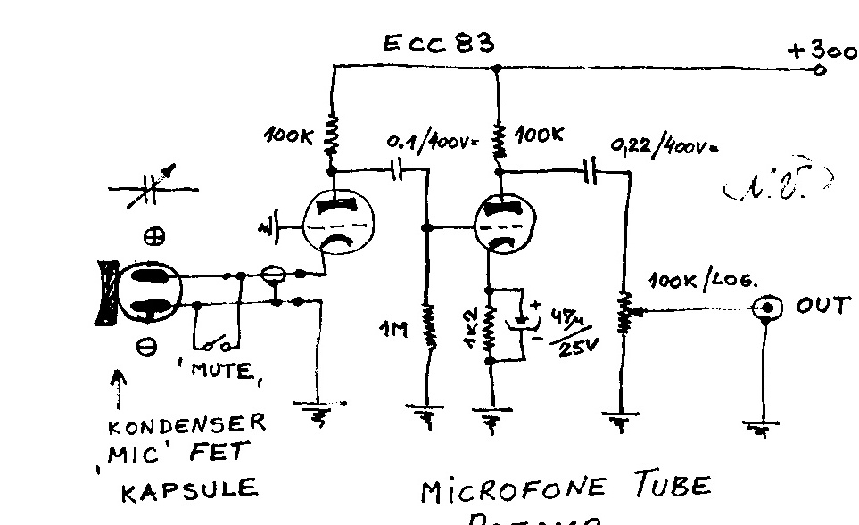

One more thing on the tube... I assume that if I change the delivered one with the mentioned Telefunken 12AU7 that the socket will fit and I dont need to revire any cables, or are there diferences within the tubes?
Well guys im realy a nood, can anyone please tell me if i can do so?
The kit states it comes with a 12AX7. The 12AU7 will need to be biased differently to work.
Physically it will fit, but you will need to change some components to different value ones on the circuit board, and the 12AU7 will provide less gain.
You can swap a 12au7 for a 12ax7 and likely it will still work to a degree but if the goal is to improve the sound you'd need to swap out a few resisters. The AX and AU are different tubes wit the same pin outs The AX is a high gain tube the AU is a high current tube.
There are others in the series too, like the 12AT7 that fall between the AX and AU
Ok since I able to solder it but nor realy able to decide what resistors to change to what value, what if I would just swap the manufacturer stay with the 12AX7 but instead of a chinies tube I would buy a russian, would that work or still I would need to change some resistors?
The brand of tube here is not as important as the type. Going to a 12AU7 just to get a Telefunken tube in there is not likely to be the best approach to improve this mic.
Any 12AX7 should work the same in the circuit without changes. A 12AX7 should bias to about 0.5 mA plate current. You may need to try more than one tube regardless of which brand due to minute gas in some samples. Look for about 40-60V drop across the 100K plate resistor. (A 12AU7 will bias up to 1.2mA or so and would likely not work as well).
For myself I would use a 12AY7/6072 AND drop the B+ of the mic down from the stock 200V to 120V. I don't know why they go to 200V on these; it places 100V on the capsule where 60V is standard for most LD capsules (inclusing the Peluso etc.).
