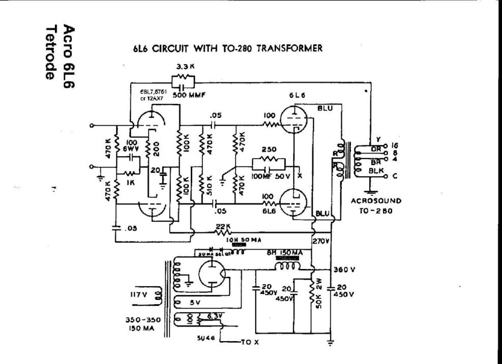

Interesting high gain 2 triode driver
This is the first I've seen of this interesting 2 triode configuration that uses positive feedback or bootstrapping to dramatically raise the gain of the first stage:
http://www.angelfire.com/electronic/funwithtubes/Rst_Harman-Kardon_A-300.html
Note the author's measurements of an increase in voltage gain from 55 to 515 for the first stage:
"A very interesting point is the phase splitter and the tube just before it. The cathode of the half of a 12AX7 goes to the same voltage divider as the cathode of half of the 12AU7. If you connect the cathodes of two triodes together and couple the plate of the first to the grid of the second you have a schmit trigger. The cathode is tapped way down so the result is positive feedback but not with enough loop gain to sustain oscillation. I breadboarded this much of the circuit and made some measurements. The gain measured out as a whopping 515. At the necessary voltage output to drive the 6V6s the distortion was 0.90% from the cathode of the 12AU7 and 0.92% from the plate.

Interesting thread and intersting amp. My guess is that the 6sl7 is either a long tail pair phase inverter with one grid grounded to make it a "self-split" type arrangement, or it is a conventional gain stage followed by a cathodyne phase inverter. Either way you only get gain of a single 6sl7 stage, which I think is about mu = 60.
I would recommend lifting the feedbackas you have done, and perhaps bypassing any tone controls there might be.
My choice for more gain witout adding tubes is rewiring the halves of the 6sl7 as 2 gain stages, and then wiring the output pair of 6l6s in the self-split configuration above. The 6sl7 has a high-ish plate resistance which is not very good for driving an output stage like this, but they can still sound very good.

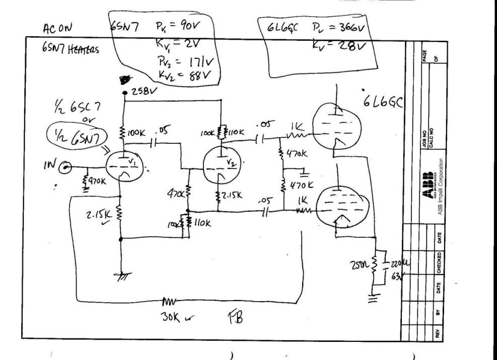

Wow, almost 3 years later and I am now jut getting back to this amp. Since playing around with this tube amp, I have gone on to make a few Tripaths, UCD, a Krell clone, and a few preamps (12B4, AN M7, and an Aikido that's not quite finished)
Anyway, I have "found" a couple pairs of RCA and GE 6SN7 driver tubes that came with this tube amp - I had thought that the drivers were 6SL7 because that's what was in the amp. I really don't know what really "belongs" in this amp. I have taken some critical voltages (Plate, cathode of both the 6SN7 and one of the the 6L6 output tubes.
6L6GC
Plate 366V
Cathode 28V
6SN7
Plate 1 90V
Cathode 1 2V
Plate 2 171V
Cathode 2 88V
Anyway, I have just drafted the input section (with the FB) leaving a bit of the 6L6 and PS circuit out.
The amp sounds very nice with either the 6SL7 or the 6SN7. I expected to hear quite a difference due to the gain differences of the two.
Anyway, can anyone comment on the input section? Which is correct driver and what can I do to improve the design (without adding another tube)? Anyone familiar with this topology? It reminds me of the Magnavox Mag-1515 (with different input and output tubes) here:

If you begin at the start of this thread you will see that I have had quite a few comments and advice on the initial gain problem of this amp with the 6SL7. Just isn't very loud, but once I put a nice pre that had a little gain in front, all was fine.
A few pics posted here:
DIY Tube Amp
There really was not a lot of advice from the beginning of this thread on a 6SL7 driving a Pair of 6L6, but I have seen the AN P2SE amp is....
I apologize for all the crazy questions, but I am just a bit excited to be finally getting back to this amp!!

There are 4 things about this amp that make me want to gut it and rebuild the circuit from scratch using the existing parst. 1) global negative feedback, 2) cahodyne phase inverter, 3) grounding to the chassis, 4) general rat's nest wiring. Ok the wiring isn't so bad, and the feedback could be simply clipped, but still.
If you are willing to gut it, I am working on an idea for the circuit for your consideration and to maybe spark some ideas.
