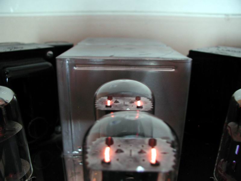

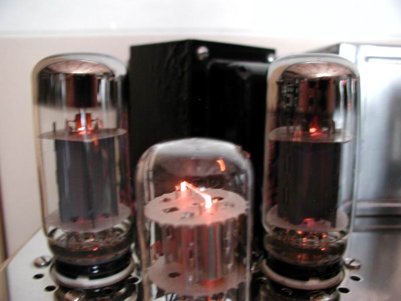

Those driver tube look WAY too hot to me. 6SL7s should not have glowing plates and I think that's what I'm seeing. Fix that before giving back the amp. You may like it.

Yeah, on post #65. Those plates are way too hot! Measure the voltages on the outputs for chuckles but you need the see what's between cathode and grid on the 6SL7's. The grid needs to be more negative than the cathode. Also check the plate voltage for the 6SL7's.

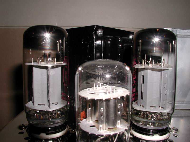

The pictures make the tubes look a lot more brighter than they really are...I had the flash off and dropped the camera sensitivity so the glow looks brighter than it really is.
I can say that the rectifier tubes feel quite hot - I can hold my hand over the tube and feel the radiant heat. The power tubes feel quite cool, and the driver somewhere in between.
