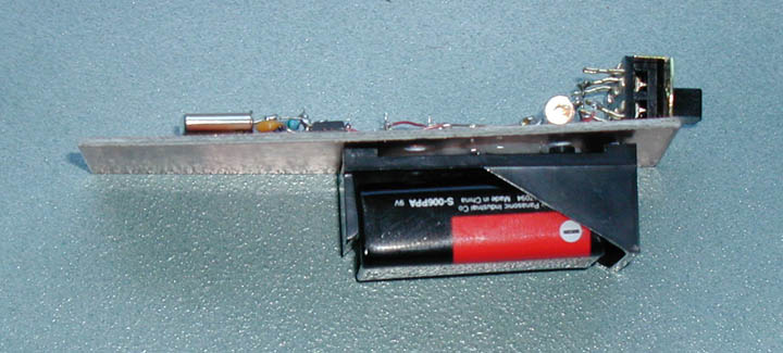

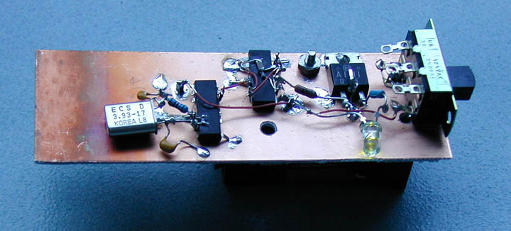

For those of you clamoring for more photos of my little strobe, here it is in "final" form with switch added and battery mounted on the back.
---Gary

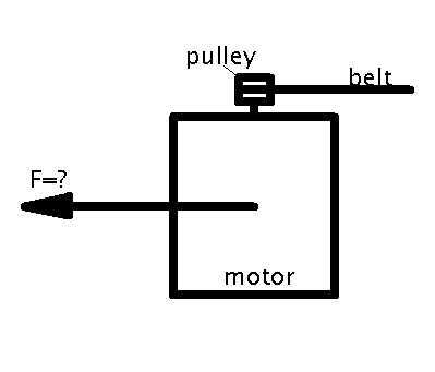

Bernhard,
As I am eagerly awaiting the Maxon motors I built a kind of cart to put it in. To finish it I need to know:
1. I understand the diameter is 28mm but what is its height?
2. You wrote somewhere that you have to be careful how much sideload the motor gets. Can you tell me what the maximum safe force might be?
thank you
SIDELOAD
Hi Peterr,
2.In this respect i have to remind all of you intending to use a maxon that maxon specifies a maximum radial static load
of 5.5 Newton (at lever arm length 5mm, measured from the flange). Therefore i do not recommend belts with 1/2" / 12.7mm width.

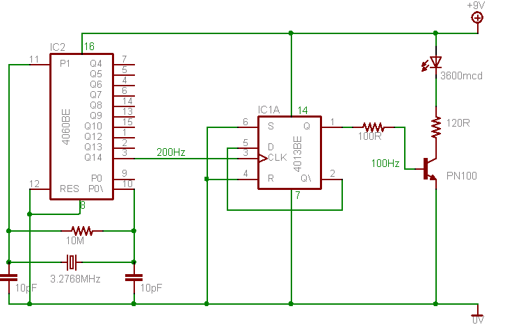

I am trying to make a strobe as per Bernhard's circuit, however I think perhaps it is not oscillating. The LED illuminates, but I see no 'freezing' on my strobe pattern (can see dimly under room light). I am using a 3.2768MHz crystal to get 100Hz output, and a HCF4060BE divider. As I do not have oscilloscope, is there any way I can tell if the 4060 is oscillating?.
Some modifications and the circuit is now working fine. Final layout is as below. LED is a 3600mcd red, and gives a strong high contrast bar pattern with minimal fuzz. Circuit seems to work fine without using the second half of the flip-flop, so I'd be interested to hear any feedback on merits / demerits of this.
