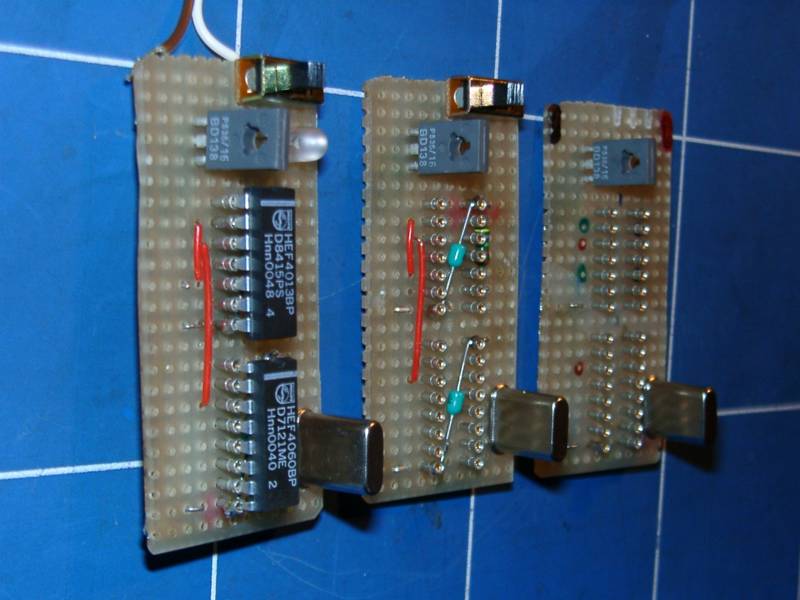

Left view of the same ...

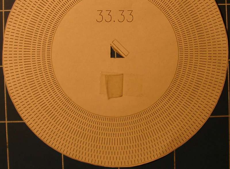

The used strobe disc has nine strobe patterns. The center one, wider than the others, is exactly speed, 0% off, the other patterns provide approximately +/- 4-5%, depending on speed.
And this is how the strobe flasher and strobe disc look like on operation.
Photo taken during the night with several seconds of shutter time. Nevertheless the bar pattern of the wide ring is sharp and stable (even more in real life) The slight blurriness comes from my shaky hand holding the flasher and from printer-generated lack o centricity/run.

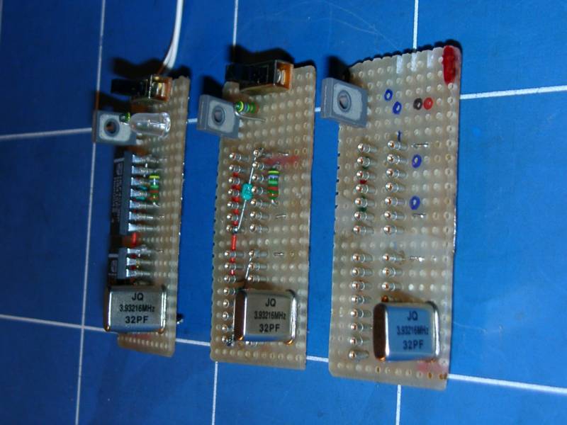

All,
from the pixes you should be able to get this lil'circuit running fine; i built 4 units already, to look if design is rugged and can be copied. All 4 run fine.
I have used an expensive 11cd green LED; the strobscope still works if the place is flooded with elerctric light.
Should there be a problem to get the 3.93216 MHz crystal or the ultrabriught LED, i can provide them at cost. Should any of you feel uncomfartable with building this circuit, he maybe can talk me into building one but this service will not be for free.
Write me an email with any QQ. Or post them here.

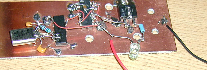

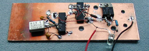

Bernhard,
I slapped one of these little strobes together and it works fine. I guess my LEDs aren't as bright as yours, so I found the short pulse width to give marginal brightness. Changing the 5nf cap to a 0.1uf cap gave a longer pulse and brightened things up nicely.
I've attached a few pictures showing the construction and the end result on my turntable.
My construction is much cruder than yours. I just flipped the chips over "bug style" and soldered parts directly using a copper clad board as the ground reference. I used mainly SMD parts to keep things relatively neat. I substituted a 2SA1111 transistor for yours since I had that handy and as I mentioned, I changed the 5nf cap to 0.1uf. The holes you see will be used to mount a battery holder on the other side of the board. I haven't decided upon the final case, if any.
Thanks again for the neat little project.
---Gary
Gary,
good work! See you get your hands on one of those bright LEDs, of you do not find them, i may have one for you when we soon meet.
The short duty cycle is vital not for precision but for the good contrast. I compared my thingie to the one Thomas Scheu sells. Vastly better as Scheu's one has 50% duty cycle... 🙂
Bernhard,
Thanks for the kind words.
I think you are definitely right about a brighter LED with a shorter duty cycle being a good idea.
In your original design the RC is about 0.2msec. Assuming it takes 3 RC to trigger things, then the LED should be on for 0.6msec. The pulse - pulse duration is 1/120 = 8.3msec. Thus the strobe is only on about 7% of the time. If anything, on the scope the pulse looks even shorter than this.
With the bigger capacitor you approach closer to a 50% duty ratio. On the scope it looks more like 30%-40%, but it definitely doesn't "freeze" time as well as a short pulse. I can definitely notice the strobe pattern wobbling due to an off center mounting hole on my strobe disk. I suspect I'd see less of this with the shorter pulses.
Still, the strobe works very well even with the longer pulses and I can adjust speed without difficulty.
---Gary
