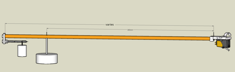

The sketch of the arm looks excellent! I plan on giving it a go once I find something worth putting it on. There have been some advancements in that area, and hopefully I can make it down to that shop next week (they have really short daily hours). I've also been working on my own sketches, one for my own version of the Altmann turntable, and one for a tonearm. I throw some sketches your way once I get past the ugly planning stages.

and is just a continuation of the Altmann design. Google sketchup is what I use for the "drawing", it's free, multi-platform and easy to use (but the learning curve is a little steep to start).

I've played with sketchup a bit, heres my humble first attempts. I've actually read through this thread multiple times, and I like what you've done with the counter weight in its newest form.

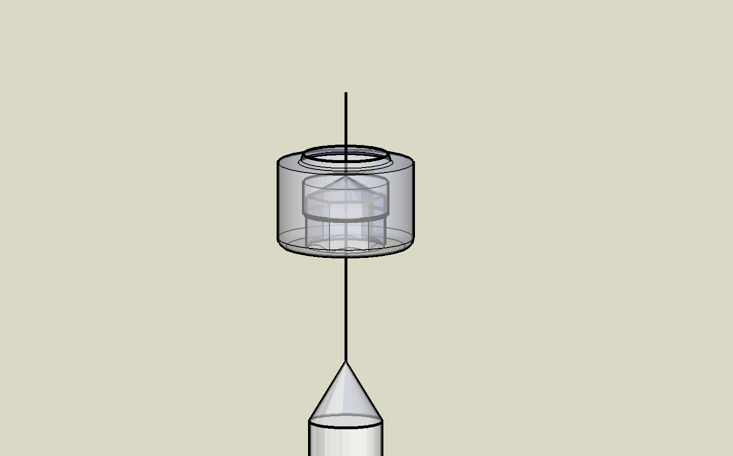

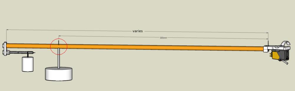

the encircled portion of the drawing is a ball point pen refill, and an Allen head cap screw or similar (trimmed up centre punched and glued into the arm tube), or pipe plug. Both pieces become the bearing for the arm pivot. The vertical line in the complete arm view is just there to ensure alignment of all the pieces in the sketchup.
