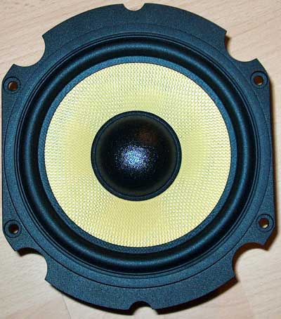

diy tl speakers with b&w cwm650
nice
Thank you very much! Please tell me how low this my driver can play music in alpha TL ? 50Hz -more or less? And is there any chanse for this driver to play nice in some other tipe of TL speakers. Building of boxes is not a problem .
Thank you. I realy want to make something like DALINE.
Re: nice
With an Fs of 74 you aren't going to get 50 hz out of it. Best to tune a bit higher. GM knows what he is doing... i'd go with his suggestion.
Given the way B&W designs things, i'd suggest they intended this for misrange use, and not as a midbass driver (i could be totally wrong)

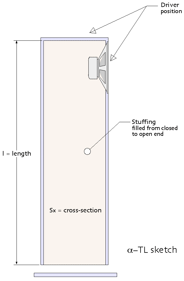

Same as in a large sealed cab, though of course it's excursion will limit how loud it plays before audible distortion begins.
A T/S max flat ML-TL will have much more gain to a lower Fb (aneochoically flat to ~40 Hz) than any TL, but below Fb it rolls off at 24 dB/octave, so if you have source material that goes lower you'll have to use some form of EQ to protect the driver if it doesn't have much Xmax.
One more time, high Q drivers are not good candidates for Dalines. The large filter chamber required when combined with the correct size/taper/length TL vent will result in a very underdamped alignment tuned way too low. Once stuffed enough, you wind up with a ~IB response, so might as well just make a simple sealed cab of the same total Vb.
If you use a small, underdamped filter chamber to allow the use of the correct TL vent, then once it's stuffed enough to damp most of the ripple out of it, you wind up with a lower gain version of a Fs = Fp Alpha TL, only it will be larger, more labor intensive, costly.
The 104 Hz Alpha TL I suggested has more gain than either in the midbass, is smaller, and has a 30Hz efficiency only a couple of dB lower than the other two, so for me, the choice is a 'no-brainer'.
All based on MJK WS sims and published specs of course, so as always YMMV.

IB = Infinite Baffle (ie big sealed box)
Vb = volume of box
So = cross-section at the start of the line.
Sl = cross-section at the end of the line.
FYI - for your information

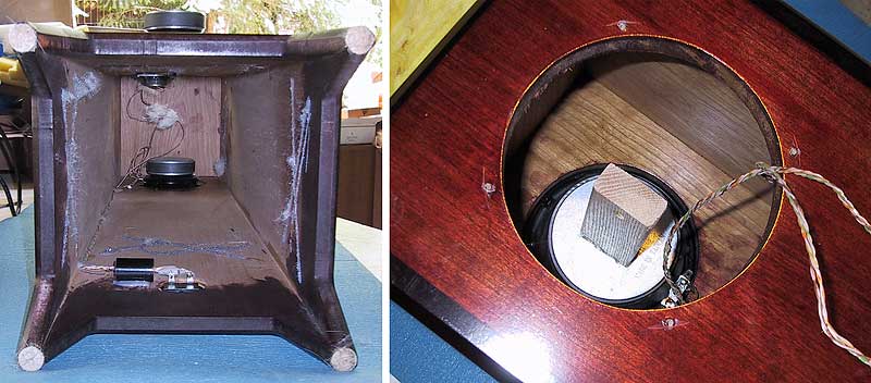

My boxes
I have TL speakers with jvc midbass drivers. And I put B&W in them. They sound very good, but have a less bass then JVC>This is plan for My speakers.

You didnt understend me! And I never said that you must answer me, becouse I am a doctor or anything else.The "tYpical doctor "was a joke! If you think that you spend too much your time answering me I am sorry. in our contry we use forums for frendly help and exchange informationes! We not expect any regard for it.I draw plan myself, I am asking you to redraw- not becouse I am a doctor and I am too lazy. NO, I am asking you becouse I am not sure that my opinion and understending is correct.At the end here is the plan. Is it OK? The measures are in centimeters.
