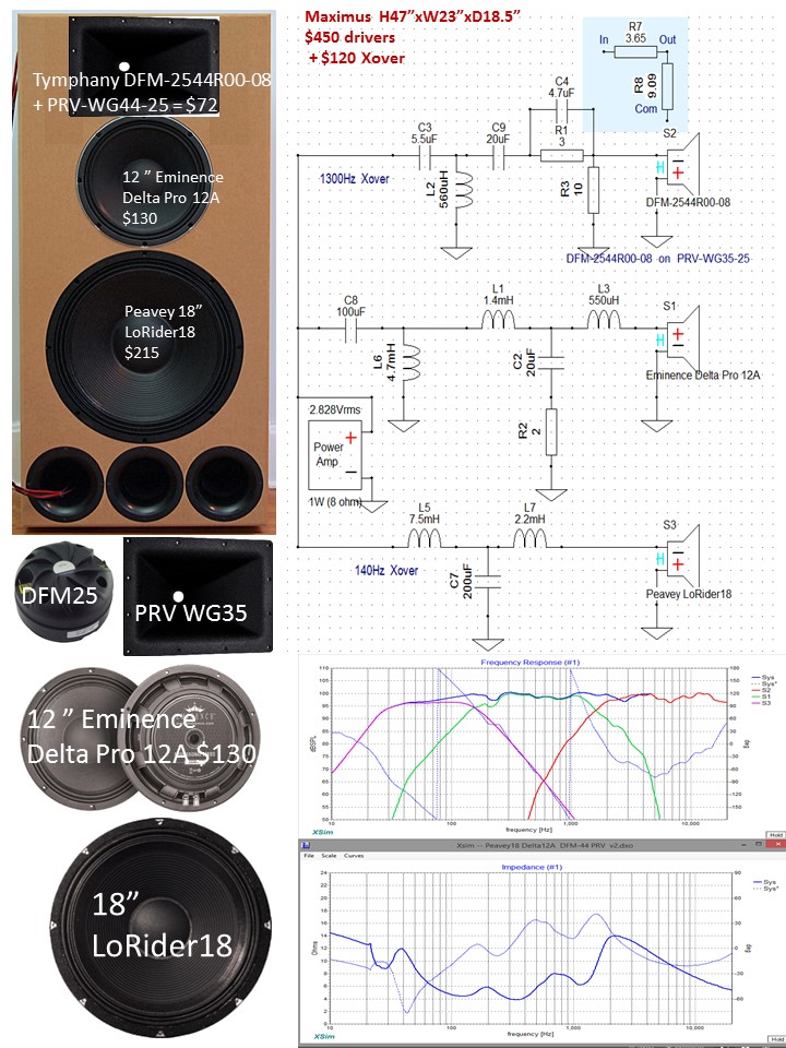

A proven EconoWave design with a 12" midbass and a 1" compression driver on a 90x40 dispersion horn, PLUS an 18" ported woofer is a frequently used high output speaker topology. $500 per speaker for drivers and crossover parts. BiAmping the woofer greatly simplifies design and supports higher output bass.
A Faital 18fh500 could be substitued in spite of the low rider. Not sure about overall volume though.
This.
This is essentially where I am headed. Always wanted JBL 4345, but that's a bit of a long term goal that may not get realized. I've got the 18" and a bunch of 1" drivers and waveguides.
