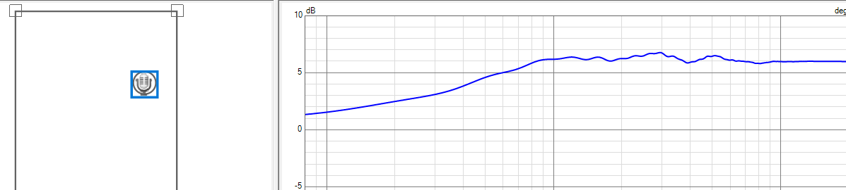

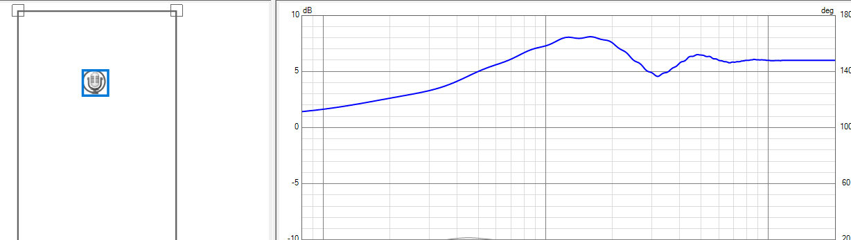

Or simply not flat
and any ground plane or mic phase issue would further influence the dip.
Or simply flat
But impossible to do with small baffles, to achieve un equal distance to edges.
or something achievable real world with wider baffle
and offset mounting, so no edge is equal distance.
Typical 1.3 ratio or 1.6 ratio aka close enough to golden ratio.
And all the way up to 1.7 ratio actually still works, and more likely
because of physical driver sizes and mounting edges.

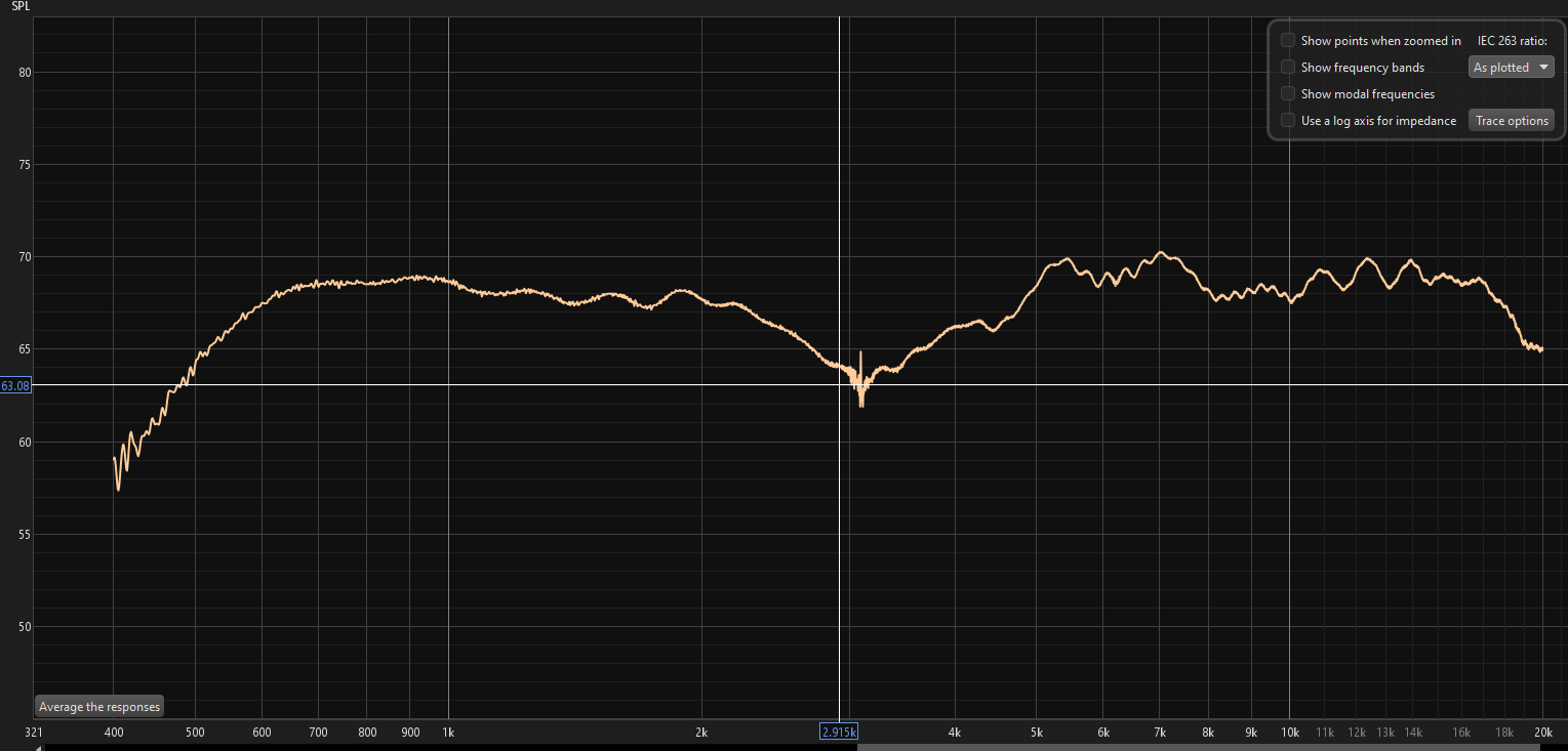

Hello everyone.. I got new mic yesterday. Re run the measurement
I think the boost from my previous measurement is from the microphone..
But the dip still there. Should i accept the dip and go on?

Good results with the new mike. I already gave a clue on baffle modification 😉. An 1” roundover won’t be enough, I’d predict.Or should i make new baffle?
No, you should not be satisfied with that result.Hello everyone.. I got new mic yesterday. Re run the measurement

Please could you give a little bit more information to tell us exactly what was done to give the measurement shown in post 50? Mic distance, on tweeter axis, Response of the loudspeaker and crossover combined?
Does the new mic come with a cal file and how did you apply that?
Also some details of the crossover used even if you just mention second or third order and corner frequency, 3Kiloherz maybe. I am not sure hat caused the little wiggle you have there, Possibly reversing phase to one of them could make the dip better or worse.
Maybe as you get to the final phase you will need some attenuation on the tweeter.

[Edit] There is a funny little wrinkle in the bespoke dip in your response curve though. And it appears in all of your far-field measurements. That should be examined, could it be some fault in your measurement setup, like something causing reflections near your speaker or microphone?
He did say he was measuring at 100cm. Seems a little far. Mic only needs to be at a distance greater than twice the baffle width to be far enough to include baffle data.
Centered baffle is about 8", and wavelength of 3k is 4.5". Is anything protruding or bumped out at about 101mm from center of dome? Since it has not been suggested, place heavy felt between tweeter and woofer and see if the dip goes away.

Here is the notes of the measurements
1. The mic is behringer ECM8000, Is not specifically calibrated mic, or has specific calibration file, just generic cal file, I'm aware that this mic is far from 100% accurate, but hopefully is still on the acceptable tolerance
2. The measurement i posted here is just the tweeter only, without any crossover, But from REW the sweep start from around 400hz (not sure whether it is safe or not) and gated around 4 to 5ms
3. The mic position is at the tweeter level, around 100cm distance,
4. The speaker is in the middle of the room (not exactly middle, and standing on top of chair) to minimize reflection.
