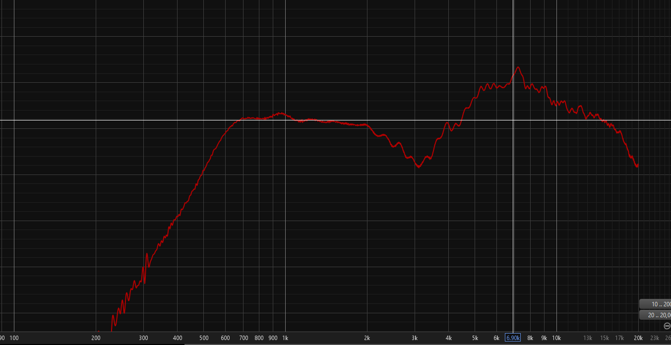

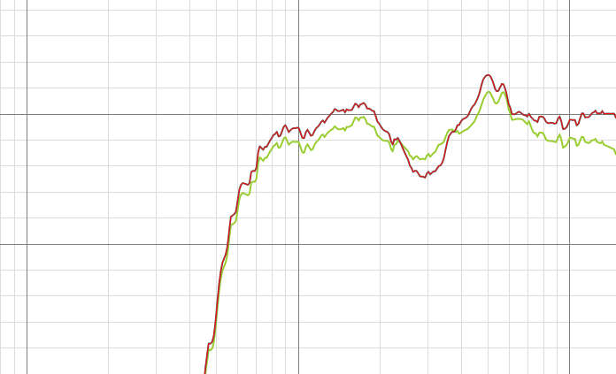

Done testing the tweeter with some cardboard, so it acts like flush mounted.
There are improvement on the 3khz area and the lower end get a bit more body i guess..
For the peak around 4k to 10k might be the RTA Mic , the mic is not calibrated , just some cheap mic without any calibration file / data.. But i'm not so sure..
Definitely will flush mount the tweeter and do some more round over..
The red one is the new frequency response

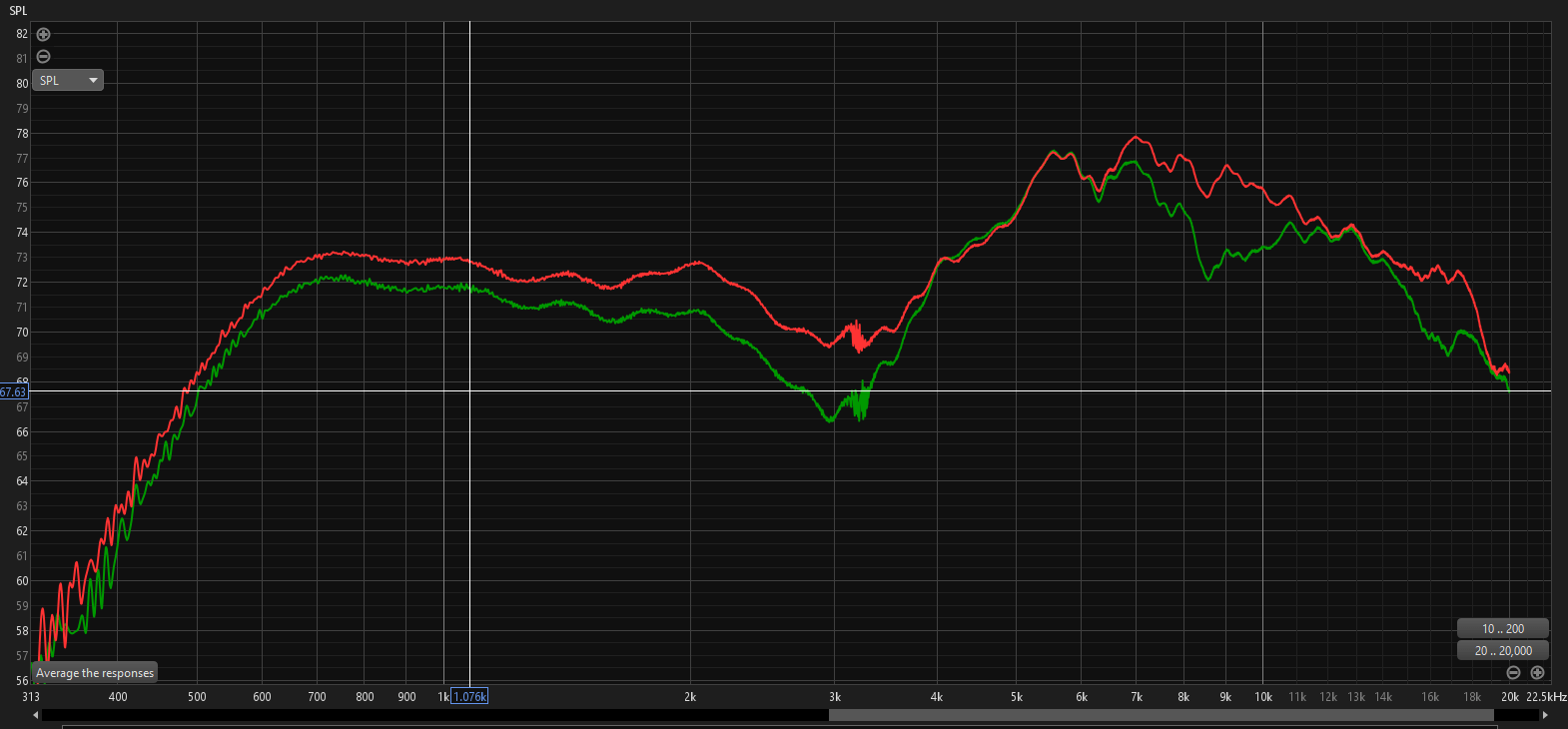

Here is the near field measurements.. The spl adjusted to match the level..
The Blue is the near field measurement.. Is this looks normal?
Real near field measurement will usually not give you the correct response. Specially not in the high registers. Try 5-10 cm instead.
You have however removed the influence of diffraction and caught some of the drivers character.

You have the same dips and peaks in you measurement but more pronounced.
You certainly clearly have shown how important it is to reduce diffraction as much as possible by flush mounting the tweeters surface with the baffle surface and keep cabinet edges rounded.
This is really useful. The difference at 3K can be attributed to the cabinet. Above 10k I imagine is due to the phase plug (cover) on the tweeter. Your mic is too close to pick up the full radiation pattern. That's fine, what we care about in assessing the issue is the 3k dip. @flex2 is probably right that you'll want to re-measure at further afield with gated measurements later on to re-assess, but in terms of answering the question about your 3k dip, you now have your answer. 😉

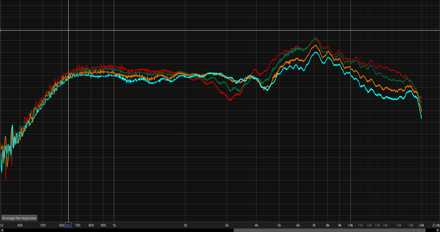

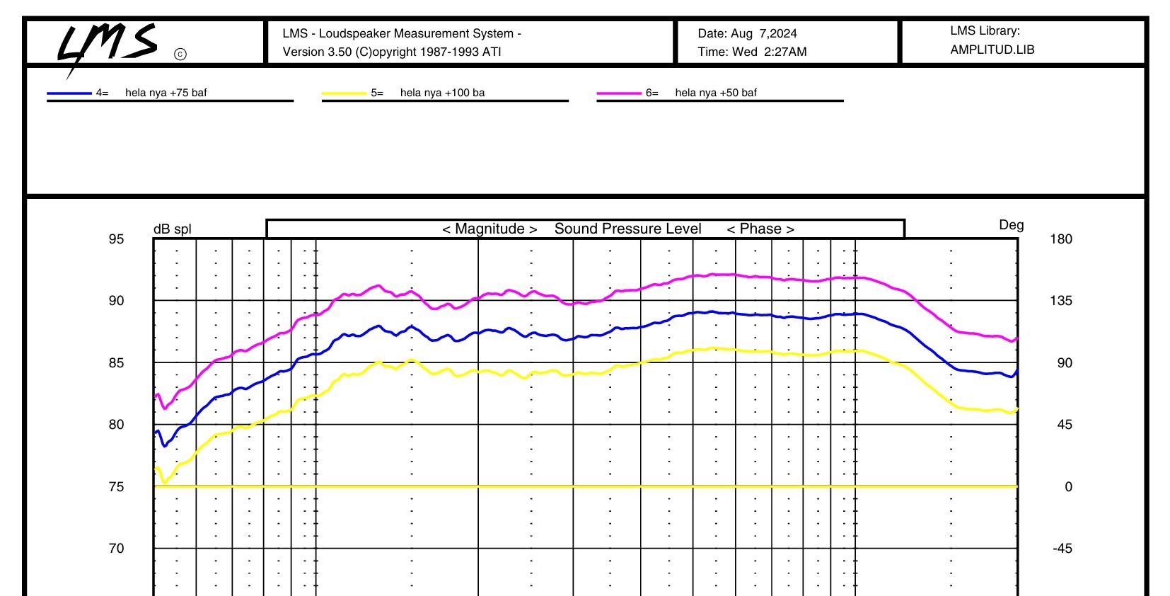

Here are some results of reduced diffraction because of added distance to one of the edges. In this case the top edge.
All edges have 25mm rounding.
The original design have 120 mm between the center of the dome to the side edges and the top edge, and that rendered in quite much diffraction.
Then I added more distance to the top edge by extending the baffle with +50, +75 and +100 mm of baffle.
So 170, 195 and 220 mm between centre of dome to top edge, while distance to side edges remained at 120 mm.
Here some added distance to top edge improved linearity by reducing diffraction or linearize diffraction as a consequence of selecting a different distance to top edge compared to side edges.
Purple +50mm
Blue +75mm
Yellow +100mm
So don't be afraid to have some distance to the top edge.
Curves scaled by 3dB for visual reasons.

I must admit it I didn't realise diffraction effects could compound so badly. I need to make a note to self to always flush mount the tweeter and keep it away from the top edge unless you have modelled its characteristics.

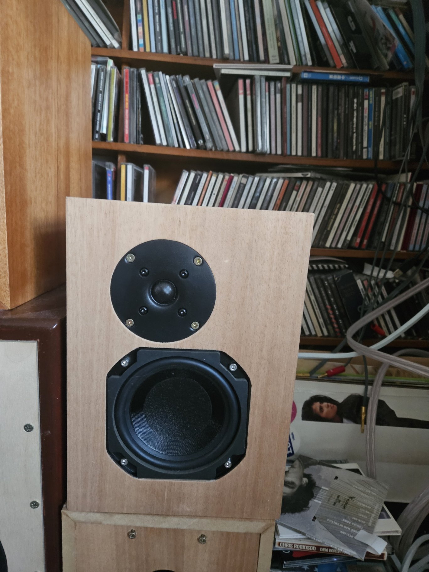

The phase plate looks fine, I asked the question just to make sure it handed been banged or was touching the dome.

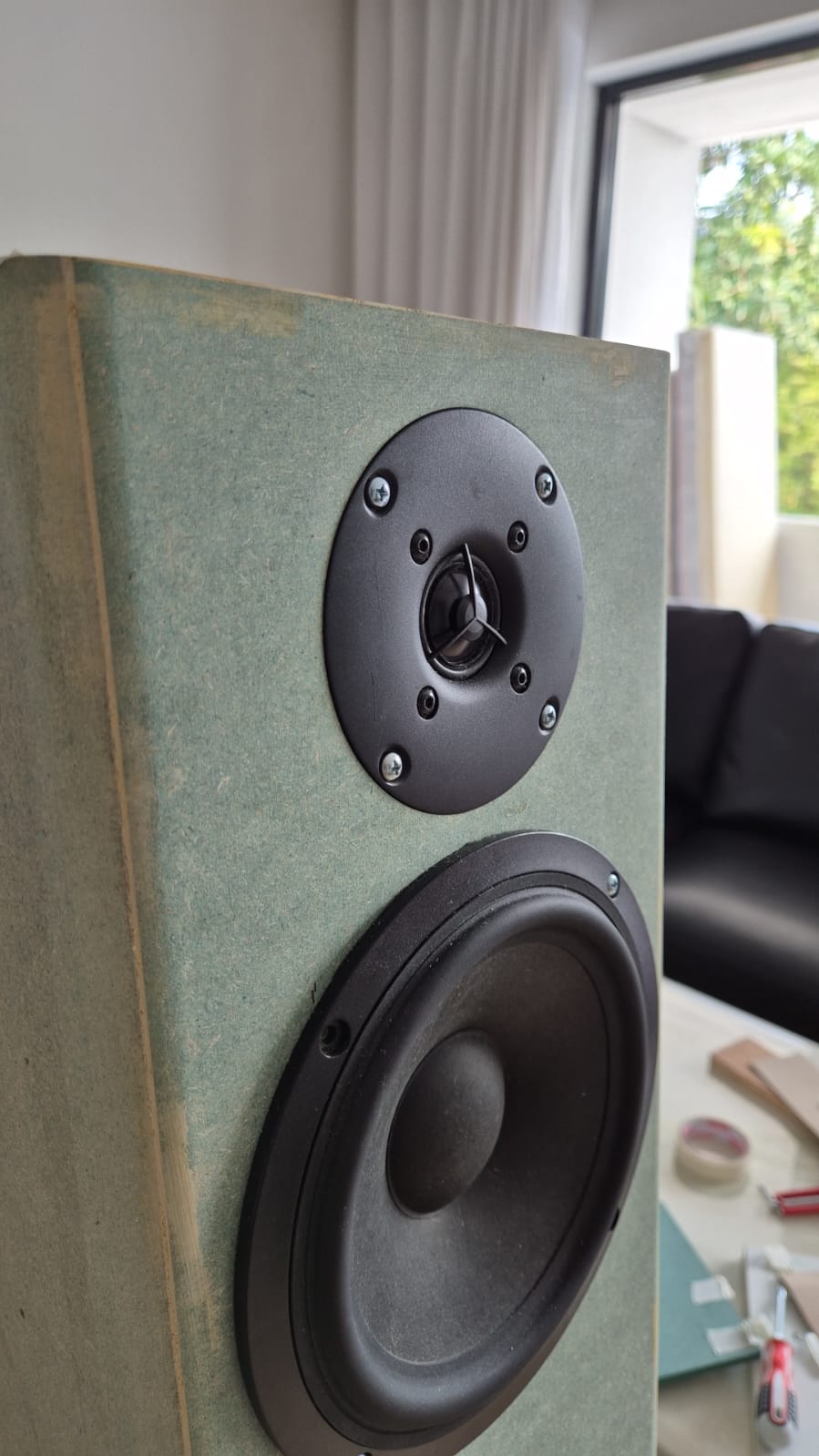

With a bit of ingenuity you should be able to attach a piece of wood behind the tweeter cut-out using a pinner or some glue and then add a circular piece of wood to allow a new centre hole to be drilled to align a router jig to cut a flush rebate for the tweeter.

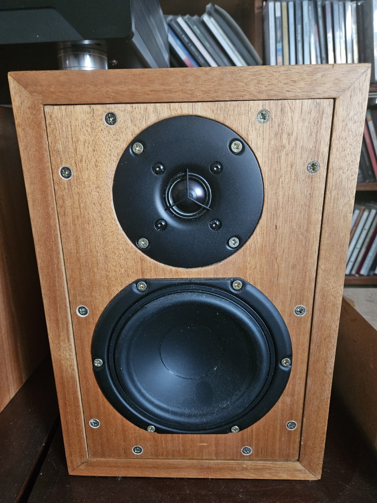

Hello.. Just updated the baffle.. I just have the time to do it recently..
Somehow i lost my previous measurement so i can't overlay it. The dip is better but not much .still the same, but the low end below 2k got some boost there..
I still don't know what causes the peak on the 6k region, i tried to put extra thickness at the top baffle, and other baffle" tweak. but nothing works..
Also the round over is now 0,75inch..

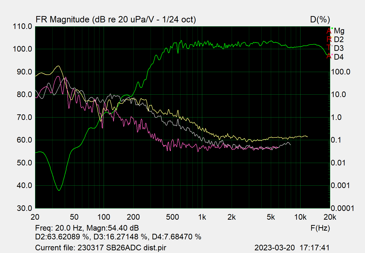

Any diffraction effects become apparent when measuring the polars. Like said above, perform off-axis in incremental steps of 10 degrees. You’ll need those anyway for your design.
As shown, the ADC does pretty well, enclosed measurement was done at 30cm on a test baffle of 60x75cm. It’s essentially showing the limits of my (old) measurement gear that I changed afterwards because of this graph…
