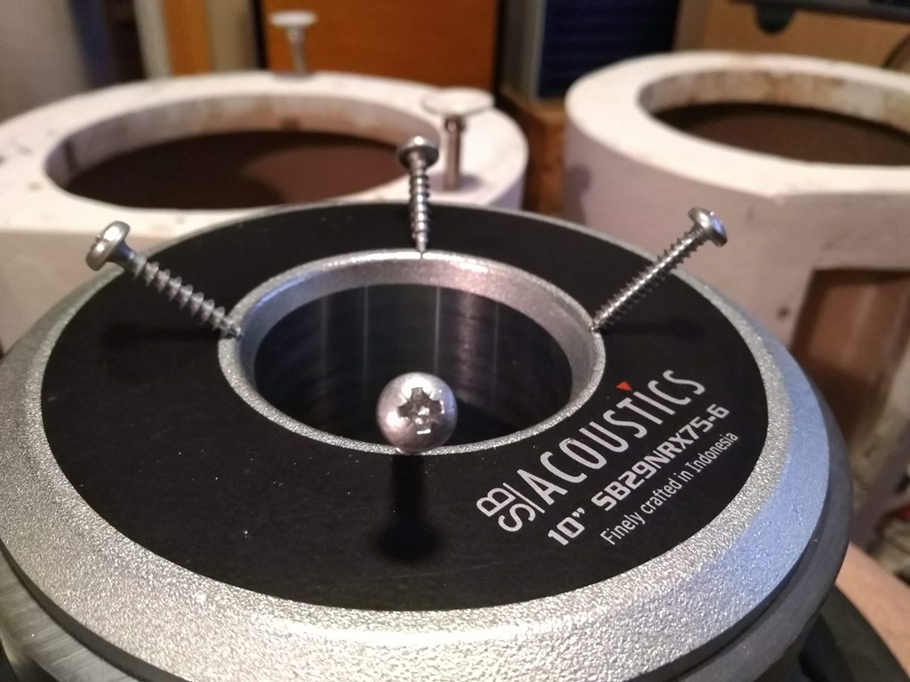

^So, as you are almost my age, you do remember the closed box hifi bass sound! I lost 35 years of my life listening to reflex bass, sad days!
My latest two speakers have single 10" woofers per side, closed box with some low end eq, active. No need for subwoofers, but I don't play very loud (^100dB) Double 10" would be nice, one of my diy/mod speakers has 2x8" ScanSpeak closed and it is ok too. Response with minimal group delay from 25Hz up, without reflex gives you the natural bass.
SB Acoustics give best value now, and some very good models in Satori line. My latest have SBA 29NRX75-6 woofers which are really good. I haven't heard the new WO24, but it has actually 8" cone diameter, 29NRX has 9½", 255 vs 312cm2. Linear travel alike 17 vs. 22mm, so NRX has almost double the air displacement capacity of WO! And NRX is cheaper too.

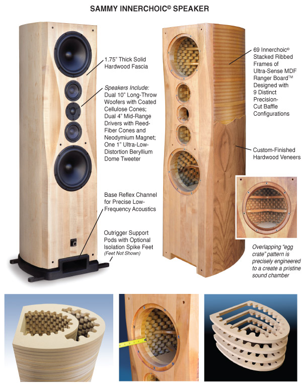

PBN Audio uses Translam construction with the MTM topology. You might find construction ideas on their website.

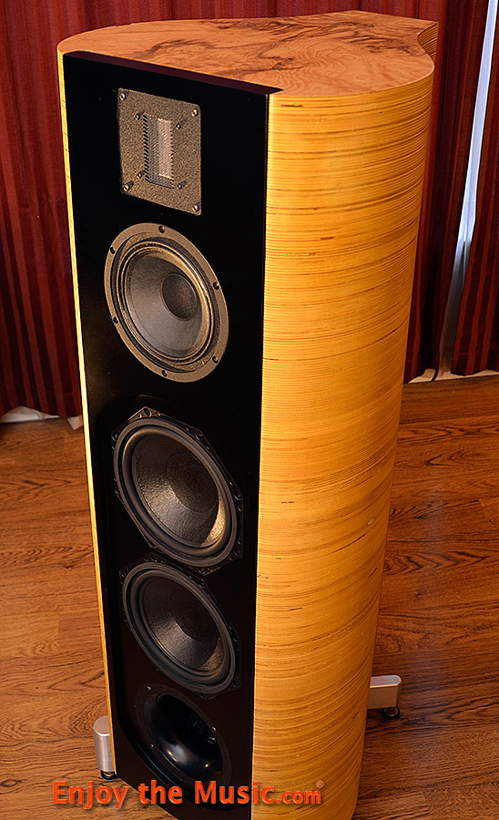

A TMWW with a 6.5" midrange like the Vapor Derecho seems close to your original translam goals. only 84 slices! You can seal the Derecho and use DSP room equalization for deep bass. (Avalon Beveled cabinets starting to look good?)
