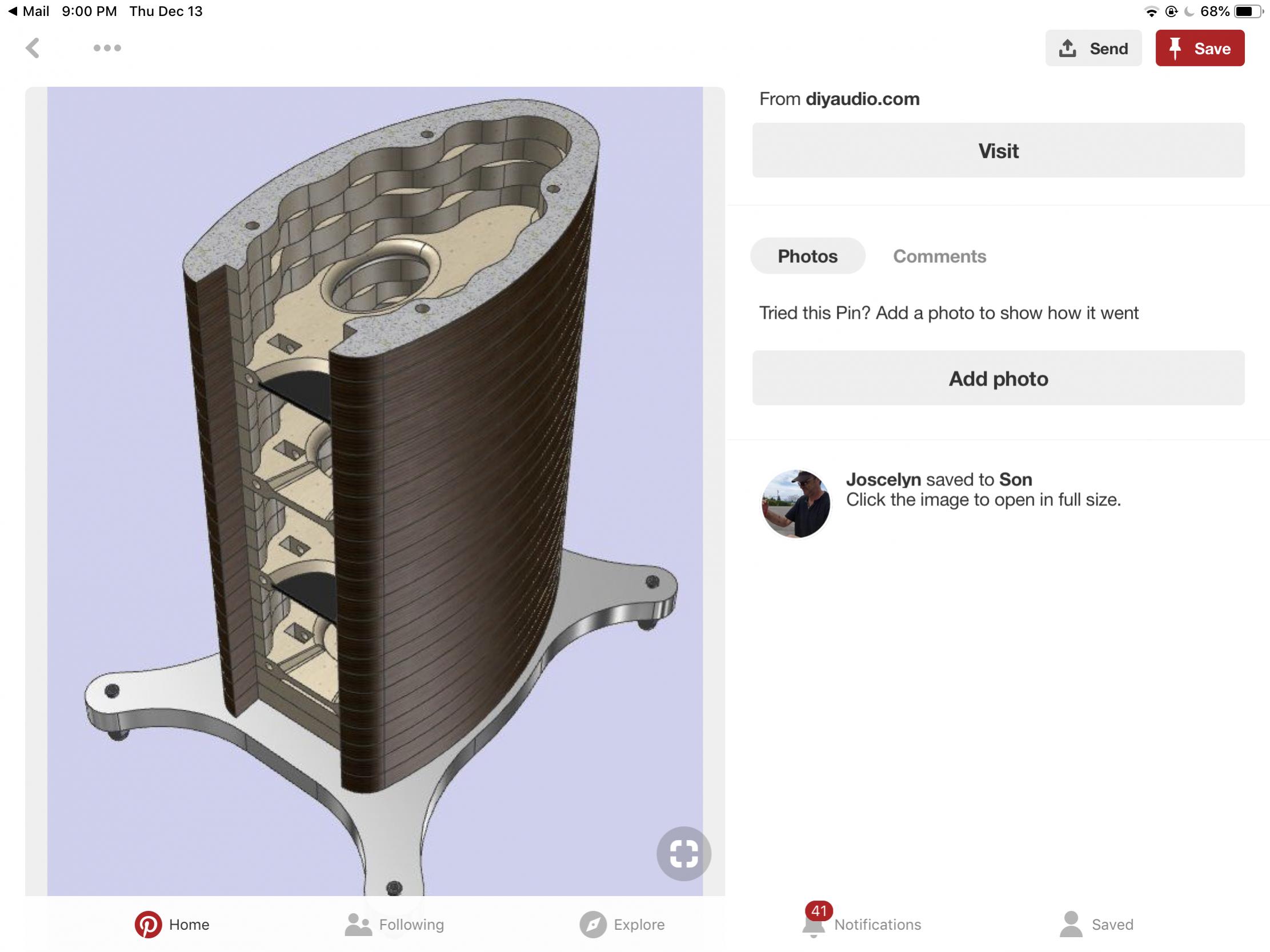

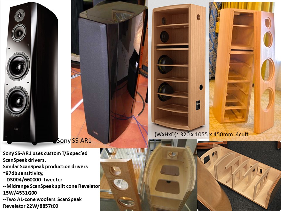

With DSP performing driver time alignment, tilted baffles are not necessary... but you still want to select a physical driver alignment with a well controller polar response which mimics a point source launched at the tweeter.
PBN Audio uses Translam construction with the MTM topology. You might find construction ideas on their website.
A TMWW with a 6.5" midrange like the Vapor Derecho seems close to your original translam goals. only 84 slices! You can seal the Derecho and use DSP room equalization for deep bass. (Avalon Beveled cabinets starting to look good?)
