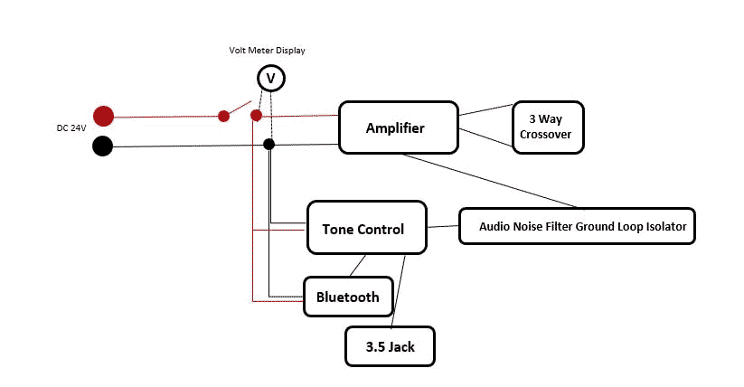

Hi, I have the following issues for my build
1) Runs on a 24V Li Battery, when switch on, i need to power on and off 2 times, to power on the amp.
2) When i power on there is a "Boom" sound, how do i remove this "Boom".
3) My charging input and and power output is connected in parallel in the circuit, when charger is connected, speaker on, i can hear background noise, meaning that i can direct charge and on the speaker, how can i remove this?
Hi, Im a noob here.
Build my first speaker case
The design diagram
attachment.php
I have the following issues:
1) When i switch on, there is a "Thud" on the the drivers, how to i get rid of this?
2) All my audio input goes through the tone control, in this case there is a NOISE i can here from the drivers, even if i put the Noise filter after the tone control, but if i connect direct input to noise filter to amplifier there is no noise.
Is there a better way?
More picture here:
https://drive.google.com/open?
id=0B_0GEBCtZpeQTF9ScnYtMEpHNjA
In pro audio the turn on/off procedure to avoid noise and/or damage is:
Turn on:
1] music sources
2] controllers & processors
3] power amplifiers
Turn off:
1] power amplifiers
3] music sources
Why? because when the power supplies turn on or off they can generate a pop.
