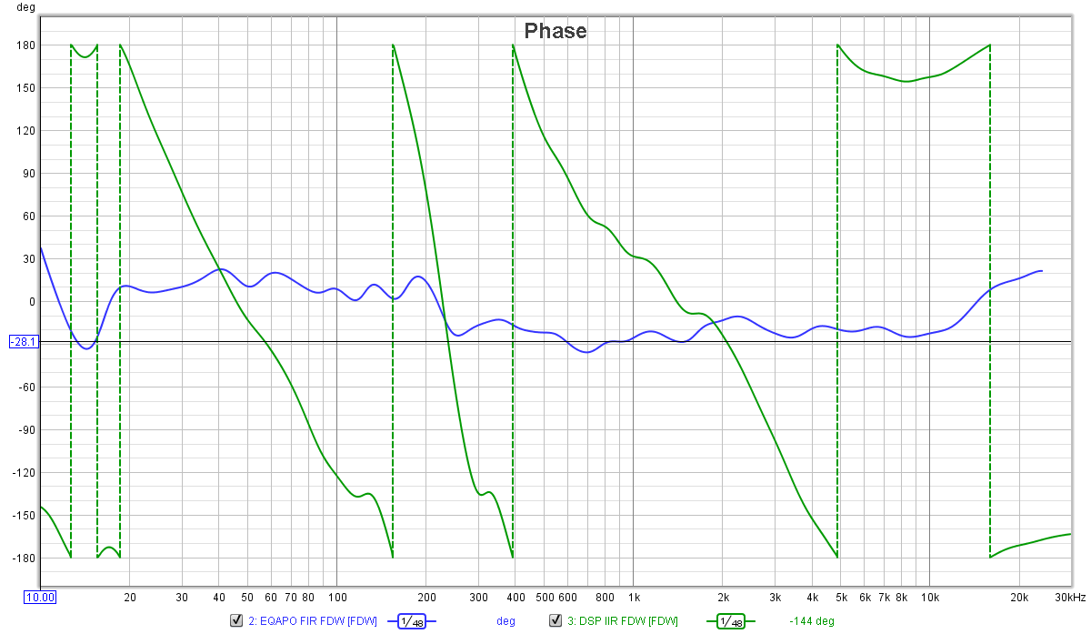

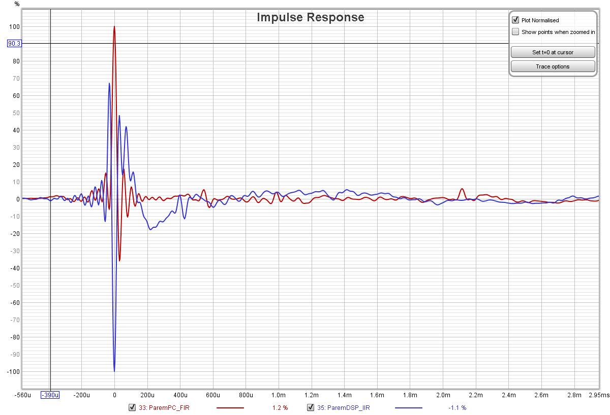

I have made 3-way active OB speakers with EQ APO FIR filters and EQ, I used also rePhase and Voicemeter, as DAC was used ESI Gigaport EX.
On comparison image DSP based IIR is lower set , higher is EQ APO based FIR, measurement is made from listening position in room.
