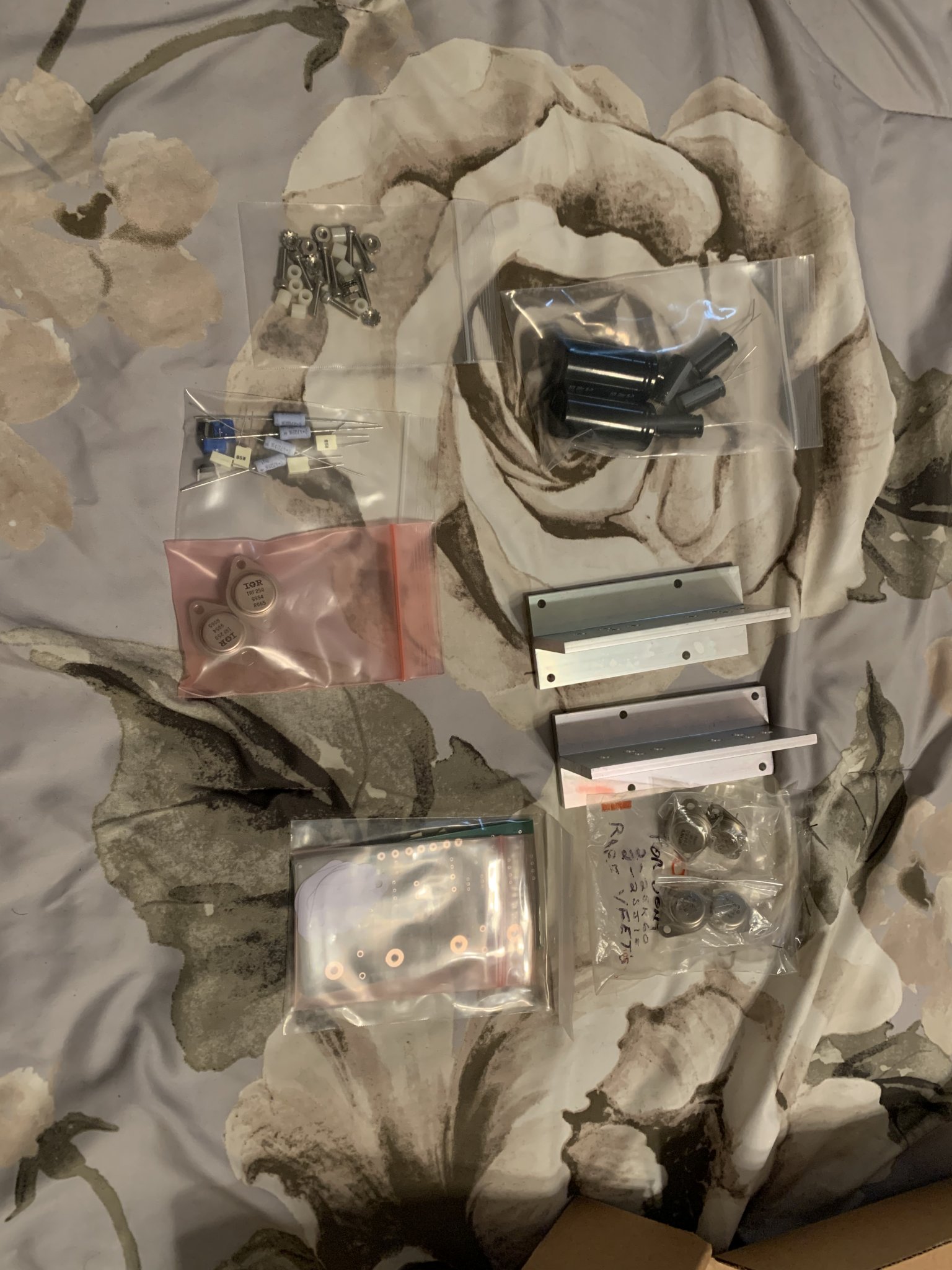

Got my p channel kit today, WooHoo! Thanks again Mr Pass & diy audio

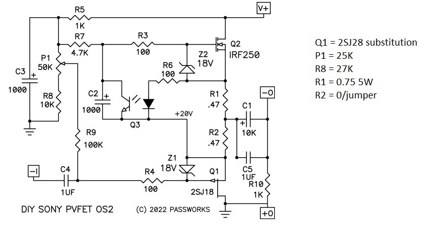

I am trying to understand why the N channel variation, using the 2SK60, doesn't use a mu follower like in the P channel variation, with the 2SK60 drain at ground, which would avoid the need for extra power supply filtering. Was there no suitable PFET counterpart to the IRF250, or was there another reason not to use a mu-follower?Attached is the document detailing the DIY Sony VFET OS2 output stages.
The biggest differences are in the current sources. Where the originals used constant current sources, for the P channel design we have a mu follower and for the N channel a novel variation. Both of these are constant current for DC, but can be adjusted to supply a percentage of the output current in support of the smaller VFET chips.
Does the switching supply care which polarity is connected to ground?I think it is to keep the use of a V+ switching power supply.
I am not familiar with switching supplies. Perhaps not all SMPS are floating, with some having the negative connected to ground.
Do you have a clever name for it? Something like 'Reverse MUFF' or 'NEMU' is what I'm hoping for...And it showcases another topology...
My working name for it is not suitable for public forums.
When R2 is zero, is is a current source, otherwise it is a common-gate amplifier stage. Perhaps there a similar circuit in the tube world with a triode cathode follower (replacing the 2SK60) and another tube (pentode perhaps) replacing the IRF250. Find the name of that circuit.Do you have a clever name for it? Something like 'Reverse MUFF' or 'NEMU' is what I'm hoping for...
