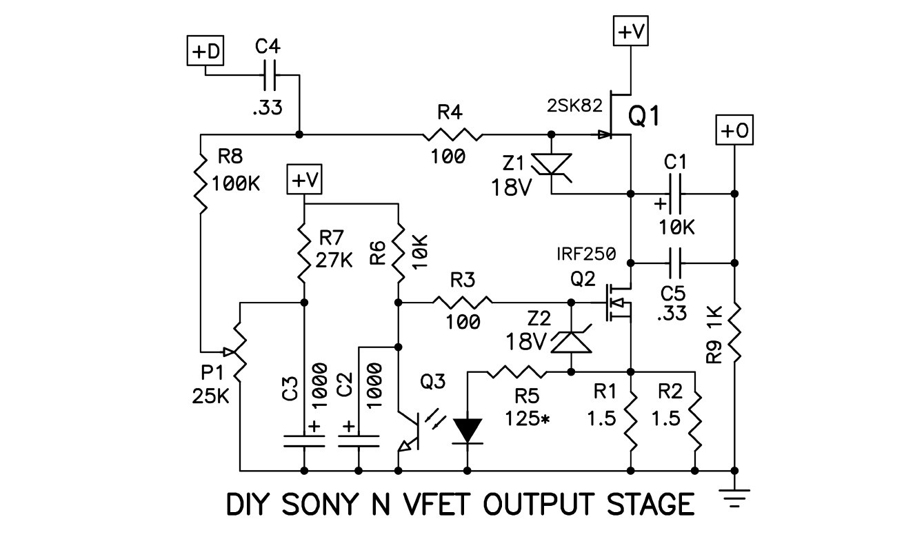

For P channel VFET, assuming you have a 36V power supply, you want to adjust the pot so that the Voltage at VFET drain referenced to ground

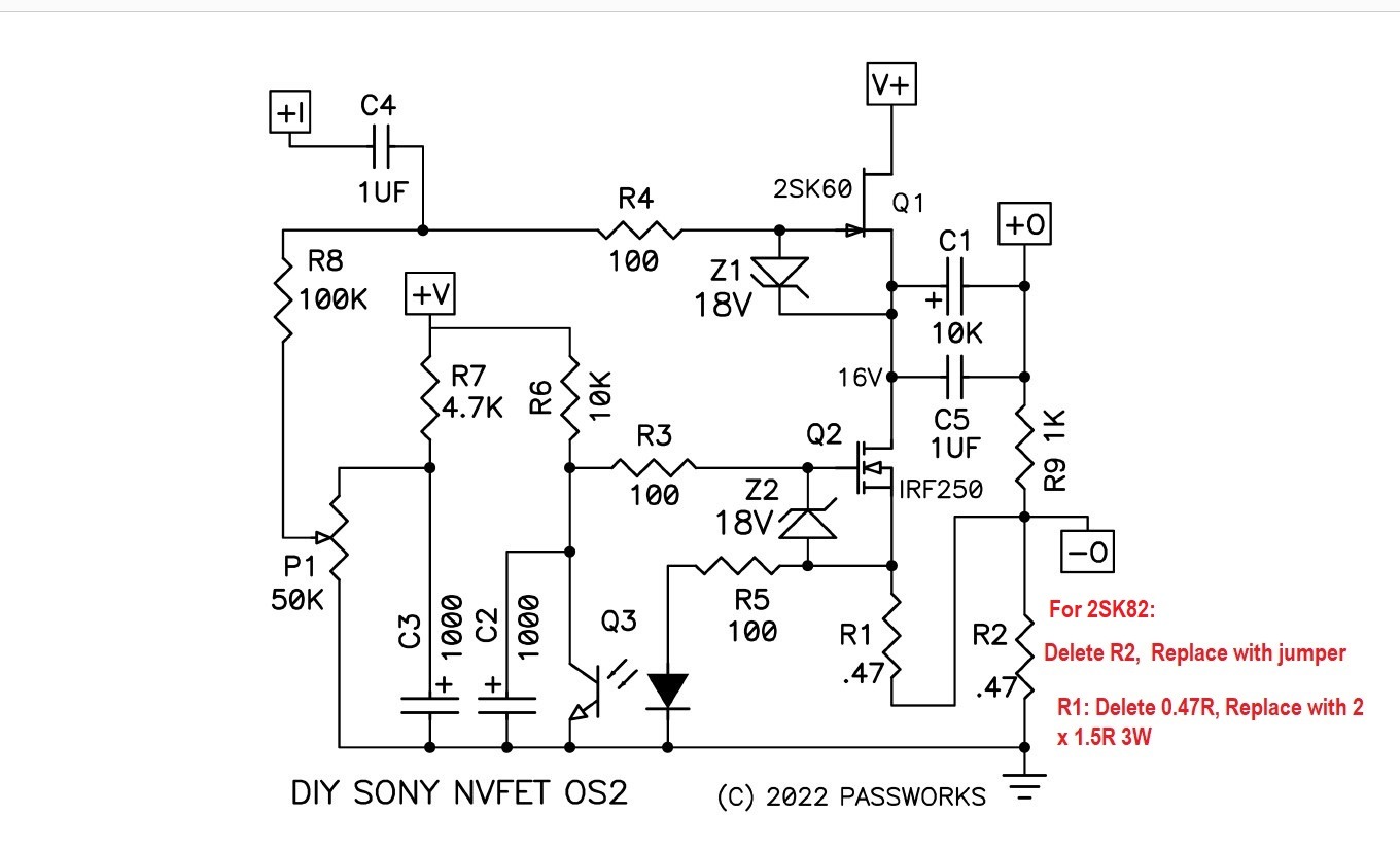

Here are the changes for 2SK60 OS2 to 2SK82 Part 2. You may also need to change R5. Nelson mentioned it in his Part 2 article.View attachment 1150292View attachment 1150293
Will the 2sk82 voltage be at 14 volts instead of 16 volts for 2sk60.? Just want to make sure , I have 2sj18 in my amp now and going to swap to p channel kit with 2sk82.
The circuit for the 2SK82 is a bit different from the 2SK60 circuit. If you build with the 2SK82 follow the 2SK82 schematic and its instructions. If you build with the 2SK60 follow the 2SK60 schematic and its instructions.
If you have the 2SJ18 right now, that is already a P channel kit. The 2SK82 is N channel and would require a N channel board.
Thanks Ben, I bought the OS2 n channel kit to use with a pair of 2sk82 I have. I will need the 1.5 ohm R1 and R2 along with the 125 ohm (which I am having trouble sourcing) for the OS2 N channel kit. I will swap the p channels I have in the amp now.

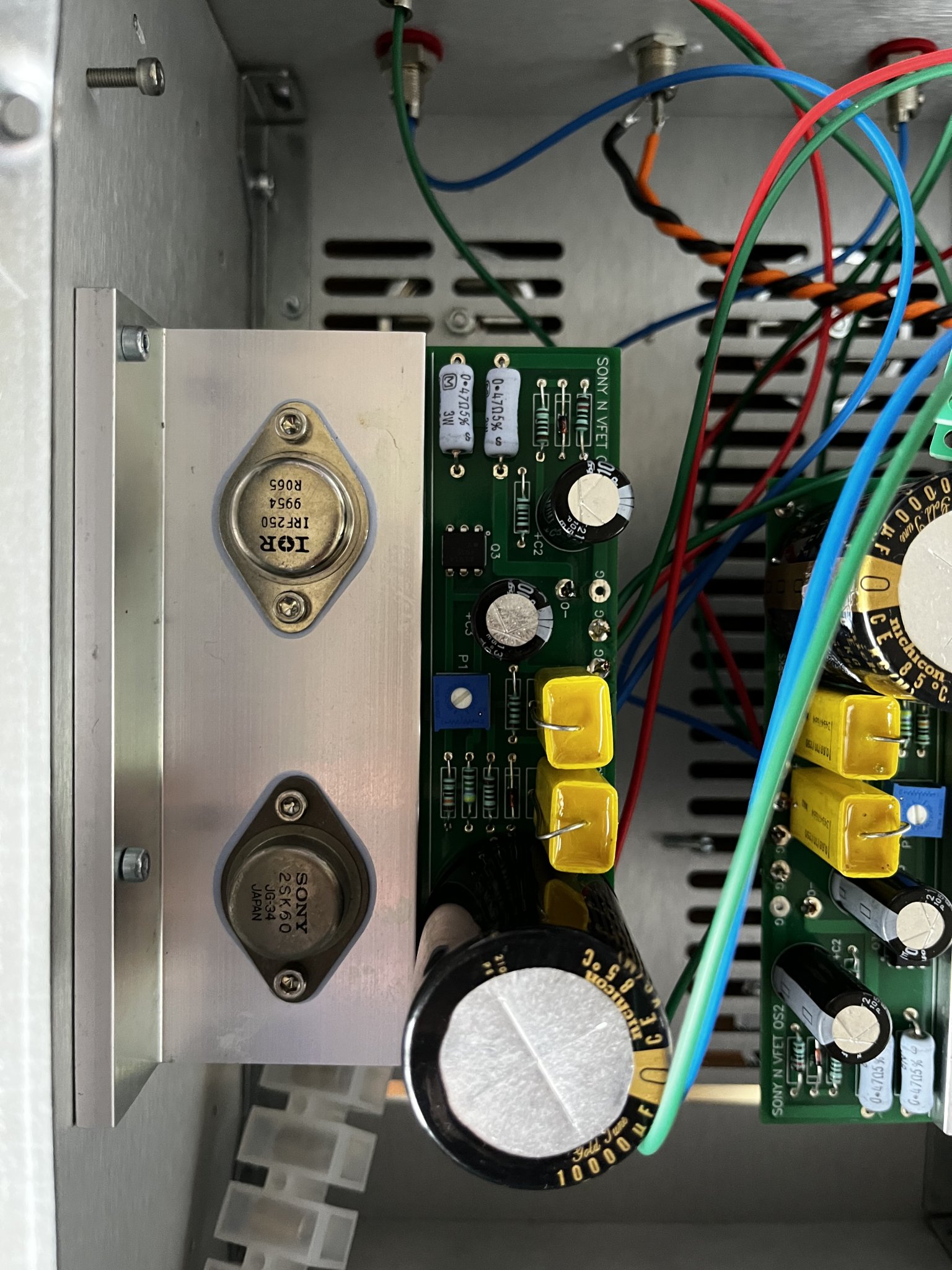

Hi.
I tried putting the multi meter probes on the body of the vfet to bias. Only getting a fixed 36v reading.
Is there a better place to measure the bias for this board ?
Thank you
