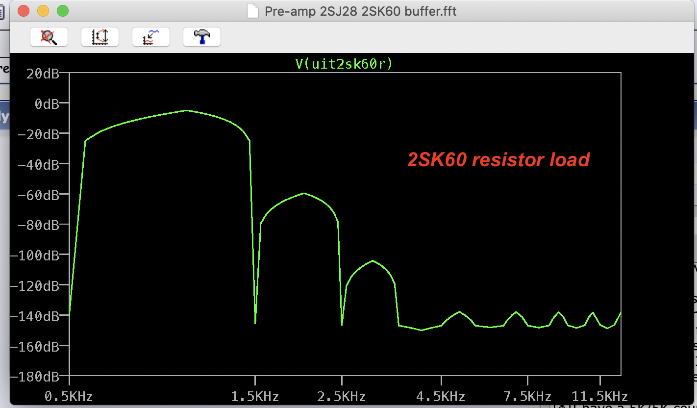

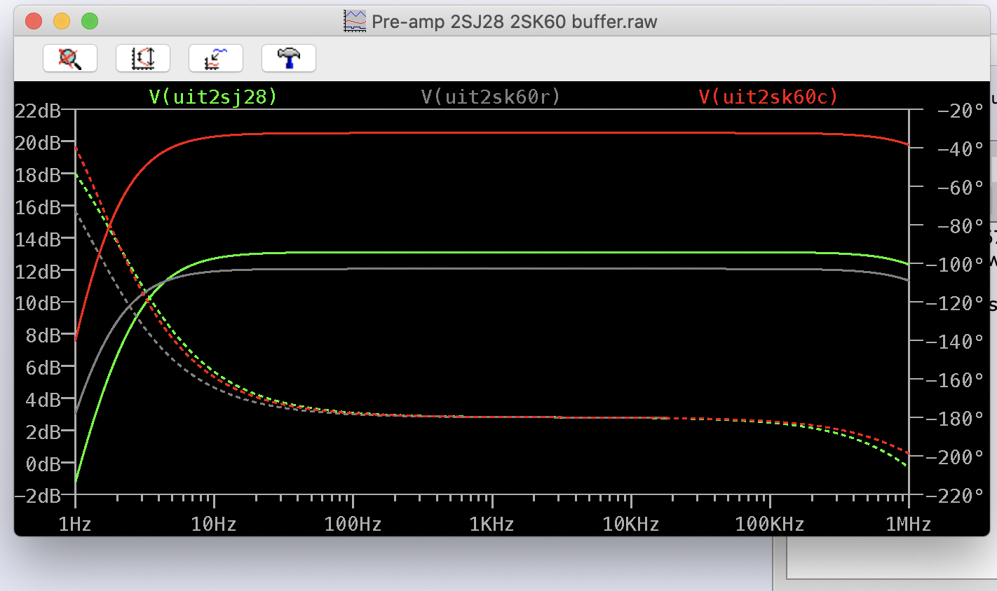

Hi Franz, I did some simulations around the 2SJ28 and 2SK60 for a line stage. The latter has half the power hence capacitance etc as the first one.
The 2SJ28 schema as far as I remember should resemble the Luminaria. Probably I changed the voltages a bit.
In the 2SK60 schema I went for choke, resistor and transformer load.
It should get more tweaking, to reduce the gain.
- I have a 5K/5K coupling transformer that allows 50 mA, glas-met-alloy. Both side have a centre tap. That allows me to reduce 6 dB without a high "cost".
