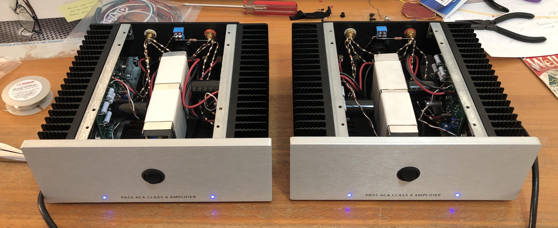

The new VFET amp has features in place to perform at a high level with a single SMPS power supply. In addition to the DC inlet filter, the input cards and the output stages have local 1000 uF power decoupling capacitors to improve channel separation.
That doesn’t mean that I won’t eventually build a dual mono linear PSU for it. I’m just funny that way. It does mean that the external linear supply will need to be a top of the line implementation to have a fair chance of letting the amp sound better. So, big and heavy, and full of AC line voltage. Something very similar to what I did for my F6.

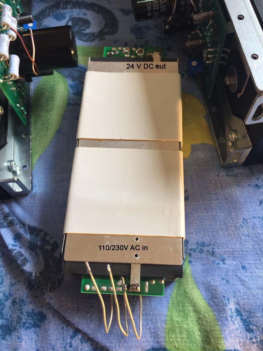

So for +/- you hook the + terminal from one to the - terminal of the other?
Seems that you would hook the 2 - terminals together ....
This only works if the negative terminal is isolated from the earth ground. Which I think it is. I can check the Mean Well 24v brick I have. I have done this with the 24v 5A LED lighting SMPS on the M2. It worked like a champ. Very low noise and the hum went away.
Plus to minus forms the common 0v (analog ground).
Just checked. The earth ground is indeed isolated from the negative output (and positive output of course). This is a Mean Well GST60A24-P1J. 24v 2.5A SMPS “brick”.
