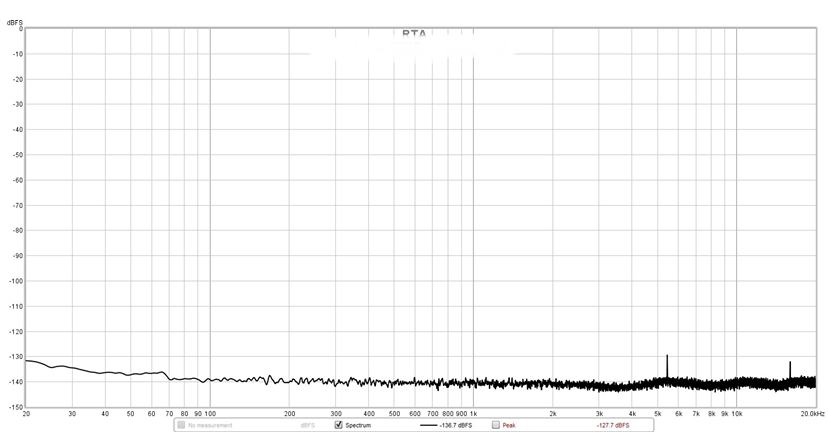

More than a side benefit is noise performance benefit. Here is the FFT of the noise floor of an amp I recently built using a SMPS from Micro-Audio. This is with the inputs to the preamp stage shorted. The preamp used a small Mean Well PCB mounted DCDC converter (another tiny SMPS) to generate +/-15v from the 12v auxiliary output of the 51V SMPS. The SMPS is capable of supplying 600w continuously. I don’t know about you guys, but I have never been able to get the noise floor of any linear PSU to be this clean. Full scale output is referenced to -10dB. So the noise floor (not including the little blips) is very very low - inaudible. Cannot tell the amp us turned on - a similar comment I heard 6L6 say about the VFET - and that’s a great thing to say about any amp. So both preamp and main power amp were powered by SMPS’s. Result is absolutely quiet amp.
FFT of amp output into 10ohm load, inputs to preamp shorted. Ref to max signal at -10dB so noise floor is -130dB:
attachment.php
With my ear pressed (touching the driver), I cannot tell the amp is turned on.

Normally building a good linear PSU for a power amp is expensive, time consuming and makes the amp very heavy (and large).
Maybe a good designed SMPS with good filtering is perfect for "constant current" amps like KL. A amps.
For class A/B a linear PSU with a large cap. bank is probably needed to deliver fast peak currents.....
