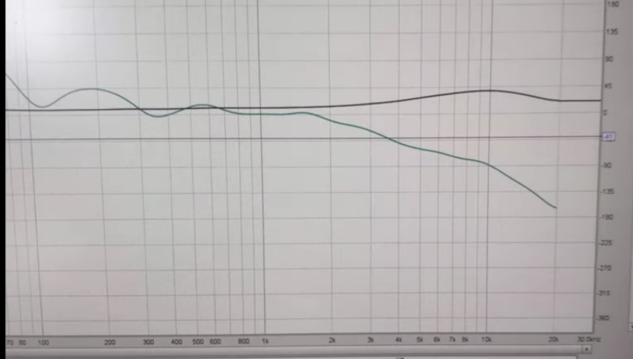

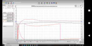

I built it in on the balcony in a tiny appartment in Oslo. The midrange horn goes down straight to 270Hz where I highpass it at BW48dB. It was inspired by JMLC Iwata-220. A Raal tweeter in a deep horn from my own twisted mind, takes over at 2500Hz. Here is a Raw measurement from 30cm and overall measurement from 3 meters. The small horn makes the Raal sound like a midrange driver. The midbass will be replaced with a midrange horn with a Fane 8" as soon as I have the space. Subwoofer is just a
sealed Eminence Lab12, that does 35Hz and measures horribly.
I am going to do some changes and add a second compression driver in a smaller horn to releave the Raal from midrange duty. Hopefully that will let Raal go higher. Otherwise "EQ boost button, were art thou?!" And ofc build a midbass horn and bass.
