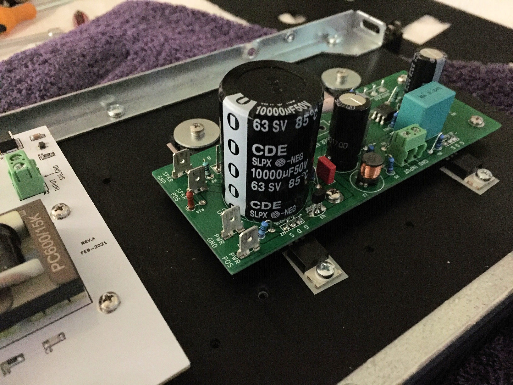

I'm messing around with electrically-compatible, physically compatible, amp channel boards -- boards
which use semiconductor devices you can buy today from Mouser (i.e. NOT VFETs).
Because the boards are electrically-compatible, they use the same single ended power supply:
+36V,GND. So they have an output coupling capacitor, just like the lottery VFET cards. Here's
one such amp channel board, the capacitor is ten millifarads, 50 volts, snap-in terminals @ 10mm
lead spacing.
The white thing at lower left is a Relentless front end card. Click on the image to see it full
size and undistorted.

The 10.000 uF output cap will be very close to its ESR value already at relative low frequencies so a small bypass cap is "nonsense". If the output cap is audio grade quality it will stay at its ESR at 20 kHz and higher frequencies and then from a point raise in impedance caused by the inductance. I guess the ESR for such a cap is maybe 10-15 mohm? .....try to calculate the impedance of the small bypass cap at 20 KHz and compare to 10-15 mOhm.
as the perfect audiofool i have put a russian 30uf PIO here and it seems it doesn't harm at all 😀

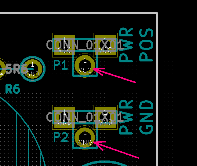

Naturally it is easy and simple to NOT stuff the FastOn 6.35mm (1/4 inch) blade connectors. When you omit those, there are big-fat-wire thru-holes to assist a hardwired and soldered connection. See arrows on image below.
It is also easy and simple to NOT stuff the Euro style screw cage terminal block. Just solder your input twisted pair or input coax cable, to the IN and GND pads where the termblok would go.

Very nice work Mark! I for one, totally am in agreement with the use of Faston spade connectors. Mostly for the reasons of easy to assemble, and less mechanical strain on the wires.
I also like the use of Molex KK 2-pin connectors for audio input.

Color me intrigued by the new OS. Would have to go in a new chassis, but still..
I see what looks like an optocoupler in the far end and a small inductor on the lower edge. And what appear to be different sized FETs on the upper and lower edges.

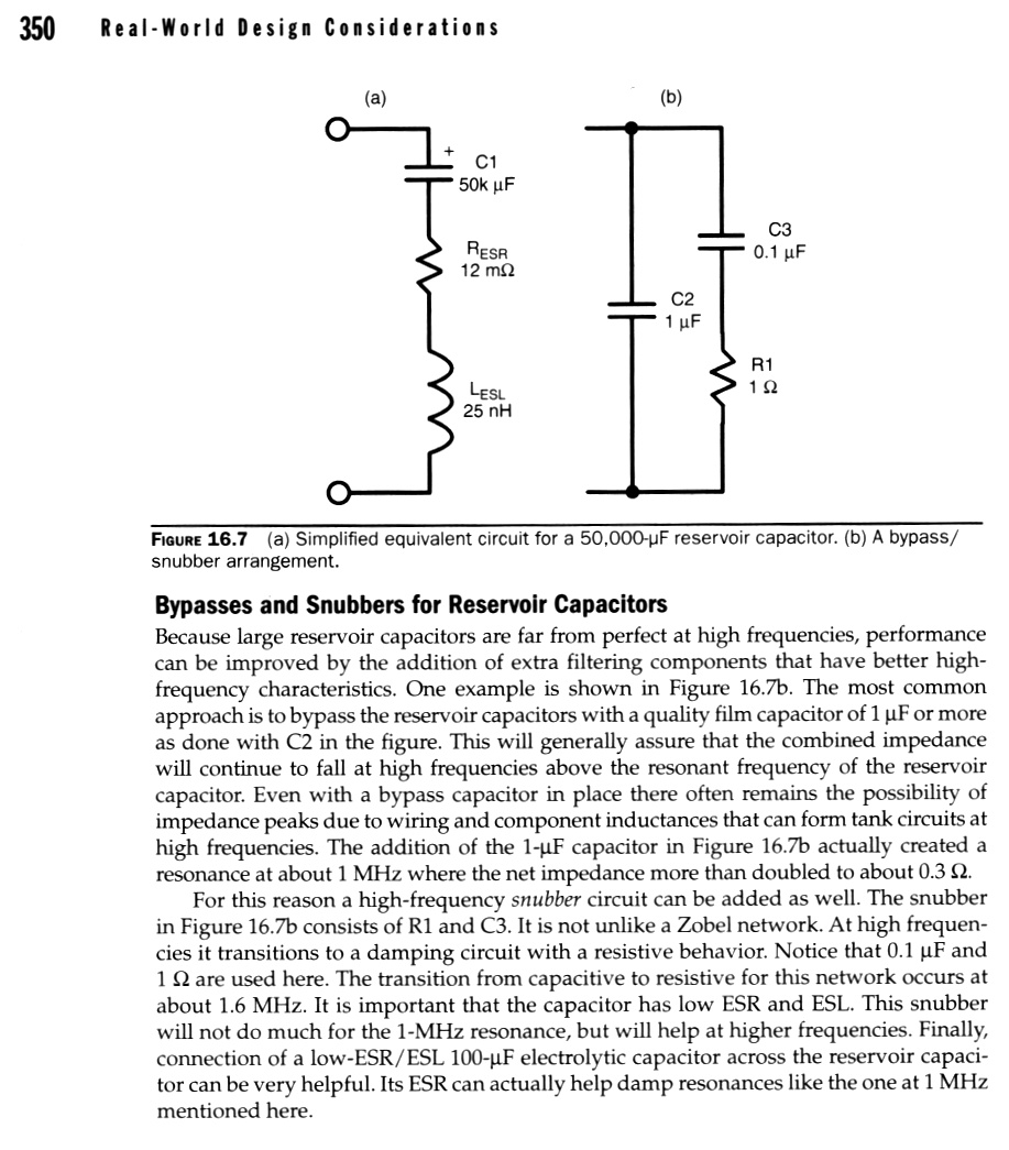

Be sure to study Cordell Figure 19.7 (p.454 of the 2nd edition) and to read the accompanying text.
In the first edition it's Figure 16.7 on page 350.

Here's Figure 16.7 of Cordell's first edition, which is out of print. Bob and I are friends and I'm sure he will be delighted to see one of his figures displayed here under fair use (Wikipedia citation)
If you replace Cordell's phrase "reservoir capacitor" with the phrase "loudspeaker output coupling capacitor", you can begin to appreciate the potential danger when Joe Bob DIY slaps down an audiophile grade, $20 bypass capacitor, without performing careful circuit analysis.

The F2, F2J and SIT3 use 2 in parallel, the F3 use 3 but I have never seen Papa use a snubber in parallel with output coupling cap on any his designs.
DEFiSIT is having 1uF in parallel with 10mF output cap
