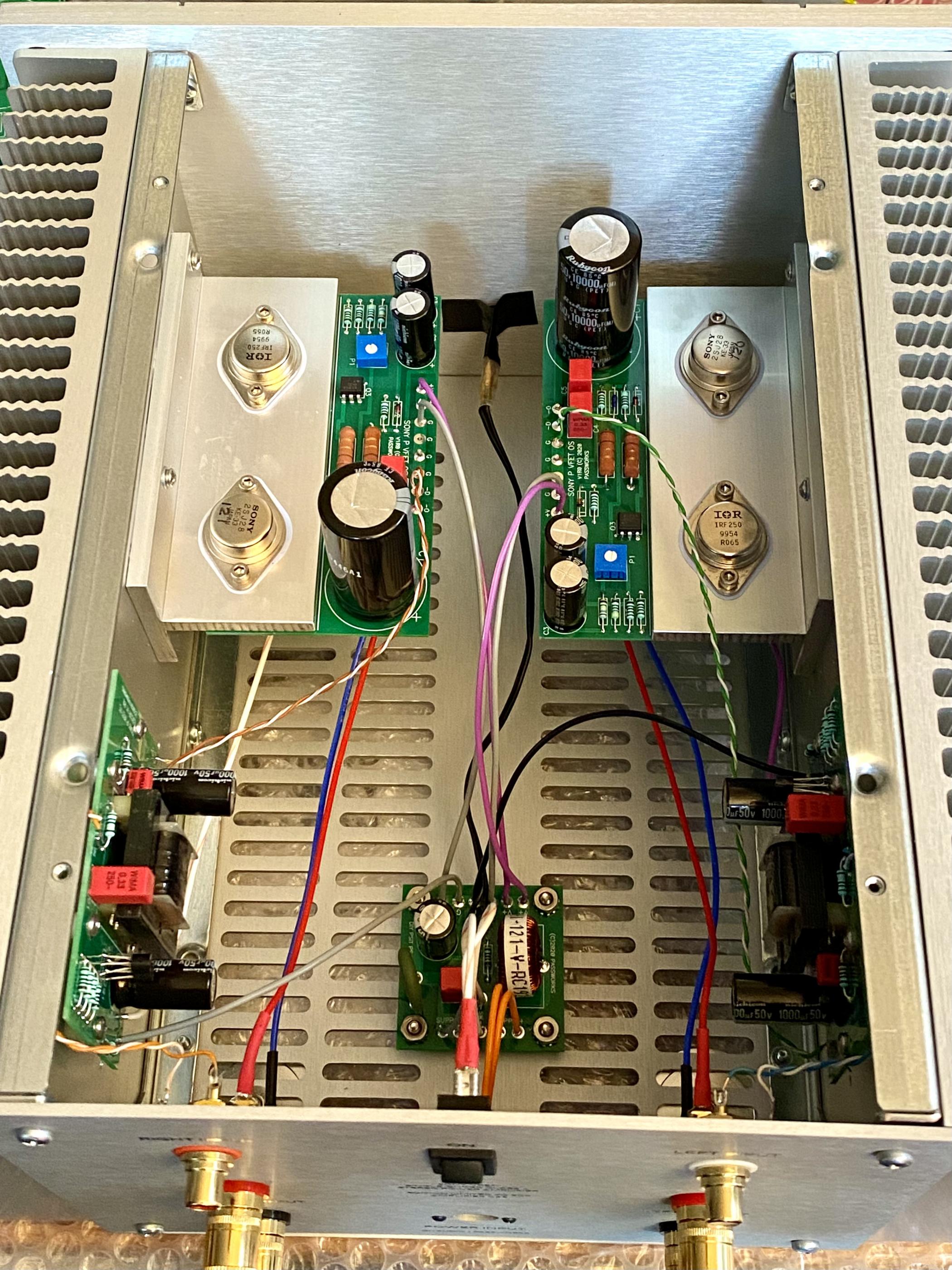

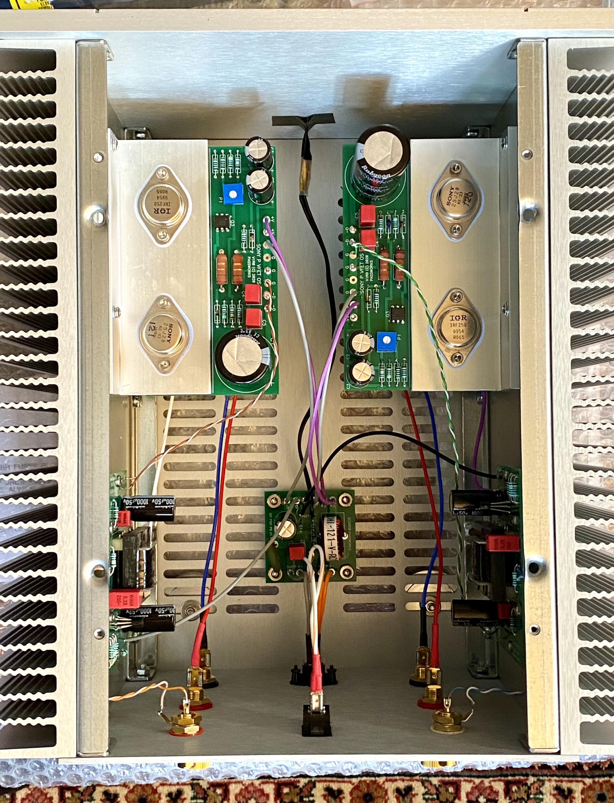

Finally done with the mechanical / electrical assembly of my Sony VFET amp. Next is checking the DC bias points, a small amount of burn-in to check for temperature, then listening!

In the last picture in building guide the power supply wires are twisted but not on previous images (only signal wires)?
Is there a recommendation to twist the DC-power wires (pairs) or not?
I don’t think it really matters on the power wires. The smps is conveniently way outside of the amp, there is no noisey toroidal inside the amp. My power wires were not twisted and my speakers being so efficient usually magnify any potential noise... but this amp is creepy quiet!
