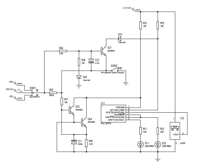

In This amp I am experimenting with control/protection circuits. Although this one is lower power ~30W(avg)/ch, it uses rail switches for the output stage. The circuit design allows for the entire output stage and drivers to be switched off in the event of a fault. I set this circuit up for a maximum allowable current of 6A. If more tries to flow, then the control circuit not only releases the relay, it switches off the output stage must faster than a blowing fuse. Shorting out the speaker wires simply makes the amp switch back into 'stand-by' mode. I am making a scaled up version of this circuit and intend to apply the same principles. I prefer to control the power rails instead of using something like a crow bar. That concept protects the speaker at the expense of the amplifier.:whip:

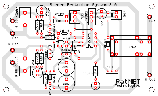

greetings thanks for replying nice to hear you are also working on protection its good to have protection in amps mistakes do occur while hooking up speakers the ultimate protection by esperado parts are hard to get and ds
pcb OMNI by dr bora works if you short the speaker wires or load impedance is
below 2 ohms but on removing the short it does not reset again it would be nice
if you can share your project if possible

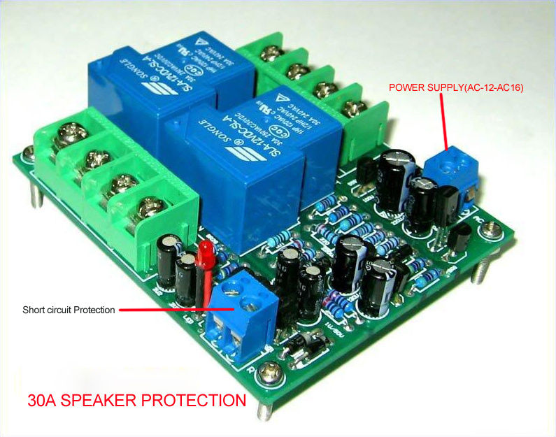

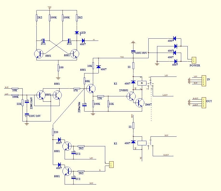

I'm really glad you guys brought this subject up. I recently bought a speaker protection circuit from ebay and it has a short circuit feature. The DC protection works fine but I don't know how to hook up the short circuit portion. Perhaps one of you can tell me how this is hooked up and if it is worth bothering with. I am attaching the schematic.
Thanks, Terry

It's very basic long-term over-current protection but better than nothing, I suppose.
The 2-pin connector near the bottom end of the schematic is used for that. L connects between the upper output transistor's emitter and its emitter resistor on the left channel, R same for the right channel. Protection should engage whenever average current becomes larger than ~0.6 V / Re.
Ebay links don't seem to work on this forum. If you go to ebay and search for "30A Speaker protection board DIY Kit including 7812" you will find it. There are a few folks selling it. The one I bought is item #221255947264. They could not answer my question about hooking up the short circuit. They actually asked me to send them the solution when I get it figured out so they can help folks in the future. 🙂

Are you saying I need to attach between the output emitter and its emitter resistor? One to the left channel and the other to the left channel? Does it matter which rail?
Thanks, Terry

Just had a quick look over the protection circuit and noticed it does not give thermal cut in case modules over heat..also if need be it's timing cap can be changed to speed up on time say to 2 seconds. One, is it's relay 12 volts or 24?
kind regards A.
It's timer part is based round r=68k and 220uf 16 v cap,this can be lowered or lower 68k.. it also makes good use of the flip flop transistor circuit to form indication.
just answered my question regarding the relay volts..popped the glasses on..lol and there 12 volts.
