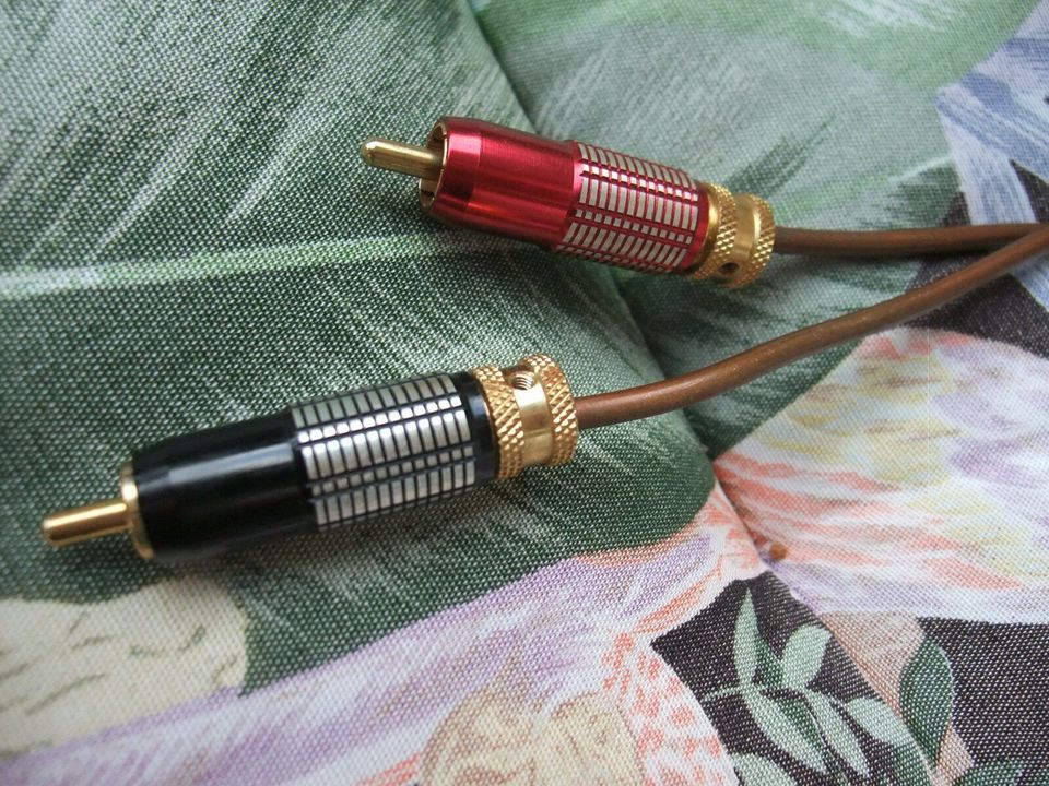

hi guys has anyone tried these plugs ??
AudioQuest RCA-800 Premium RCA Plugs - Pack of 4 | Future Shop
i emailed the company asking for a datasheet, but was refused. the guy emailed me back stating
" Dear Gaz,
They're made from beryllium copper. The plating is applied directly over the copper, hence "direct gold" or "direct silver" plated. None of our connectors use an intermediate layer of nickel."
let me know what you think
gaz

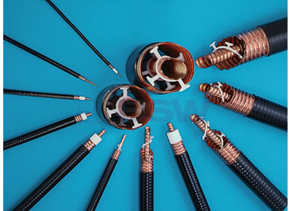

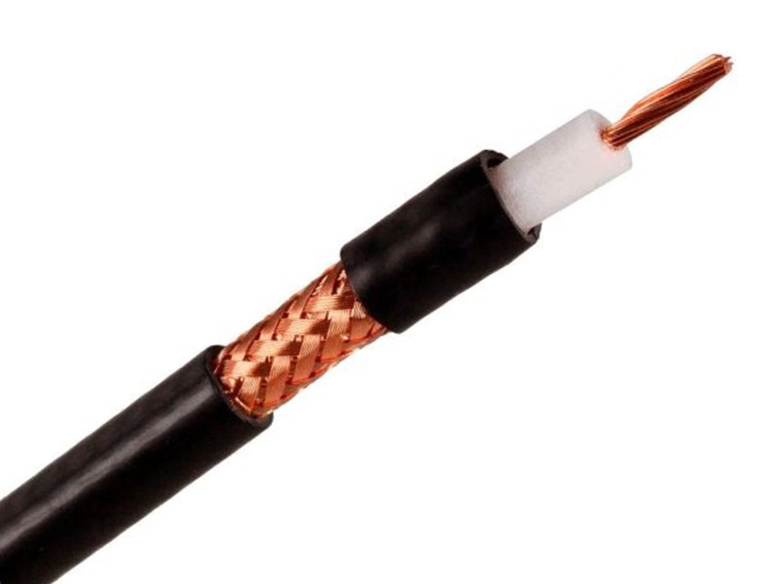

Highest sonic performance you will get only with solid core wires (both inner conductor and screen).
Examples are this one:
http://www.rfcell.com/air-dielectric
and those from images No 1 and 2
A very big disadvantage is the lack of flexibility and the laborious process of attaching the connectors (rca plugs) using only additional short wires.

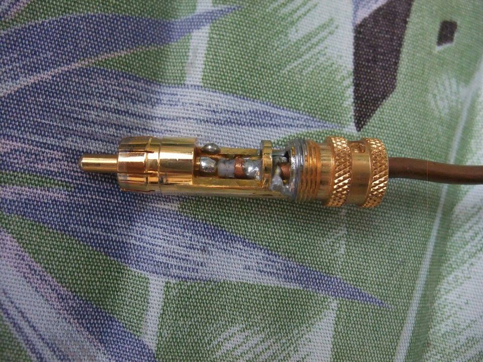

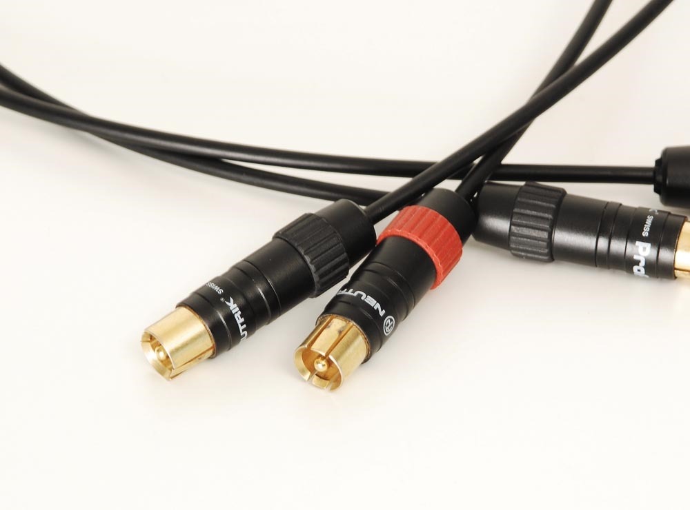

A bit more easy is the MICRO-COAX Cinch-RCA 2x 25cm (Semi-Rigid) - Typ UT-141 - go to
http://www.semi-rigid.com/uploads/cables/images/20110809214439_drawing_UT-141A-TP.pdf
and
https://m.ebay-kleinanzeigen.de/s-a...hnl-isoda-cardas-nf-verb-/1416622896-172-4440
and images No 3-5
The cables that are easy to manage and come closest to those previously mentioned in terms of sound quality are flat line resp. flex versions like the follow:

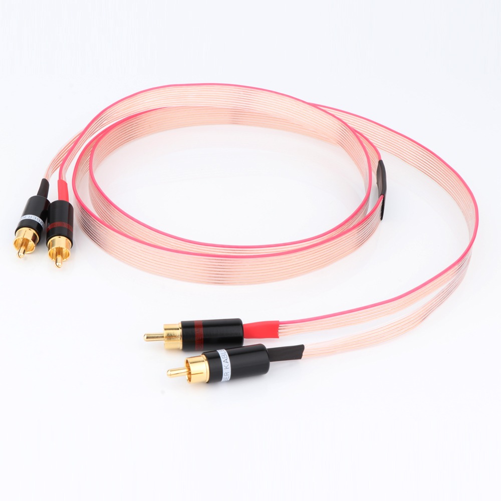

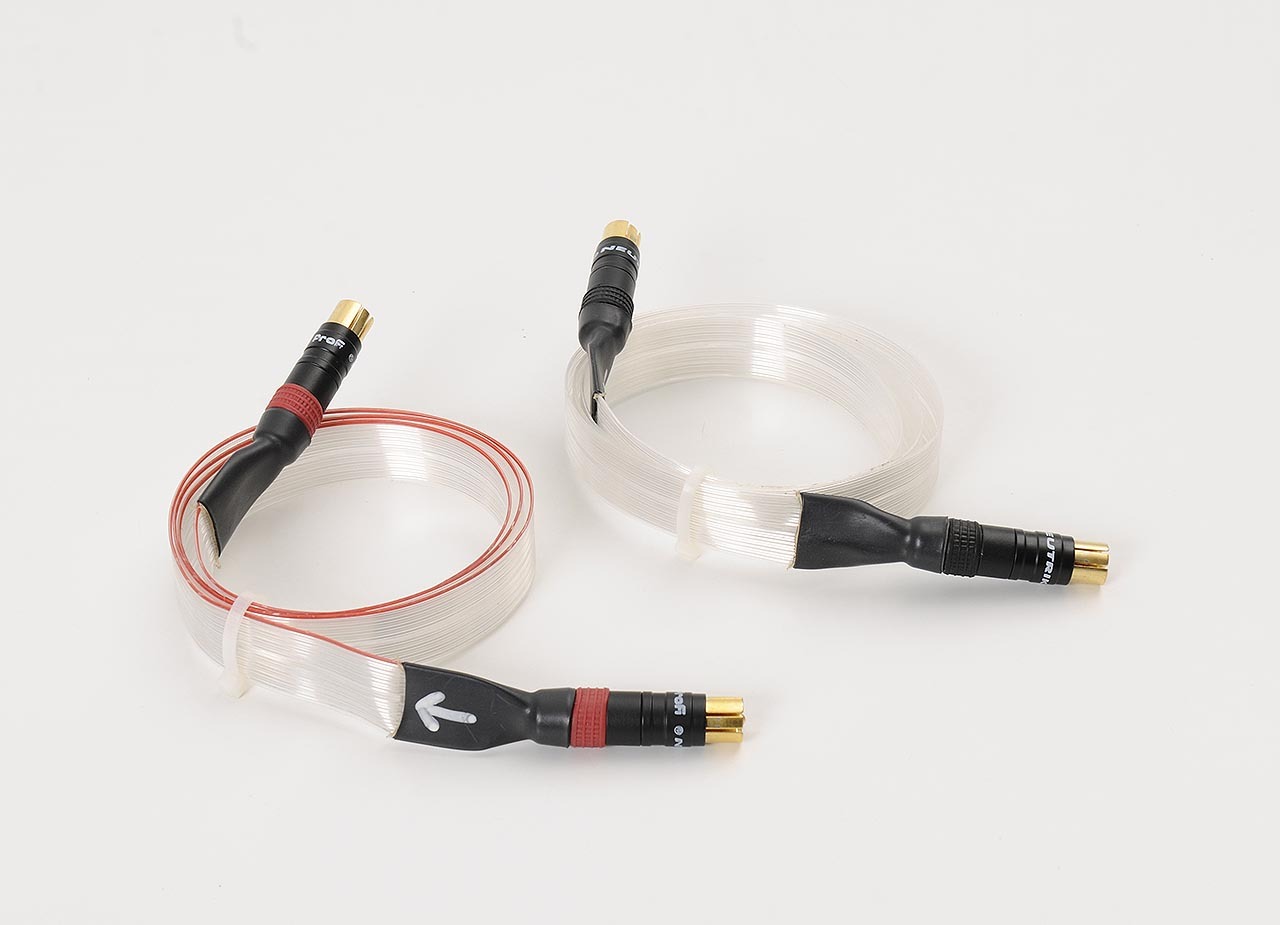

Nordost Red Dawn Flat
http://www.soundstagenetwork.com/todd09.htm
https://www.adverts.ie/cables/nordost-flat-line-gold-mkii-interconnects/2623840
Bastanis Heartbeat I/C- cables
https://www.bastanis.com/audio/cables/interlink-heartbeat
check out also the images No 6-9

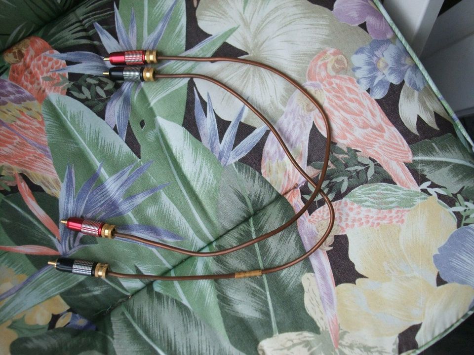

From the flexible coax versions the best sounded I know is the Mogami Absolute Pure 2803 - for sold by the meter go to
https://www.cma.audio/detail/index/sArticle/1811
and review
http://www.highfidelity.pl/@main-586&lang=en
and image No 13 (last image)

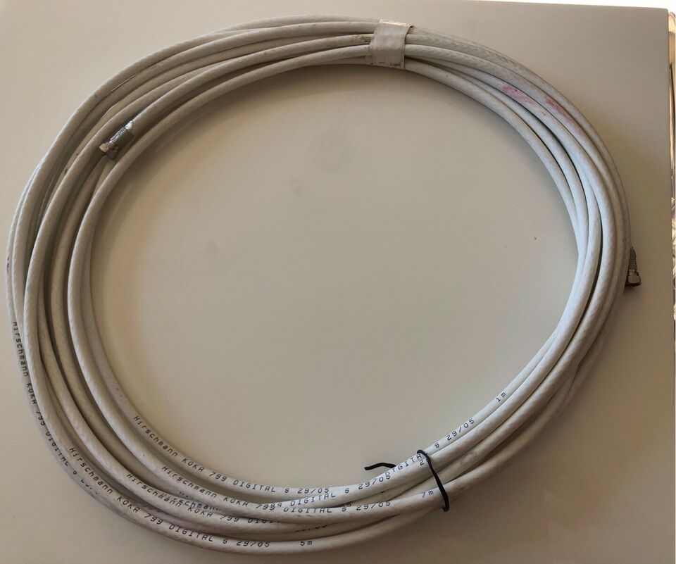

An inexpensive universal coax RCA interconnect cable (e. g. between CD-Player and amplifier or between pre- and power-amplifier) is the Hirschmann Koka 799 - usually used as a connection between satellite receiver and dish (parabolic) antenna (LNC) - go to
https://www.hirschmann-multimedia.com/media/files/298799102 KOKA 799 Eca 100 m black productsheet v17.1.pdf
and Image No 10

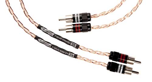

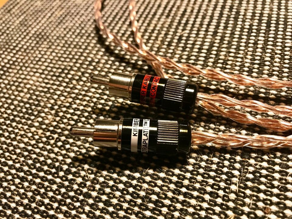

If low capacitance character is important, twisted versions are a good solution like the Kimber versions from Image No 11+12
and
and images No 3-5
MICRO-COAX Cinch-RCA 2x 25cm (Semi-Rigid) - Typ UT-141.jpg174.2 KB · Views: 210
MICRO-COAX Cinch-RCA 2x 25cm (Semi-Rigid) - Typ UT-141-III.jpg164.3 KB · Views: 189
MICRO-COAX Cinch-RCA 2x 25cm (Semi-Rigid) - Typ UT-141-II.jpg131.7 KB · Views: 167
Its absolutely fine to use multi-strand wiring for audio signals, this isn't microwaves... The idea of using heliax for 20kHz is complete over-engineering! Hard and semi-hard coaxs are what you might find in quality RF test equipment to prevent RF leakage affecting performance at 100's of MHz and up. Not needed for audio, unless, perhaps, you are routing past an industrial welding machine for some reason, or perhaps through a working microwave oven? Then it would be needed.Highest sonic performance you will get only with solid core wires (both inner conductor and screen).
What is "sonic performance" anyway? We're talking analog signal propagation at audio bandwidths. This is electronics, nothing "sonic" is involved between the microphone and the speaker. Performance is measured by such parameters as gain-flatness, distortion, noise, etc, general issues with analog signals whatever they represent. Every time I see "sonic" used in this context I get a quaesy feeling about snake oil and marketing.
Heli-ax is the stuff we use to run to our transmitter antenna! The stuff is huge! Like a foot in diameter and more.

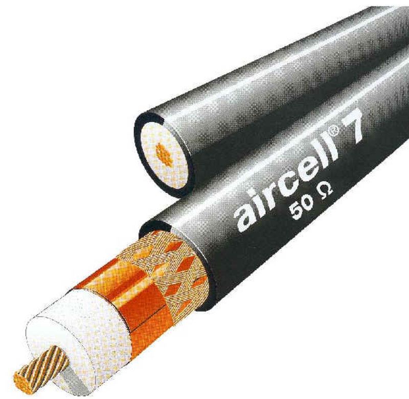

It is also very important to mention that the sound improvements through RF air dielectric cable I mentioned are not audible with most chains - from this view you are completely right. Only first-class combined components (which don't necessarily have to be expensive) make the sonic benefits of such cable clearly audible.

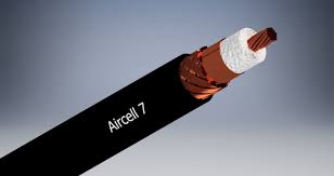

P.S.: friends of me recommend this not expensive RF cable for audio:
https://www.mauritz.de/de/koaxialka...MIicKg0qO-9wIVxIXVCh1SNgSTEAQYBCABEgLJL_D_BwE
unfortunately the manufacturer-URL don't goes open due invalid certification date (I have send an email today concerning this):
https://www.ssb.de/de/koax/koaxialkabel/7-mm/aircell-7-frnc/aircell-7-koaxialkabel-frnc
