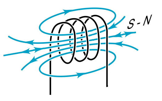

Hello bettersimple,
V = 4.5VRMS
F = 7.83Hz
L = 50mH
R = 140 ohm
I = 4.5V / 140 ohm = 32mA (current in the inductor)
P = Z x I² = 2 x Pi x 7.83 x (50*10-3) x (32*10-3)² = 2.54mW
The power emitted by the coil is near 2.54mW.

This gives 197µV x 3.33mA => 656nWI'm using a 1.2mH inductor with 600 ohm serial resistor powered by 2V RMS.
This gives 3.33mA in 1.2mH inductor => 197µW. (no!, only 197µV)
I obtain best results when the center of the coil is horizontal, and, particularly when the center of the coil follow the North-South orientation....One important thing: I take the coil in the vertical plane so I can see this big "O" just in front of me.
The other devices I know have an internal antenna placed in the horizontal plane, do you think I used it in a wrong way?...

I tried making a simple 555 generator according to the basic schematics but it is very finicky or I am doing something wrong.What I see is that I can regulate it to 7.83 hz -although it varies between 7.81-7.86-but it is very sensitive to power supply and load changes so that if you connect a different load it will change quite a few hertz.Also connecting it to a cancelling coil or transformer there is no way of regulating the squarewave at exactly 7.83because you cannot see it on any normal measuring equipment.Plus it seems to overload i.e. 500 ma at 12v on a normal cancelling coil /tx which should present an infinite impedance right?
Hi protos,
Don't you try to put a buffer between NE555 and your coil?...Also connecting it to a canceling coil or transformer there is no way of regulating the square wave at exactly 7.83 because you cannot see it on any normal measuring equipment...
Well, I guess it is the next stage.But since Allen mentioned that the 555 can drive the coil directly I tried it this way.Actually it can drive the coil at a low power supply voltage around 6V and with a capacitor for any dc where the current on my supply shows around 150 ma.I just thought driving a bifilar coil there would be minimal current draw since the load presents a near infinite impedance at the frequency.I do not understand it. Obviously loading the output with a series resistor would mean that the voltage over the coil would go way down since it is only like 1 ohm.I wonder what Allen's set up is? Allen?Hi protos,
Also the 555 schematics do not mention that F is dependent on load/current.It is just an equation of R and C.
OK it works better with a simple mosfet follower.
However the current is too high.
The coil has maybe 1 ohm resistance and I am using a square wave of a couple of volts.This means that the output is quite few watts.
So I see the transistor needs a good heatsink.
Unless ofcourse I pad down the output to a few hundred millivolts.

Limiting power emission
Hi protos,
In my realization, I limit current with 560 ohm resistor in series with 1mH coil.
I kept output tension (560R + coil) at 2V RMS. The output signal is a sinewave.
Hi protos,
So in fact the voltage over the coil is minimal, right?
If we assume the impedance in the coili s no more than 1 ohm or thereabouts then it forms a divider with 560 ohms bringing the voltage to around 4mV over the coil, correct?
