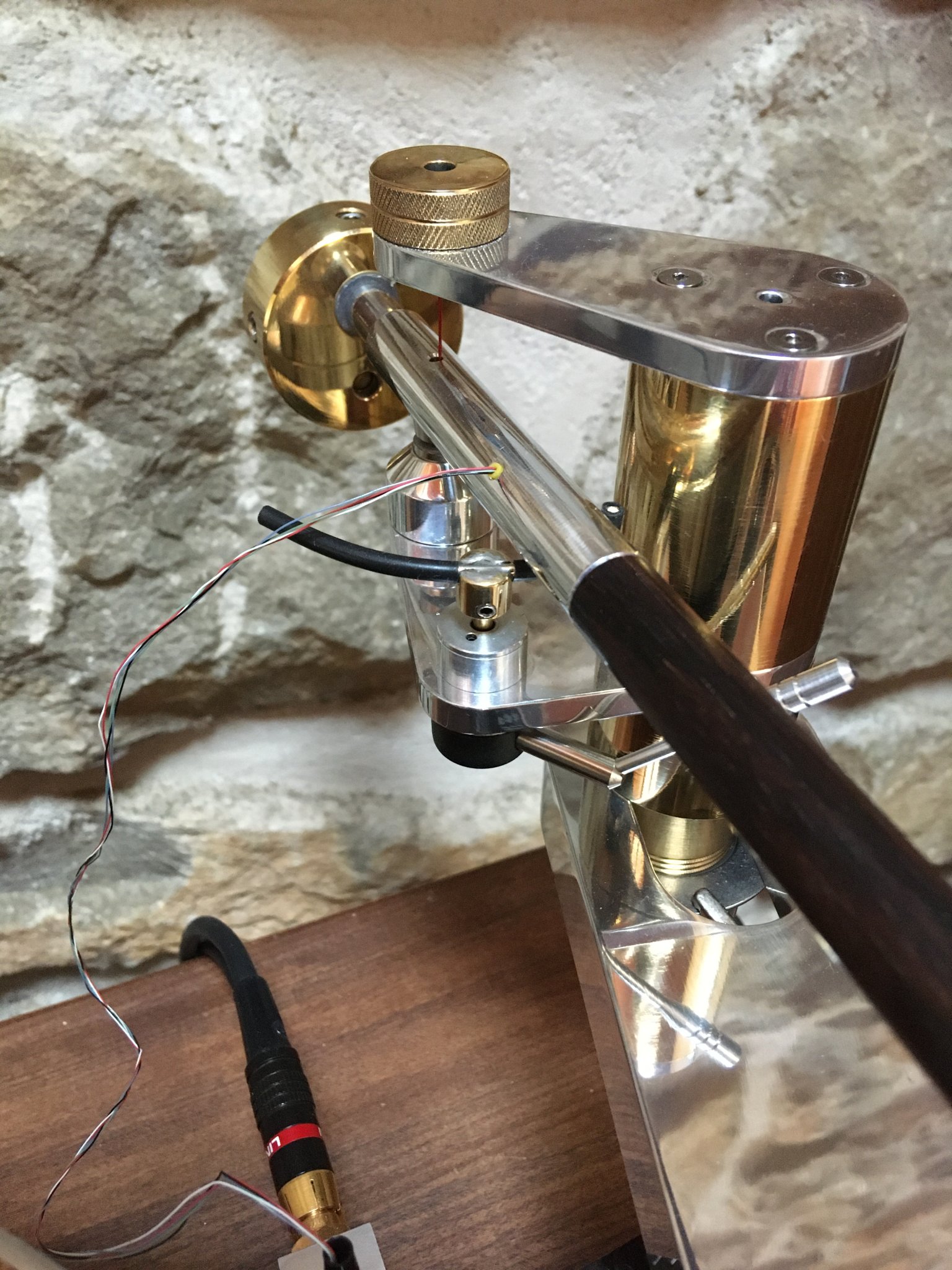

Mine is............... cartridge with aluminium screws- head shell plate ( Titanium ) - head shell plate screw ( Titanium ) Headshell ( aluminium ) Rosewood arm wand- aluminium bearing section- Brass counterweight isolated by silicone tube from the arm.cartirdge —> Headshell plate (Aluminium)—> headshell plate screw (steel) —> wooden arm tube (Mahagonay for example)—> alloy tube with bearing —> decoupling element (Silicone or other material with currently unknown specification) —> counter weight (copper or brass or …)
The tone arm wire runs inside a fine PTFE tube which in turn runs inside a fine brass tube inside the wand.
The wand was soaked in oils for quite a time to help towards deadening any resonance inherent in the wood.
The element at the top of the suspension thread that contains the adjustment grub screw is held in place by an O-ring with a strong interference fit in the hope that that too adds some damping to the arm.

Did you experiment with the headshell plate and screw? What was the reason you ended up with a titanium screw and not an aluminium or steel one?
"Brass counterweight isolated by silicone tube" - currently I use a copper counterweight. My first test will be a counterweight made of brass. And I want to try out different silicone and Polyurethane tubes of different shore levels.
I did not experiment with the head shell plate and screw as I know I wanted Titanium from the start. ...rigid ,lightweight and non-magnetic . The entire arm build is non-,magnetic ...all fixings are either titanium or brass .
I chose food grade silicon tubing for its softness....I wanted as much damping as possible and thought that the greater the Shore value the less the damping factor.
