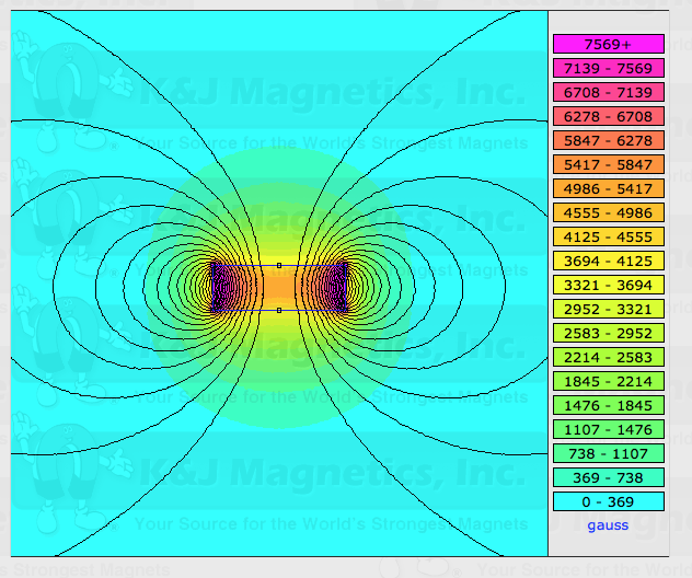

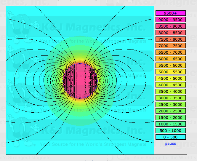

Here are the evidences that ball is better. The magnetic force for a ball is more concentrated at center of the ball. For a magnetic flat disc, its magnetic force is mostly on the edge.
Those images don't show what happens when two attracting magnets are in the field. They just show the isolated field and not the interacting fields. It would be interesting to see such an image.
You need FEM software. femm.info
Beware steep learning curve

I do start out with cylindrical magnets. If you're using two spheres, you will almost inevitably create too stable a bearing, meaning that the VTF will change A LOT when changing VTA.
Try one sphere and one cylinder... but the key problem with a sphere is always to locate the exact center of the pole when mounting/fixing it.
