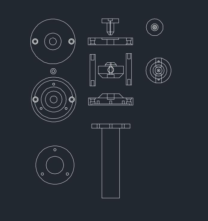

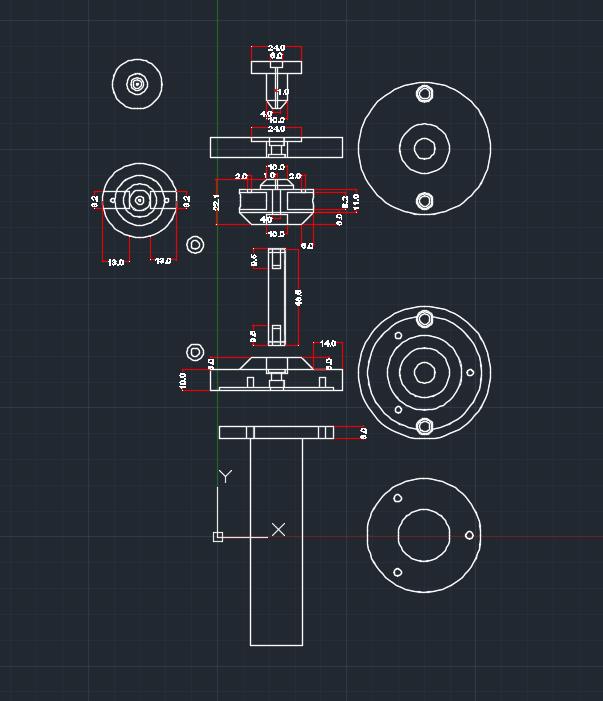

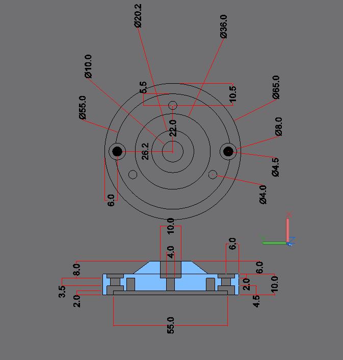

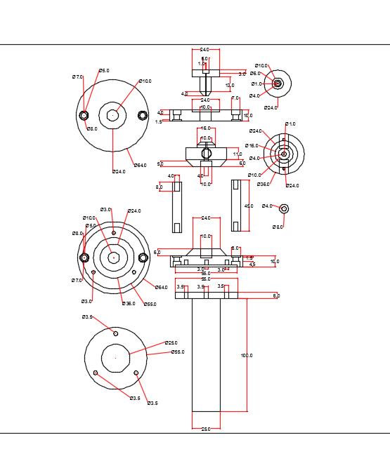

Hi suwaned,
I really liked your approach, since every part can be constructed using a lathe (I own a lathe but, unfortunately, I don't have a mill yet). I also watched you video on youtube - great job!
Could you please send me the drawings that I saw in your video? It would be of great help.
Evangelos
Hi suwaned,
Evangelos
Hello,
thank you for your appreciation.
for parts of TA can be using by Lathe, this is awesome circular construction ( helpfull for lathe) of Magnetico _Attitube. for headsheal need a mil, but this not fixed.
i have a drawings of my project, but this is not fixed because there are parts that I adjust to the existing constraints at done, error and try ... some parts 3 times do it.
Best Regards
ed suwan
