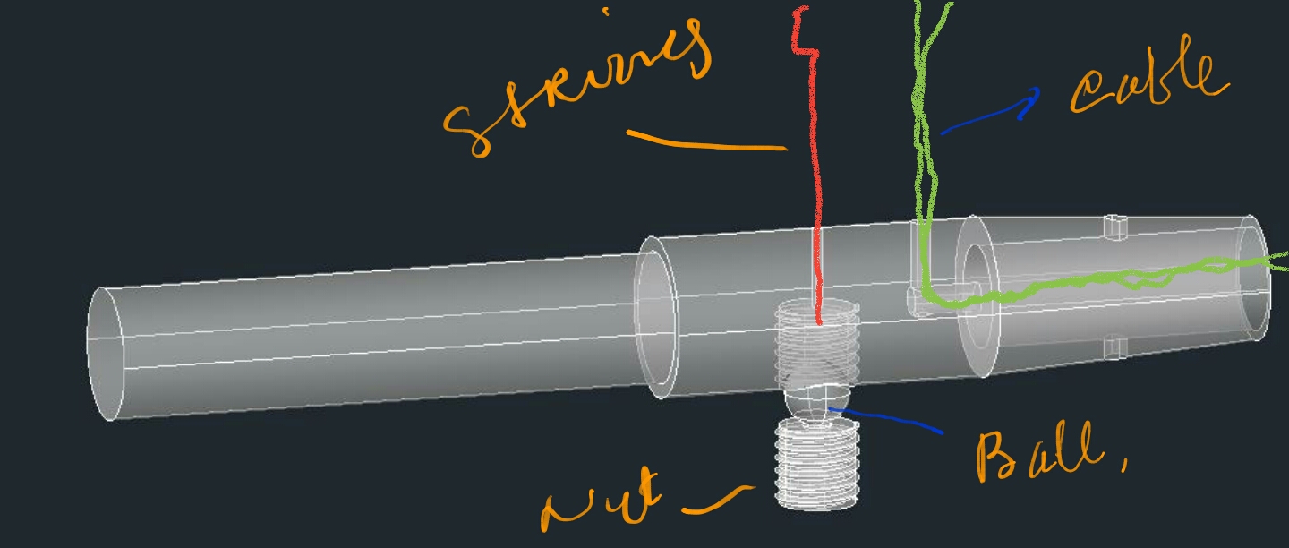

I had to use steel ball pivot to clamp the string with a bolt.
to a position above, I give a small bearing to prevent twist of string. quite helpful.
