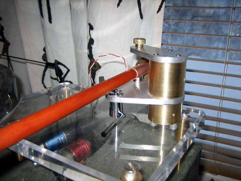

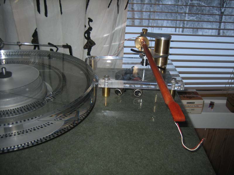

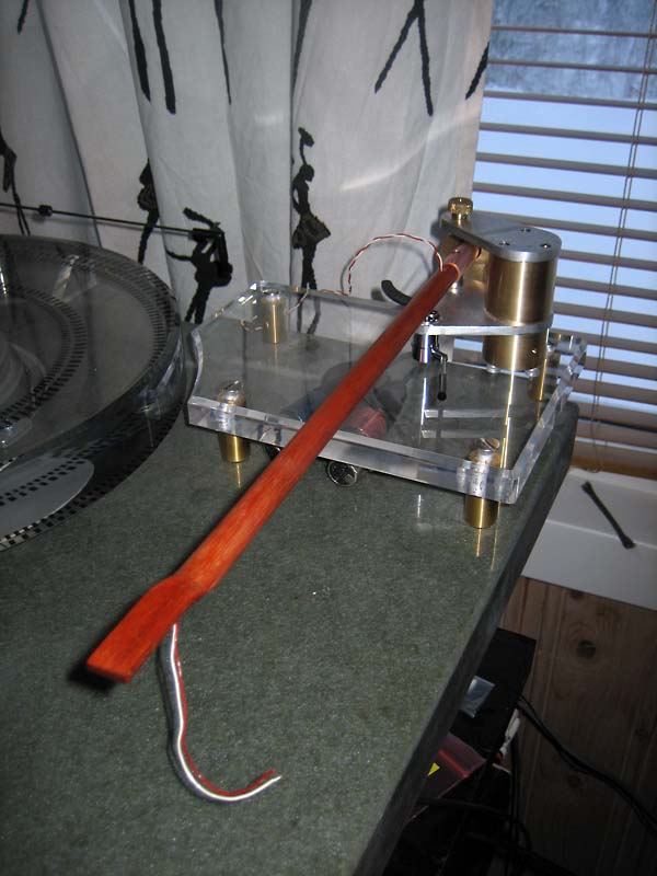

Just about finished, very pleased. Total weight 365grams, suspension balances nicely on the little Thorens TD150.
Not sure what the sonic effects of Delrin will be, but will find out within the next couple of days when the tonearm wire arrives.

I have had a few days to get acustomed to my TD150 with its new arm, i am using is a Denon DL110 cartridge, and it seems a good match to the arm.
Very happy with the sound quality, definatley taken the little Thorens to a new level.

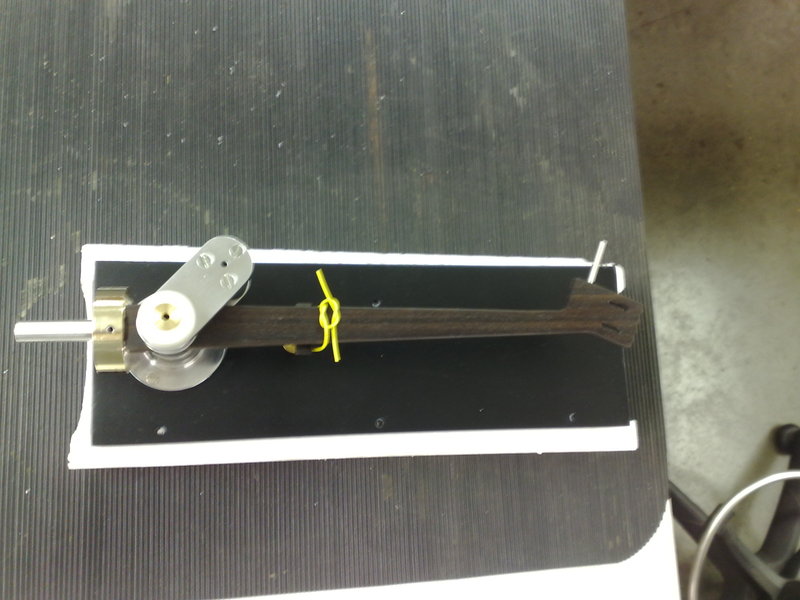

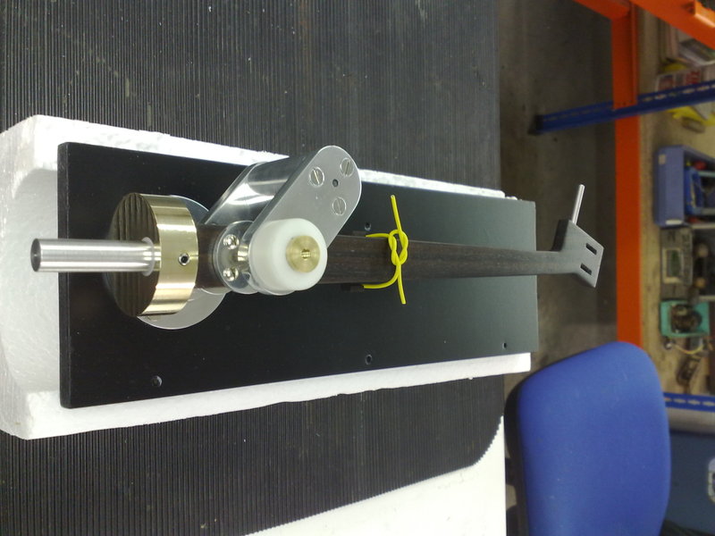

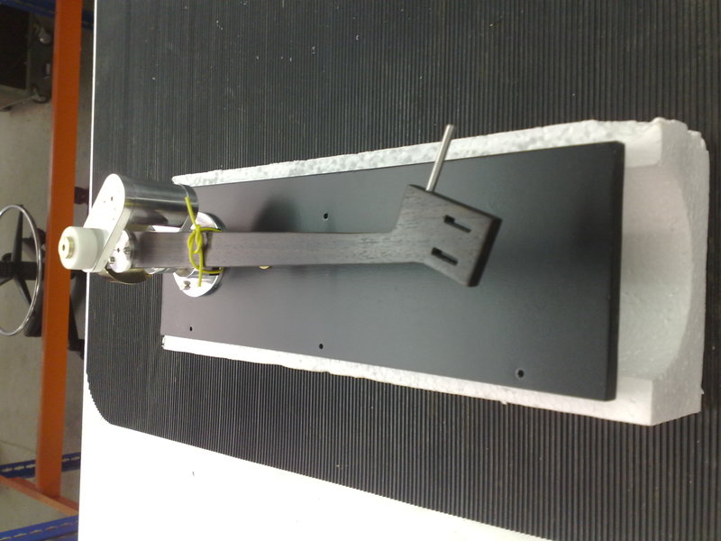

Hello Ron,
The denon DL110, works very well with this tonearm, both seem to compliment the Td150, sound is very airy and open with good spacial quality, and firm authoritve bass, though not as deep as my PTP Lenco.
I guess the effective mass is around the 16 gram mark. I will try get a couple of photos posted soon.
I am toying with a 12inch version for use on another Lenco project i am working on though i am undecided on what tonearm wand shape to use.
This flat tapered section armwand is earier to make, especialy the upper magnet carrier counterweight section, which i found difficult though not impossible to get perfectly true with a round section wand. And maybe the tapered section is less prone to resonate than round, i dont know but sound quality is very good indeed.
Cheers
