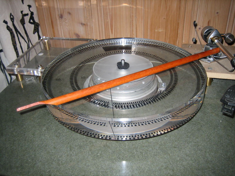

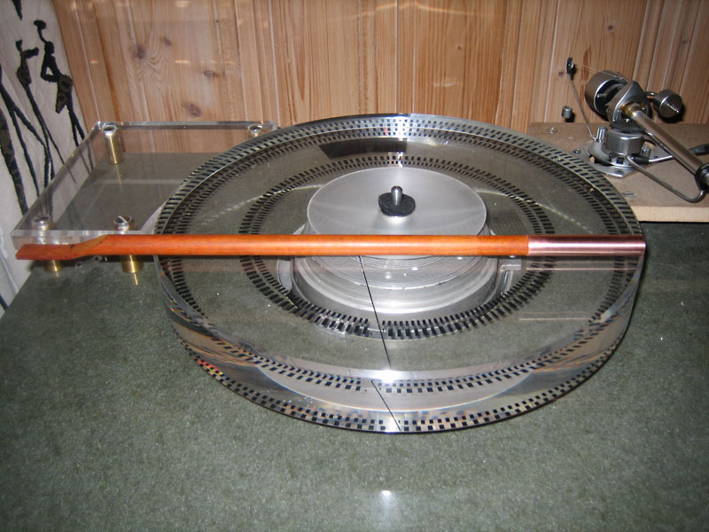

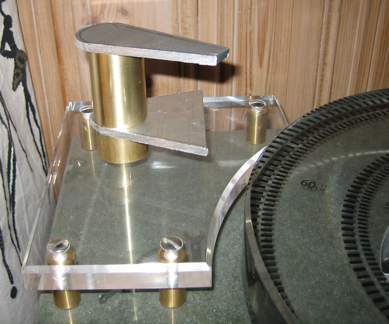

More progress tonight. New bottom magnet block, new piece machined for top piece that holds the top suspension. Now the next thing up is to bore a second arm wand!
I think I will try to reuse the old headshell, and I will probably insert a short piece of CF both ends to help strengthen where the wood meets the metal. Hopefully that won't affect the performance of the arm.

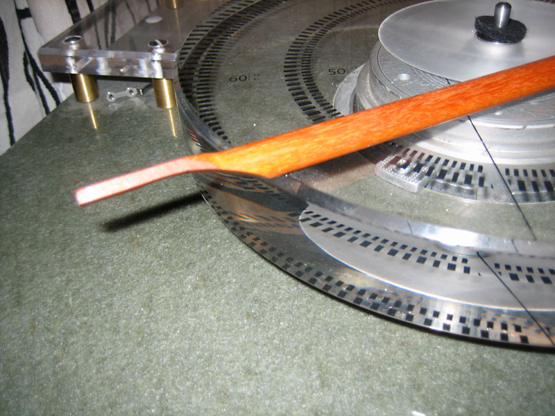

A new paddle for my diy turntable...
A few years ago I got a cocombole stick, and at last I've got the chance to start working on it. I have a long way to go, but I have at least done a little.
It is nice to have found this thread, a lot of questions answered already, and a lot of problems solved (I think). But there sure will become more of them.
Just to keep things hot, i have fabricated some of the metal parts for a lightweight version, for a suspended subchassis TT, i am trying to keep the weight down to a minimum, so i have used delrin in places instead of brass.
Just the armwand to make.
