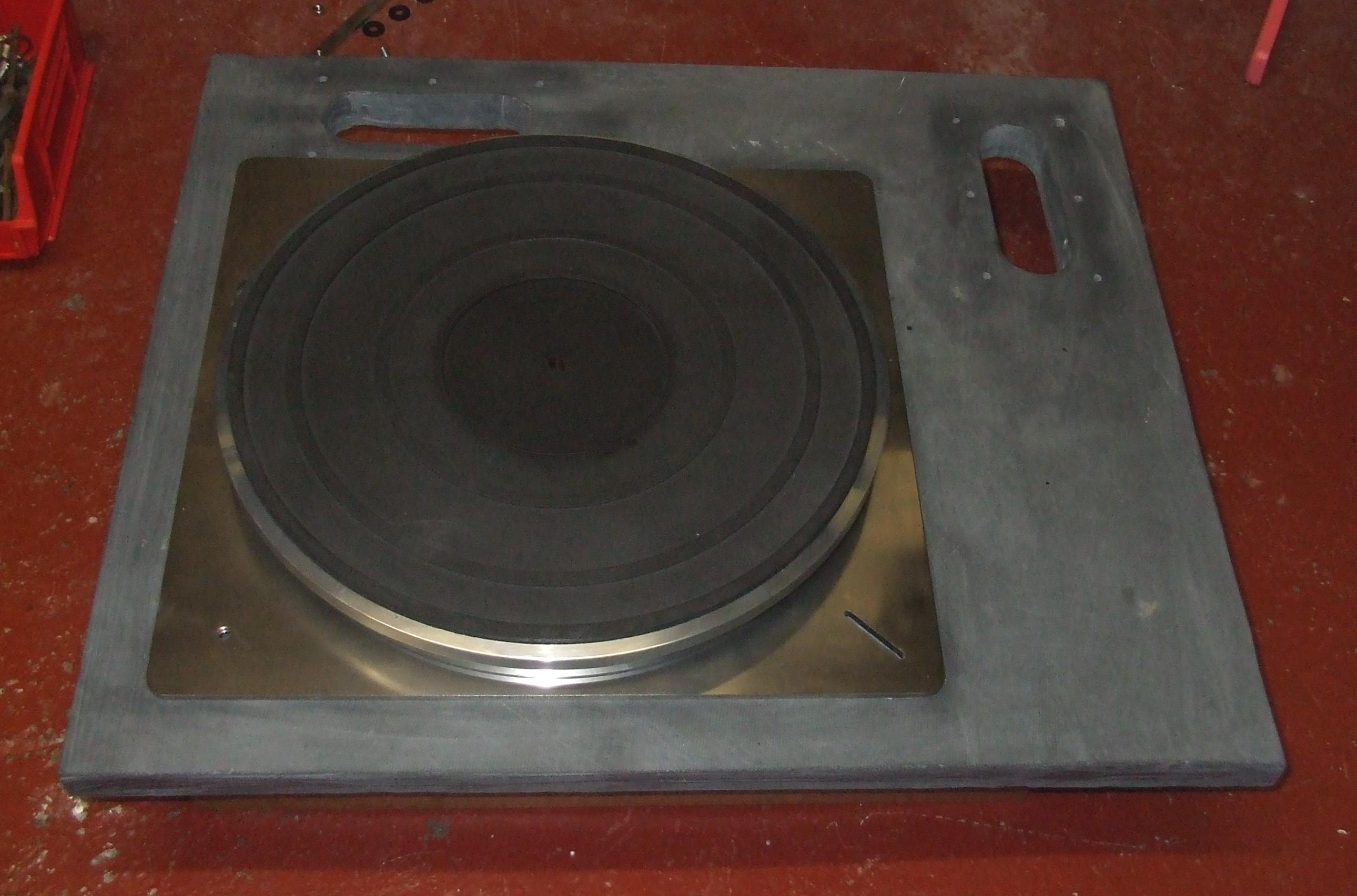

Just as a side note, this is the turntable the arms going on. I still need to smooth the edges of the slate, make some feet and then oil and polish. The arm making has kind of been all consuming for the last month or so.
Plus the arm construction is much more fun than grinding away at a piece of slate with a file.

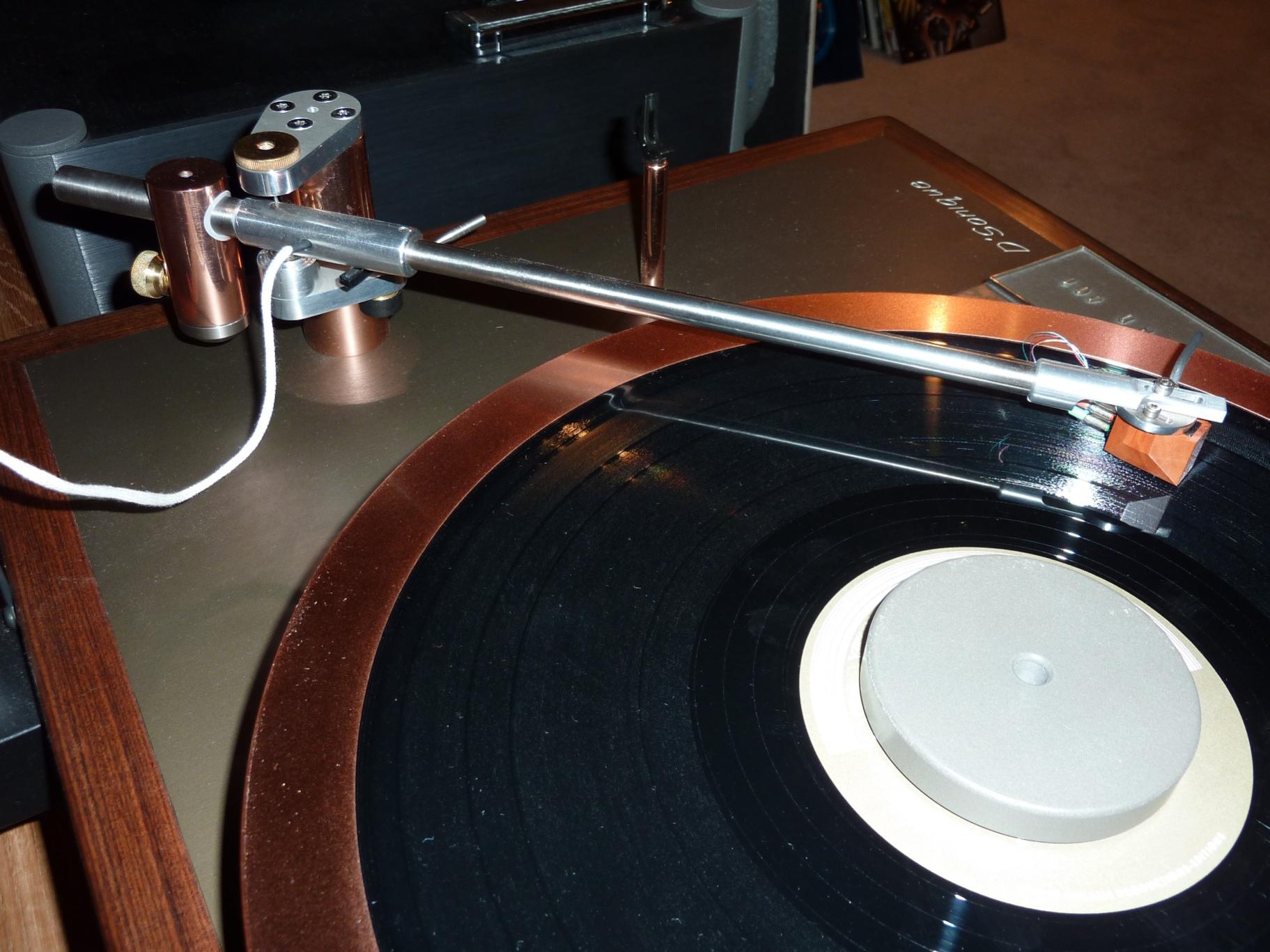

Is that a slate + a dutch top plate on a Lenco? I have the same an am so impressed that my SP10 is getting a new slate home!! (Anyone need a Technics obsidian plinth??😉
Hi Jeff,
Glad you like the sound! 🙂

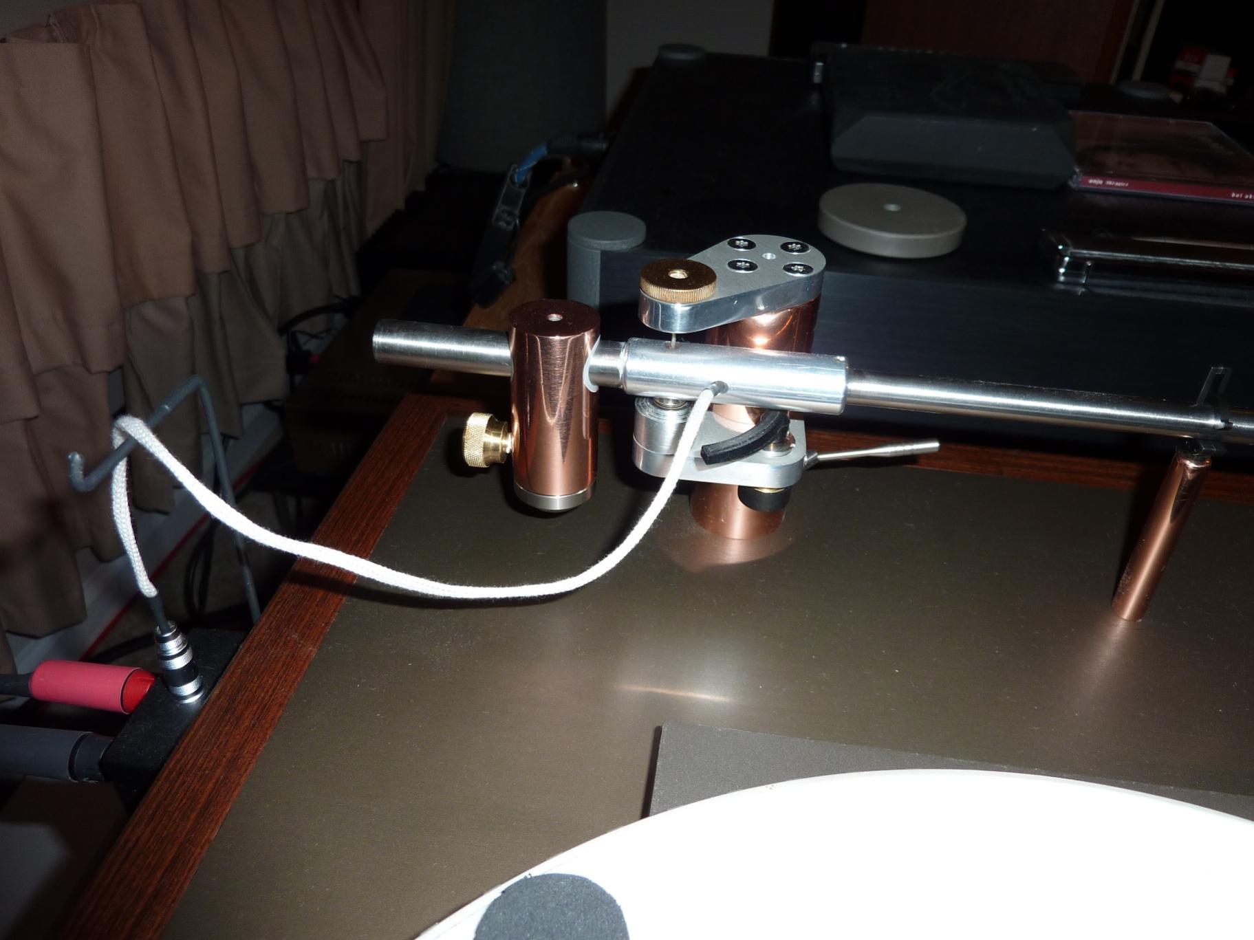

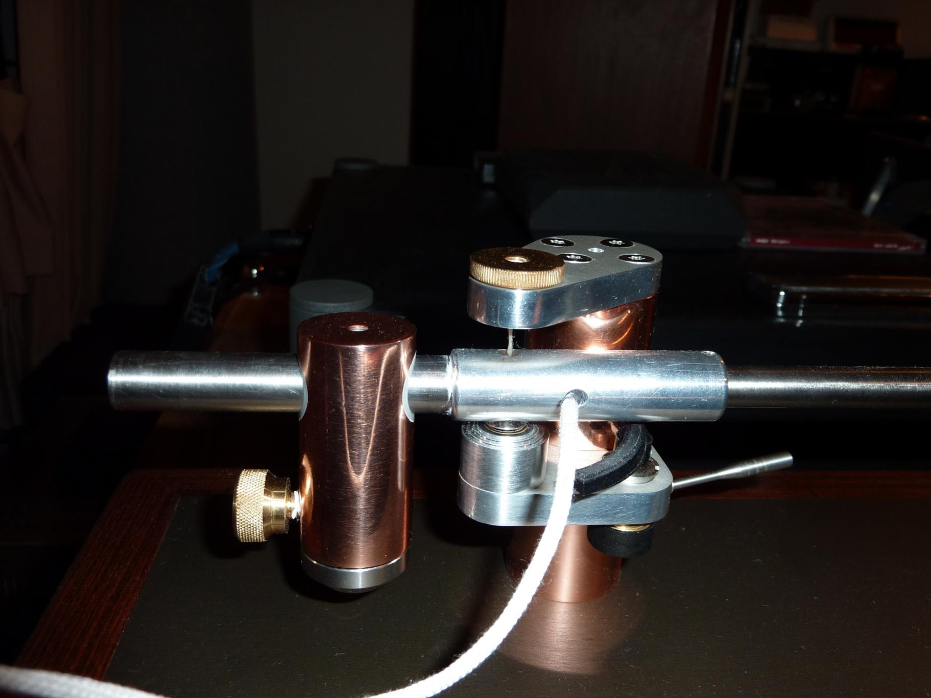

The COG of the counterweight seems to be VERY low now. Just make shure that the resulting restoring force isn't too high. When you're changing from 120gr to 180gr pressings, the VTF should increase by no more than 0,05gr.
Enough of the technical stuff, just enjoy...

Lastly, Vectran is a very good choice for the suspension thread.

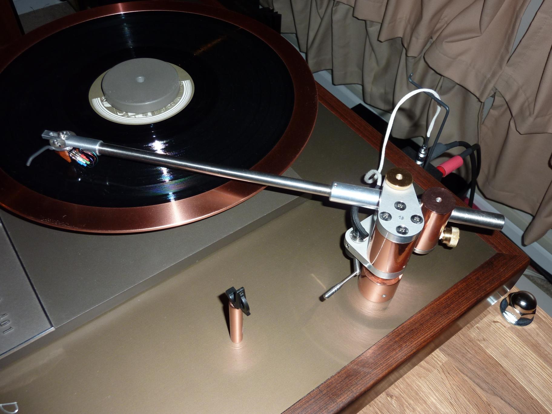

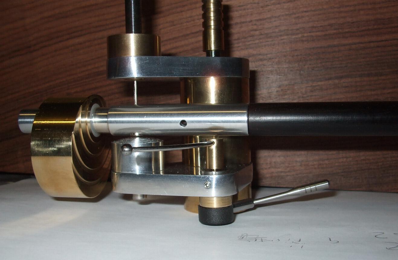

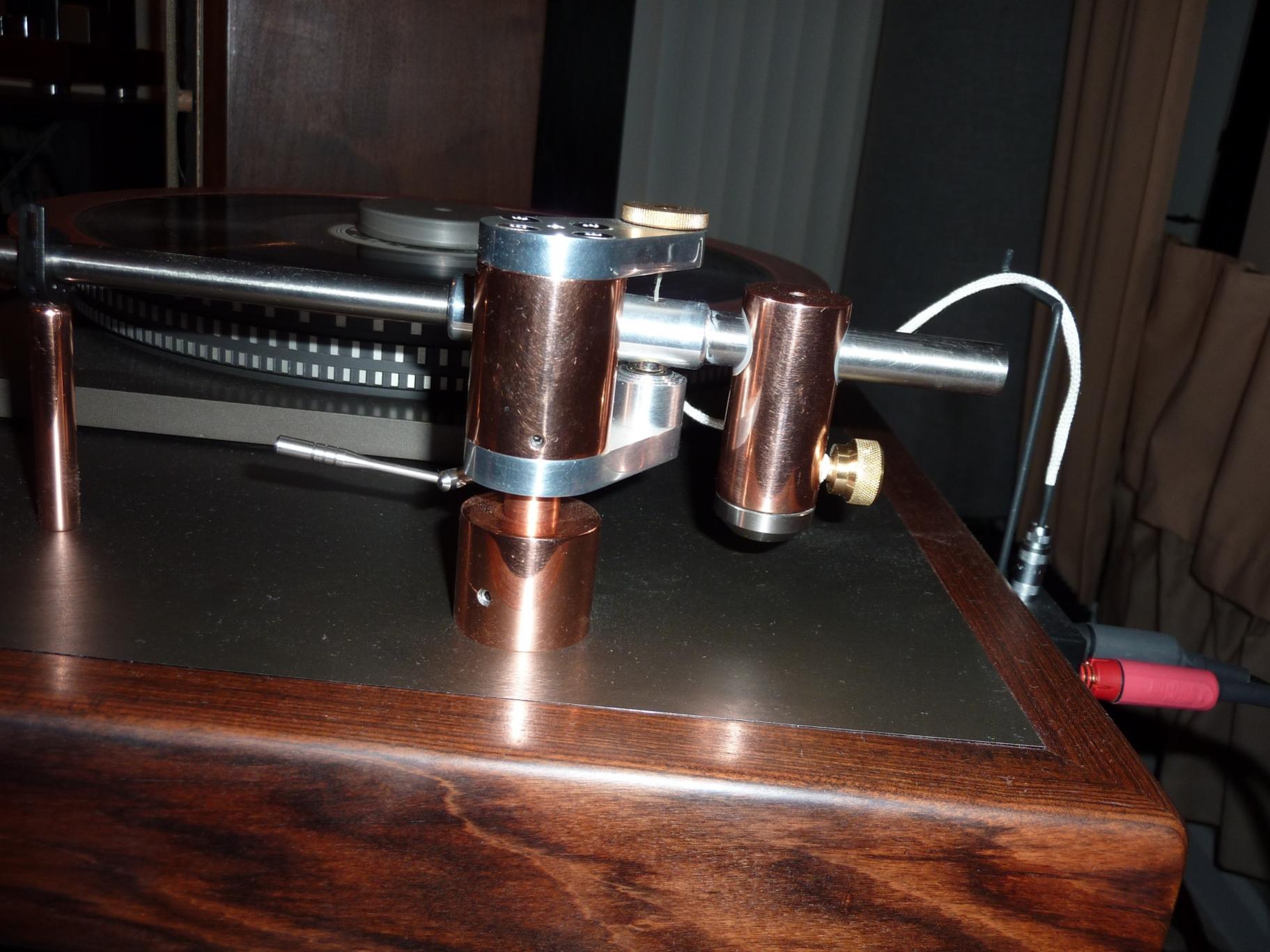

Revision 3 of my counterweight.
Raised the CG up a bit by reconfiguring the hung weights and added a fine tuning weight at the rear. No flop on this one, and the fine adjustment makes setu a lot easier to dial in the weight keeping the arm / string alignment and without upsetting azimuth (once set). Now playing record after record after record...wife thinks I'm crazy.

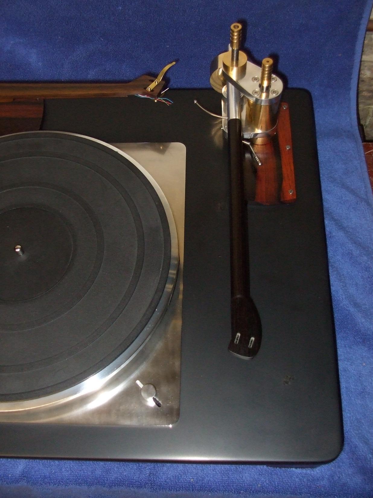

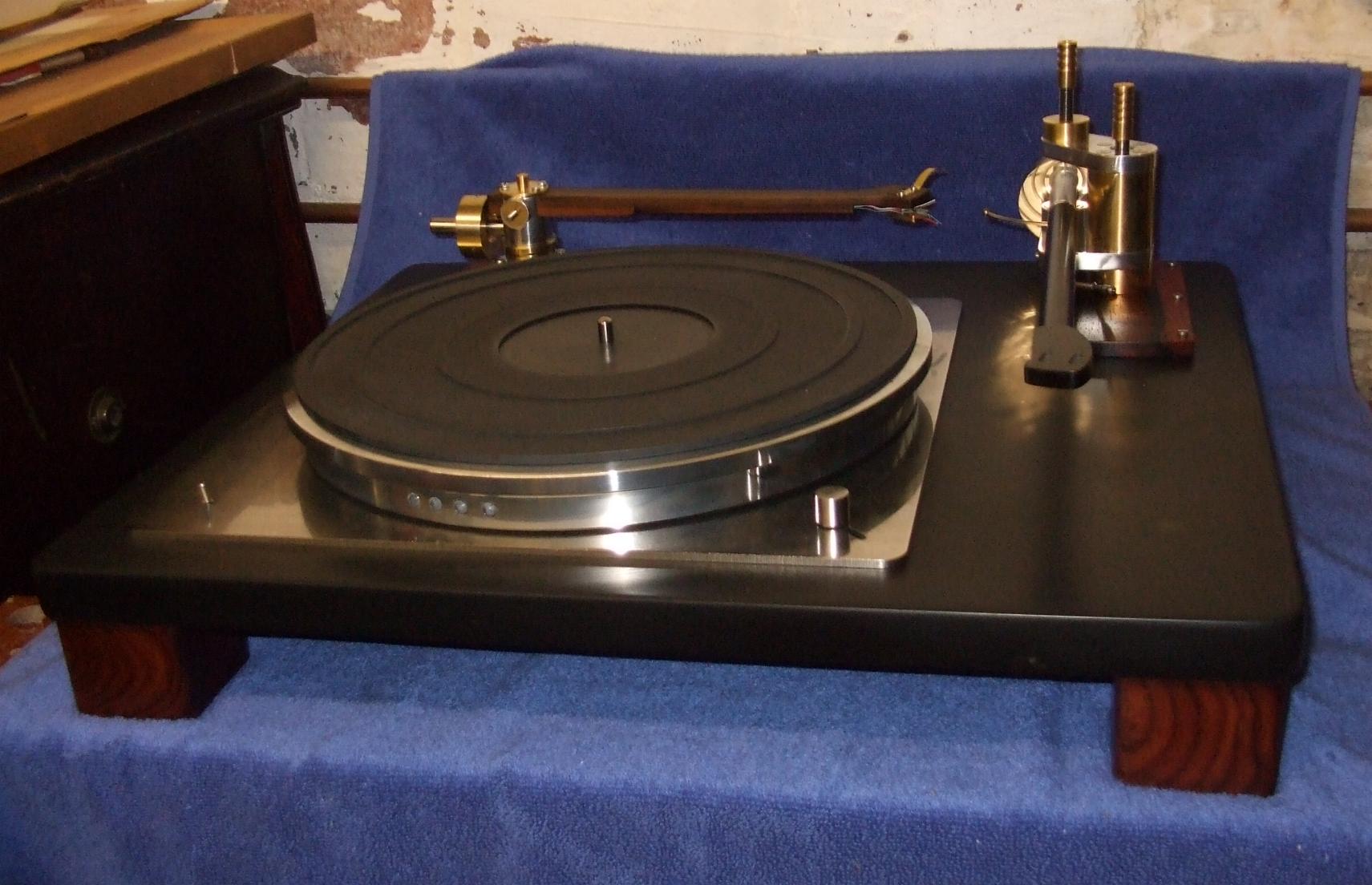

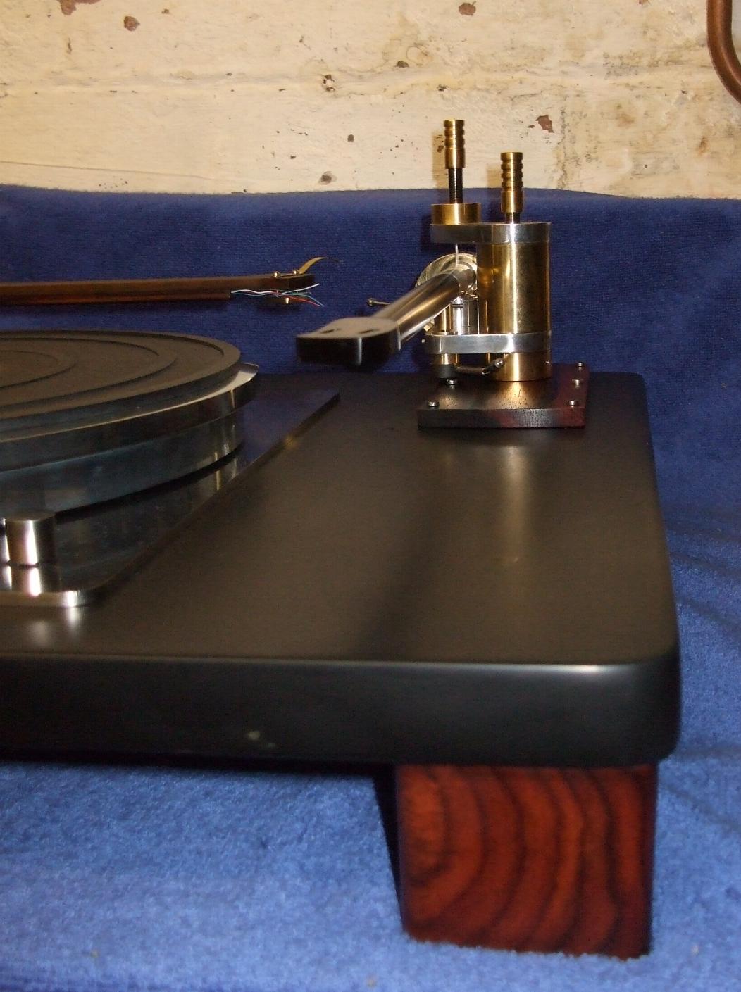

Schroder clone
The Vectran thread arrived today, so just spent the last couple of hours threading the suspension and fitting the magnets.
I used J.D.s Vectran threading method with superglue, the fibres are very fine and extremely tough.
Very pleased with the results, no tendancy to rock sideways even when provoked, very smooth, friction seems extremely low, a slight breath of air is enough to move it when balanced.
Just the wireing to do, i have some 0.15mm solid silver, silk covered i am go to try.
Thanks for your suggestions and help.
