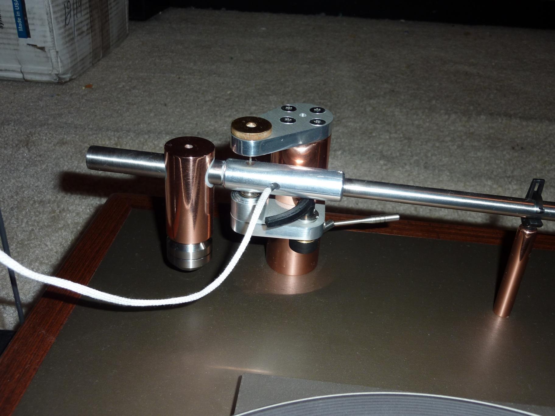

HI JD great work !
can be to much wire that arm drag on ?
absolutely no drag... the outer cover is a very fine silk weave, virtually less than the weight of a feather and the wire itself is four strands of Van Den Hul MCS150 Silver which also is exceptionally light and very very flexible...Also the wire is teathered at the back of the plinth so there is no drag.
End result is that there is no real resisance to interfere with the free rotation/sweep of the arm.
JD

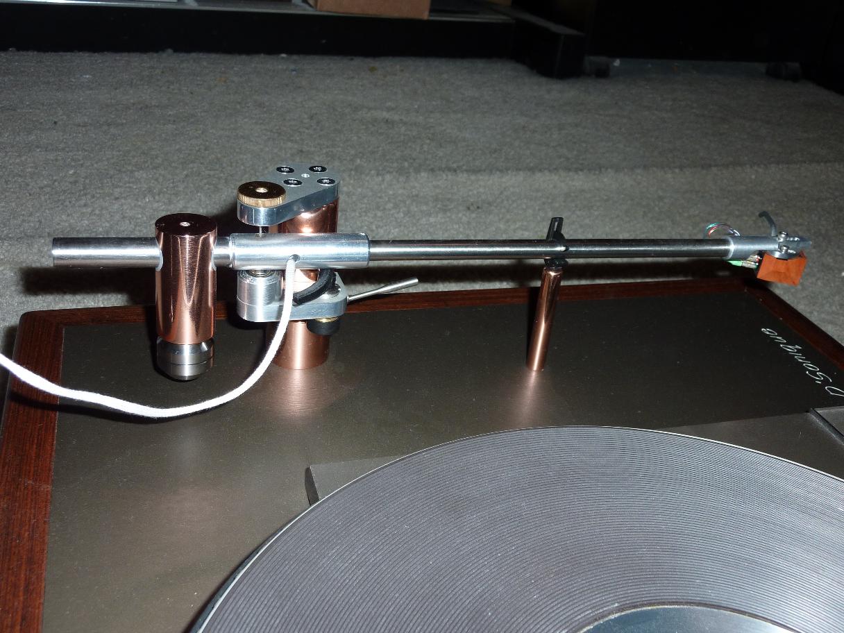

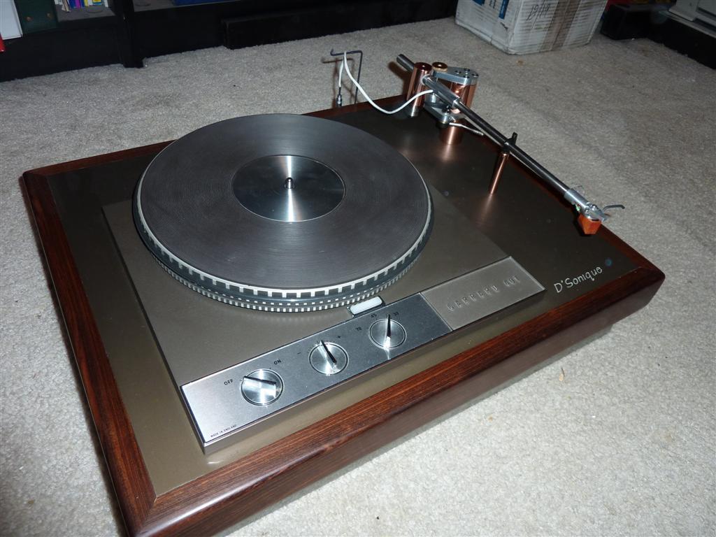

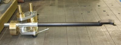

Hey guys! how'd we let this thread get to the 2nd page???
Anyways... Here's new pic of my arm. I'm still learning the in's and outs of my new camera.
Frank.... took your advice and changed up the counterweight so the CG sits much lower.
I also incresed the weight from 170g to 240g to be able to bring it closer to the pivot point.
This definately aliviates the flop left/ flop right problem of the out-rigger system I was using before. Tracking force is set for 2g and it measures constant across the entire surface of the record.
Monday I will bring it from my workbench and put it into service in my system.

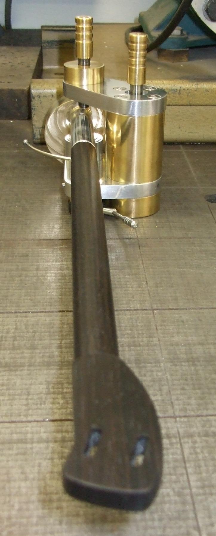

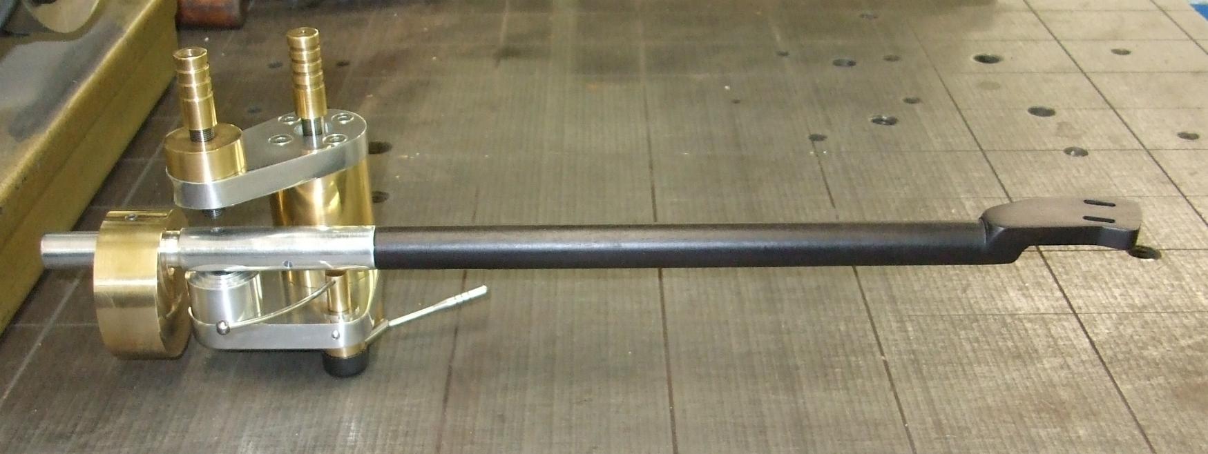

Got my ebony wand wand finished, so just wireing, suspension thread and magnets to fit, should be up and running very soon.
Couple more shots...

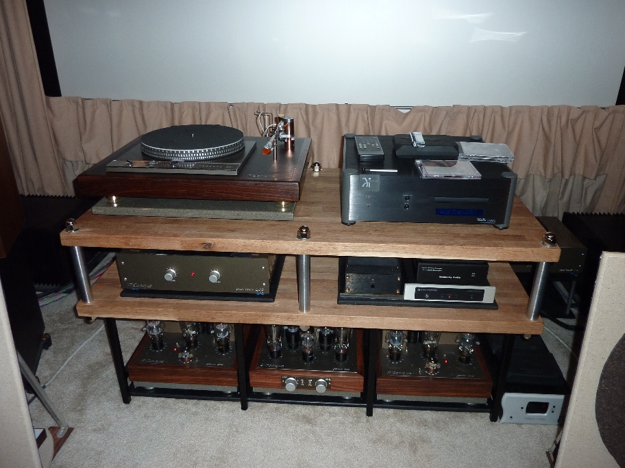

Man oh man... even unbroken in the sound is in a league way way above the old DL103R.......
I can never thank Frank enough for the help.
Jeff Davison

ebony wand
Thanks,
I did try to out source the wand, but thought i would have a go myself, it was much easier than i expected, i used macasser ebony AAA grade, not as brittle as the African ebony. The hardest part was cutting the slots for the cartridge.
At the moment having trouble sourcing some suitable suspension thread, was going to use Kevlar, but can only source the spun variety, not the filiment stuff, plus unsure what thickness to get.
Anyone know if the spun kevlar is strong enough?
or any alternatives?
Thanks.
