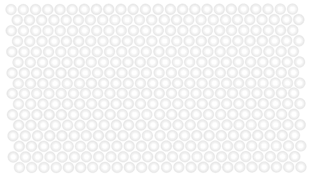

here is a good helpfull site on building a rptv http://www.toppan.co.jp/english/products_service/business/optronics/fcscreens/
i also have an idea if you can find a big enuff peace of grey tracing paper and put it on the back of a peace of plexi glass i bet it would work great, and maybe a real light window tint on the front of the plexi glass to block some light from going in.
I dont know if this was said because there are like 15 pages, but to make the light more even, could you try putting a fresnel lense in between the back light and the lcd, kind of like on an overhead projector?
SkullKeeper, do you know where those screens can be bought in the USA? It looks like the type on the newer HD Tv's rather than the older type that had the ridges on the outside.

Some years ago, Tomorrows World, a BBC technology program demostrated a product that one of the universitys here in the UK was creating. I think it was Cambridge university, anyway the plastic film was placed half over a casio 2.5inch tv and the difference in quality was amazing. The plastic film was created by etching micro lens into the plastic using a laser. The process to give an image is very similar to collomation lenses, but on a microscopic scale. Now I have searched the net and not found anything to do with this, but someone must know what happened, anyway IF we could use a large scale injet printer to print some sort of polymer on to a clear acrylic sheet, the result of which would be a dot of liquid, which would dry and if I am correct it would pool in a lens shape. This may or may not be possible but if it could be done it would create some stunning rear projection screens for DIY RP tv`s. The beauty about this was the fact that it gave NO hotspot and when off, the plastic was opaque, which if you placed it on a window, the window would work as normal, but when an image was shone onto it via a projector, it would be displayed on the `screen`, and it worked as a FS screen too which would allow normal projection, but with higher brightness and contrast AND you could look directly at the projector light beam, as long as the screen was between you and the projector, which resulted in a bright vibrant image. The program aired circa 1986. The attached image is of what I can remember of the layout of the lenses

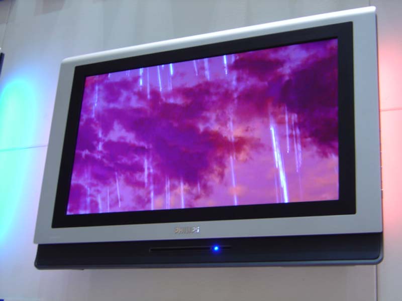

I found a great screen for you guys!
screen be here
I saw this and said "gotta show the guys on diy in case they need it"
