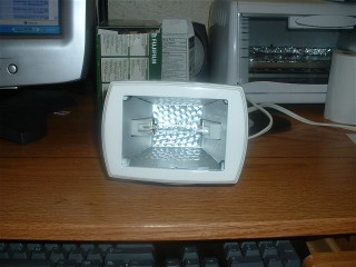

Im using a 50 watt halogen bulb for my light source, but its only for test purposes and after using that bulb I know a 75 or 100 watt bulb may not be enough to light my projector, so I might use one of those halogen worklight bulbs at least 150 watts with a aluminium reflector made from a soup ladel. A condenser lense system from surplus shed will be used to focus the light, this system consist of two lense that are 70mm in dia. it also has a heat filter between the lense to reduce heat. Or I may just might make a system using two PCX lense which will be cheaper.

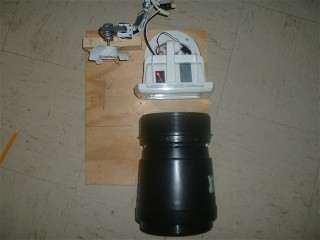

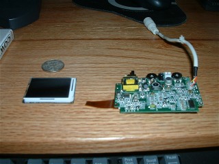

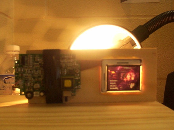

Here is a picture of the lcd and the controller board, but the picture did not come out clear, I will have to buy another camera that takes better pictures. I'm not sure if this lcd will work, the resolution is great but, it is hard to find lenses that will magnify the lcd enough to fill my screen. The lenses I have found so far will only magnify the lcd to fill a 20" screen which is only half of what I'm looking for. If anyone is looking for 1.8" LCD, I'll sell this one $50.00. I paid $72.00 for it, I still have it's casing, backlit and speaker if you want it, they still work. The lcd will be great for front projection or car tv.

btw. would you pls. post more images of your set up the picture quality doesn't matter I'm more curious about the actual setting of your project. Thanks

I have lens asembly out of lcd projectorsa which use three small lcd's these will work for your 1.8" lcd also.

dbc105, I got that lense from www.surplusshed.com. It is the same fijinon lense people are talking about.
