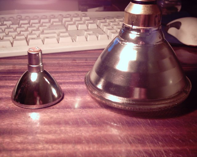

I agree that the parobolic reflectors are best for parallel light raws and that is nothing new, BUT there are alot light we can´t use with the parabolic reflector, there for is the elepticalreflector a better choise because we can collect more light with it and yes the rays may not be completly parallel but that is not a problem, the condensorlenses correct this.
And the above picture is eliptical, is´t not bend in anyway it´s the reflection that make it look like that, this is still true if you look at the picture i took of my reflector you can see that you get strange reflections, the blacklines you see are reflections from the metalbox take another look !

No they don´t, a parabolic reflector is not so deep.normal torch lights use parabolic
A parabolic reflector can not have any other scape than parabolic, if it´s deeper than a parabolic, it´s a elipticalreflector. If they use a mix of parabolic and eliptical in a torchlight I don´t know, but it´s alot deeper than a true parabolic. And this deep shape is what I am talking about. This deep parabolic collect more light than a true parabolic-reflector.Dont go on shape mathias as parabolic reflectors come in manny shapes and sizes depending
It´s pointless to argue about the picture, I say it´s not bend, and you say it´s bend, let them how watch the picture self decide.
Anyway I have proved with my own picture from a torchlight that the reflector has a shape more like a ellipse.
If that is my drawing your talking about, I know it´s little wrong, it´s not easy to draw this kind of things, the light source should be more backward in the reflectorThe image in the post quoted below is incorrect optics btw. If you look at the two pairs of rays furthest to the right, their incident angles of reflection do NOT match their reflected angles. THe incident angles look about 20+deg where their reflected angles are more like <5deg.
mathias put a peice of paper infront of the torches reflector, without its lens on and see what pattern u get on the paper with the paper standing on its end. Its parabolic.
As ive said you can also test this with your finger.

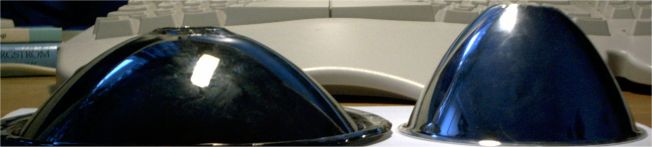

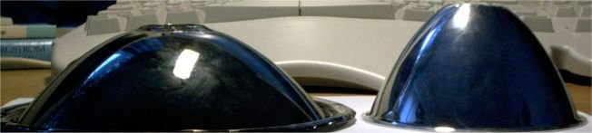

I just want to show the difference between a real parabolic reflector and a elictical/parabolic reflector. The reflector to the right is a true and orignal parabolic reflector, to the left the deep parabolic or eliptical reflector or what you want to call it. In my design where I say eliptical I mean the deep parabolicreflector. This is the type of reflector you must use in the slideprojector design.
