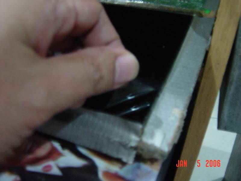

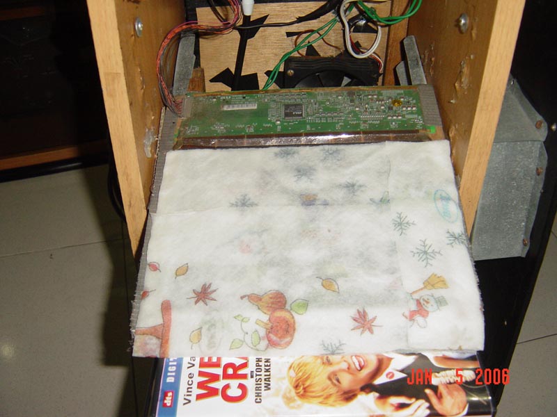

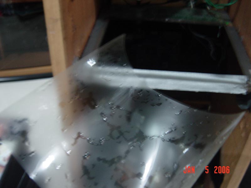

Run the pj 30mins after ag removal. Sample image with still some light leaks at the side.
Got huge increase in brightness!
