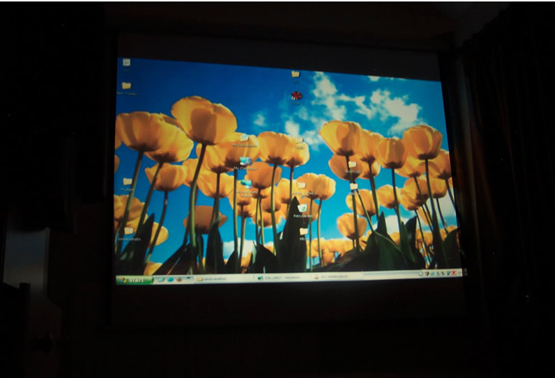

heya the Mazta!
i've seen your pics a dozen times already!
Anything new? Maybe you should borrow a good camera
I want to see how beautiful the liliput projected image is because here in the Philippines, a lot of guys wants to build a projector using the liliput.
Your work is now a model for alot of people because of small size and excellent image result.

mines pretty basic mate, aces, is one you wanna look at, my camera is latest tech, just need to find right setting, i'm also standing about 10 feet away when i take it, trust me, its like having a plasma screen on the wall its that clear and bright, Lilliput 7" all the way mate, simple to strip with outstanding results, ace has got all the optics to go with it, and lets face it, unless you get quality optics, your lilli will be wasted,

watch stuart little2. this time i use the pc as video source. Using pc is so inconvenient for me. created a lot of mess in the room but its worth it.
Check out more of the images at
http://s6.invisionfree.com/diyprojectorphils/index.php?showtopic=26&st=0#entry1889530
