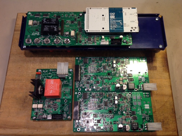

Completed the supply at last. I had a few wrong part because I kept using my custom BOM built from one of the first version of the official BOM. There was errors in it, so I ended up buying some incorrect parts. But now the BOM is mature with no error.
Then I started each PCB, starting from the from the Arduino Shield. Test it with a 5V supply, I had to reverse all red leds that are incorrectly marked, there was a mods published for that. Programmed the Arduino, but I was not able to save the display calibration. After close inspection some configuration jumper were not making contact, I used short lenght of wire. Replaced then with the proper SMD 0R jumper, and the display was working fine.
Then the rear Auxiliary supply, tested by itself. and everything was ok.

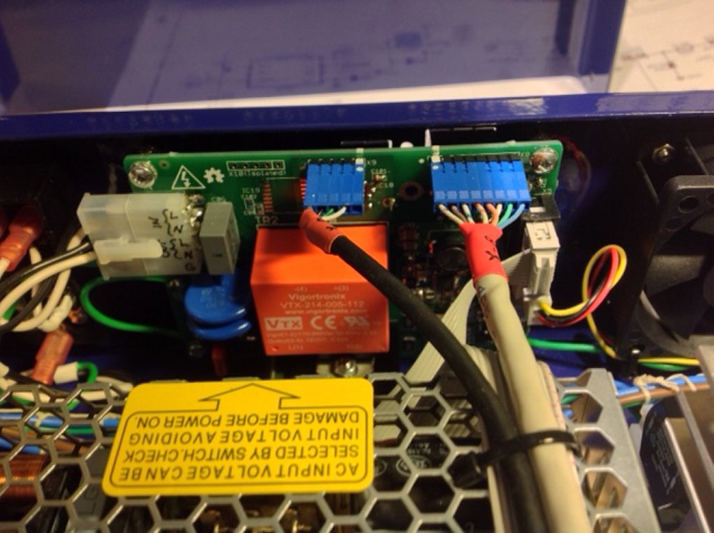

Finally both Power PCB. There was assembly errors on those, some incorrect resistors values (from the BOM), unsoldered parts ends, bad solder junction from high current pads, etc... Using the supplied testing procedure I was able to make both board working.

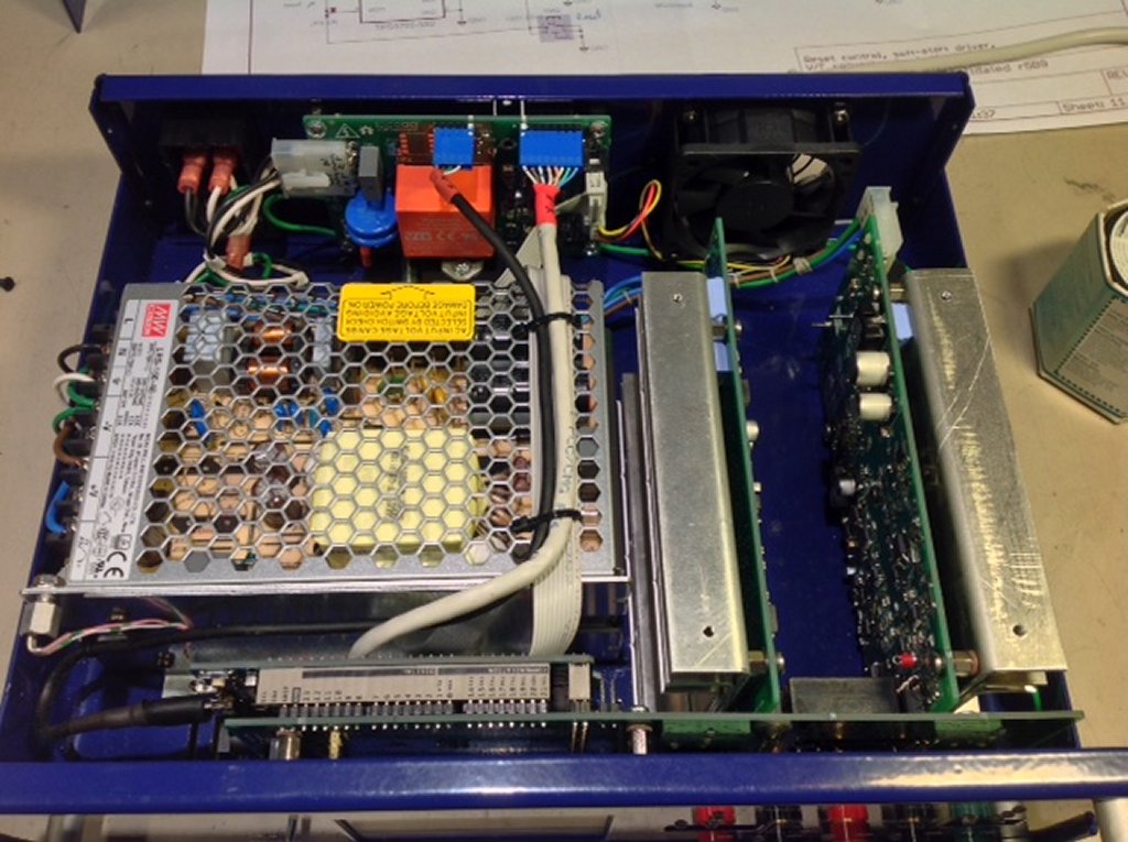

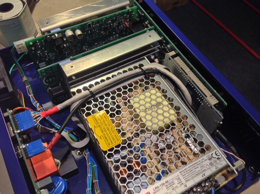

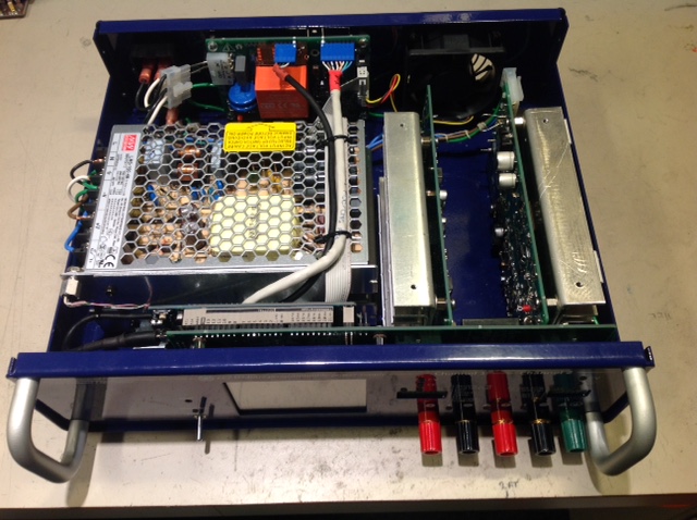

Then I put everything together, but surprise I was getting fault from both Power PCB at startup, and the Arduino was shuting back to standby. Problem was that the AC/DC main power supplies were not ON at startup, so it was normal that both PWR PCB, supplied from these were not working at startup!
Took me a little while to find IC31 was not working, AND gate output was always off, even with two high at the input. Replaced it, and Voilà! the power supply was working.
It was a great troubleshooting experience, and you can't beat soldering 800 smd parts, to learn how to mount them :eek:
The designer team was of a great help during my troubleshooting, with sometime custom testing programs, suggestions, and proposed tests. It was a great experience.
Thanks guys.
Here my supply pictures

Congratulations! It's nice to see that someone else successfully replicate it.
Hopefully it will works as intended and that firmware will do its job.
It will be also interesting to hear of your experience about programming output values with this "encoderless" front panel. Many people think that a programmable power supply must have an encoder (or two, or four) :).
