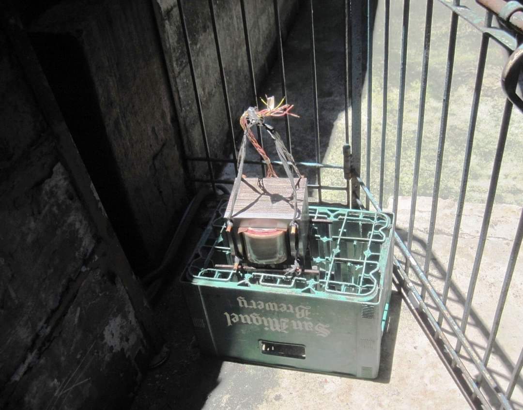

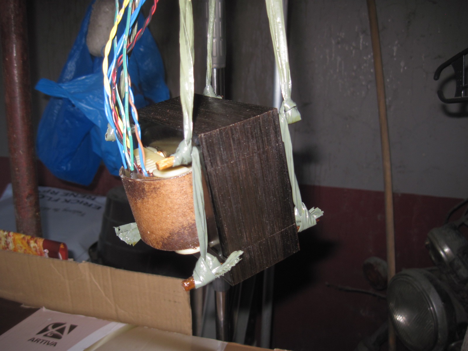

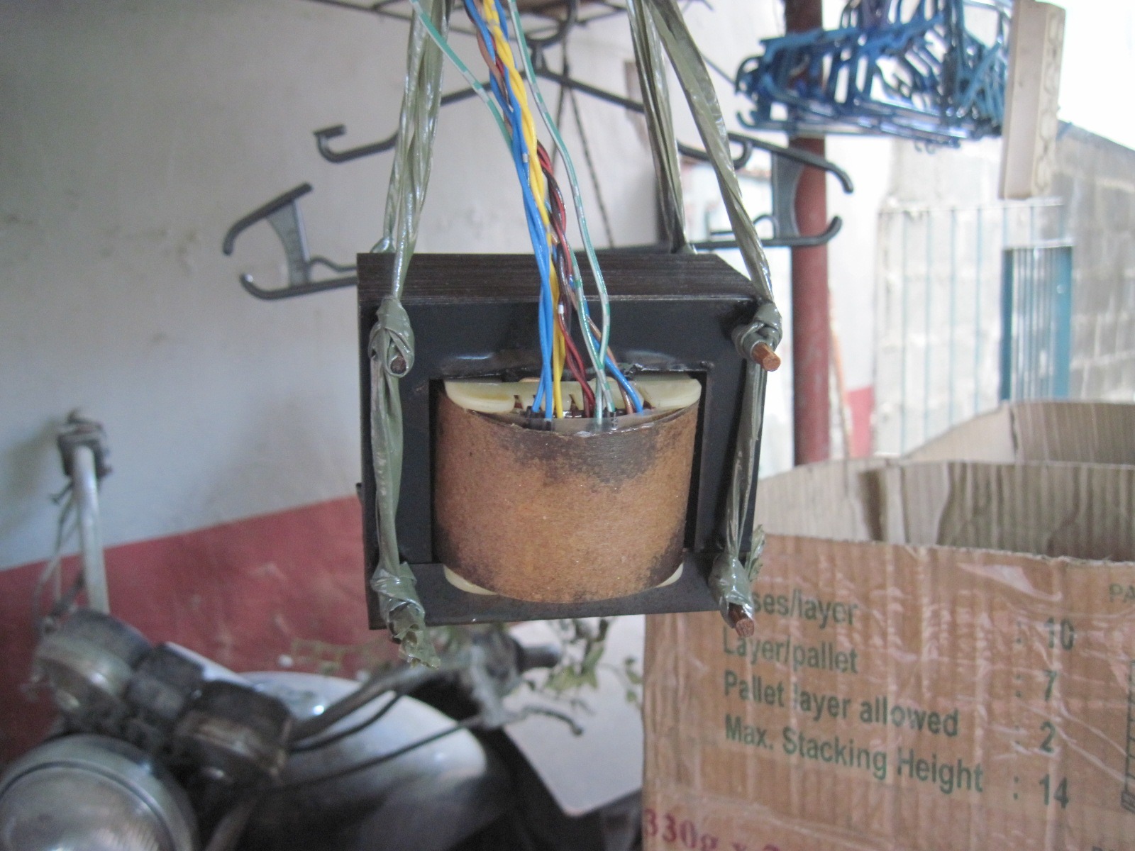

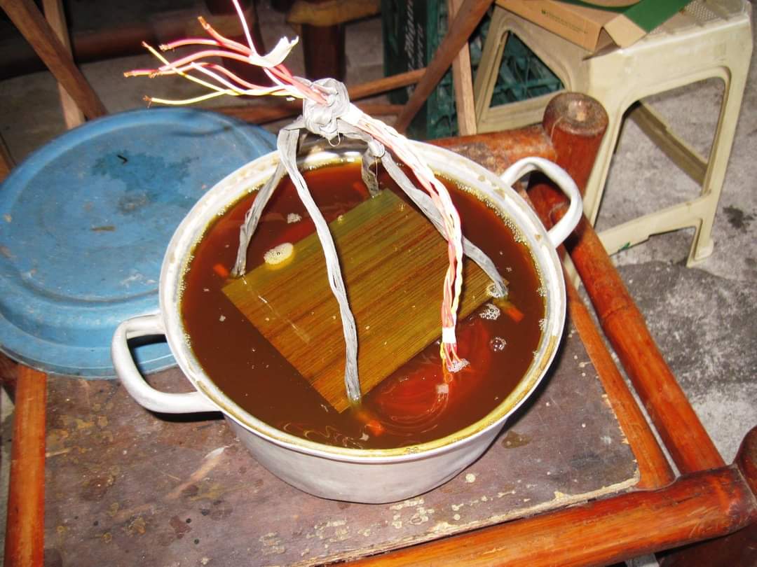

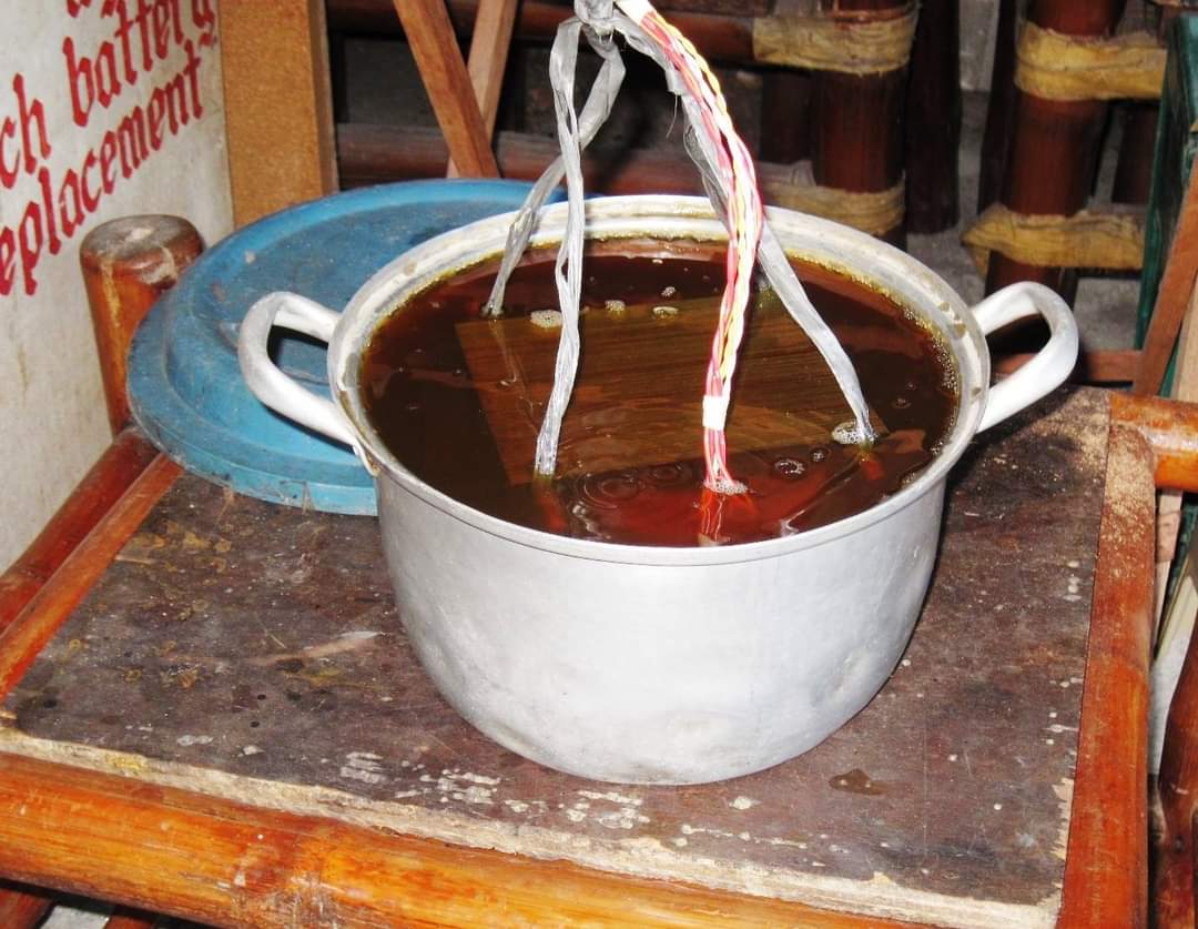

this is how i do my completed transformer, after verifying the transformer I built, I dip in a tub full of varnish, let is soak for a while until bubbles are gone. then lift to drip and then dip it again, the process takes about help an hour..

it ia very warm in Manila all year round to that soaking under the sun for a couple of days cures the varnish....
i use air drying varnish...

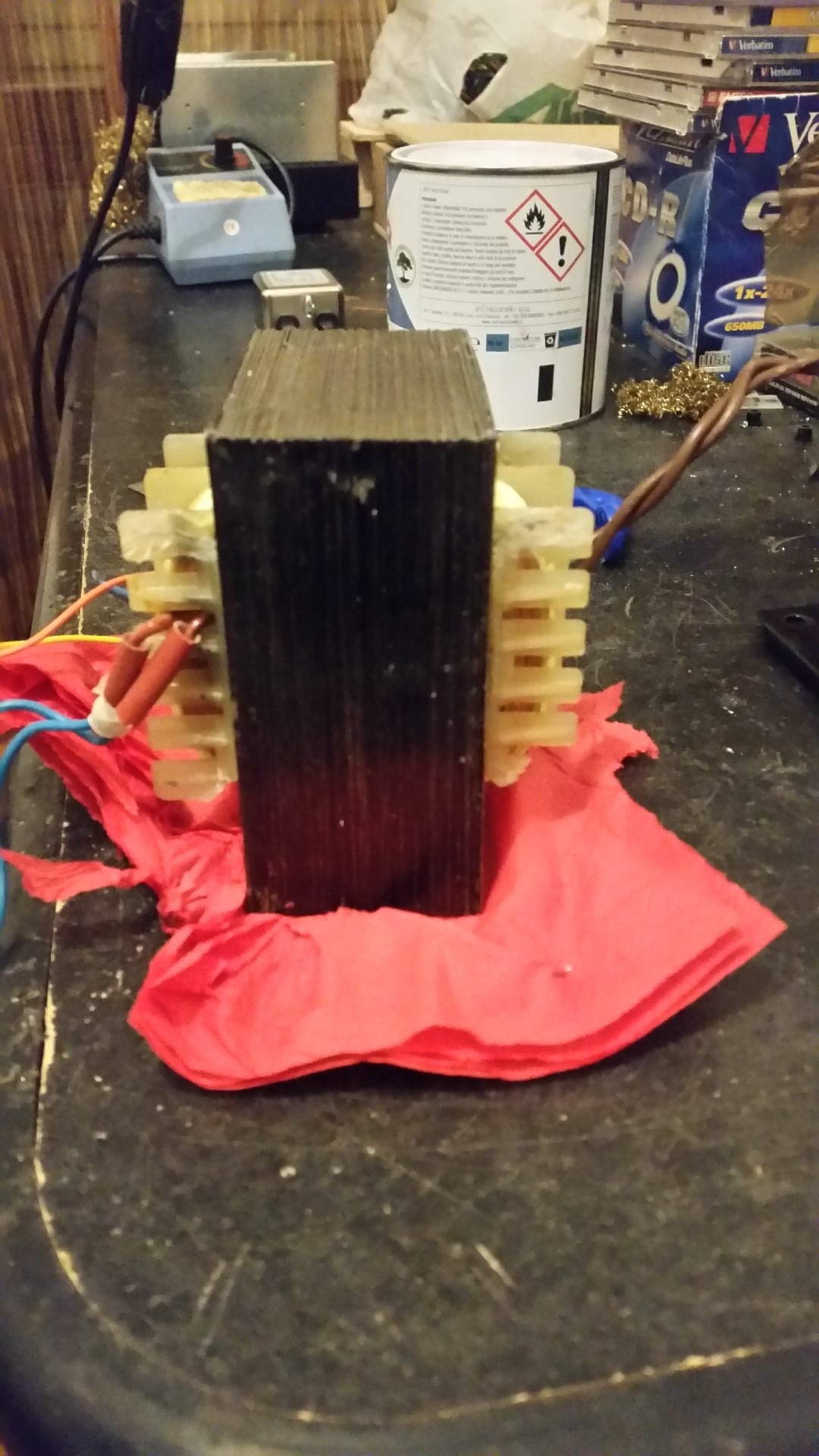

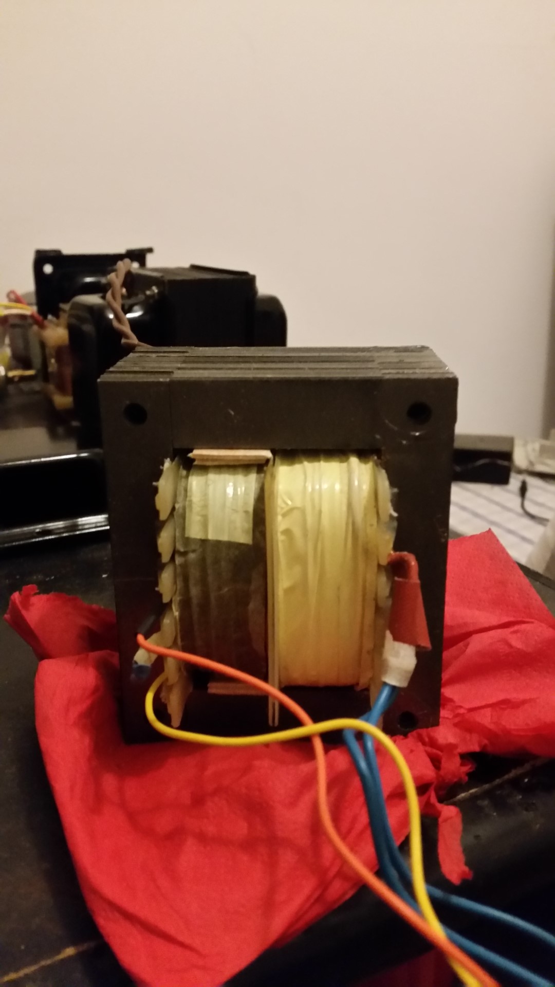

I did a test with a monocomponent polyurethane varnish, the one for boat coating... However, I didn't completely dip it as you previously suggested but I "soaked" it with a brush after having loosened the lamination core (removed a couple of them) and then I held it tight a daylong using clamps.
The result seems good for now, although it is not bolted, it is completely silent. I'll have to try it with the power running

Update on the transformer situation when it operates...
As usual with no load, absolutely zero buzzing, when the current starts to flow on the KT88 (evident by the LEDs on the cathode of the drivers turning on) the noise is present although overall low.
Before the modification I had noticed that adding an RC filter downstream of the first CLC slightly increased the noise. I should maybe try removing it and see. I was also wondering if the diodes used could possibly be responsible, they are IN5408.
Last thing, now I got the epoxy resin DUROGLASS P5/1 LV,, Maybe it's worth a try on the transformer, this time dipping it thorough bobbing included...
