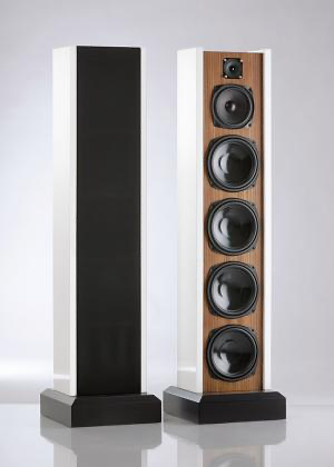

FWIW, I went with 2x Seas H1252-08 and 1x 18Sound NSD1095N per side, which works really nicely. The crossover is just below 1kHz, pretty steep, and has a notch to help kill off the cone breakup. The RS225 will likely need similar. Trying to match such a driver to a typical 1" dome tweeter would likely be very difficult, but compression drivers will run lower and have more headroom.
To keep the wiring and impedance sensible, I'd suggest 4x RS225-4 per side with a good compression driver. MTMWW would be a sensible layout. With that much cone area, you could probably tune pretty low and still have decent output available.
That only leaves 2x RS225 going to waste, and I'm sure you could think of something to do with those.

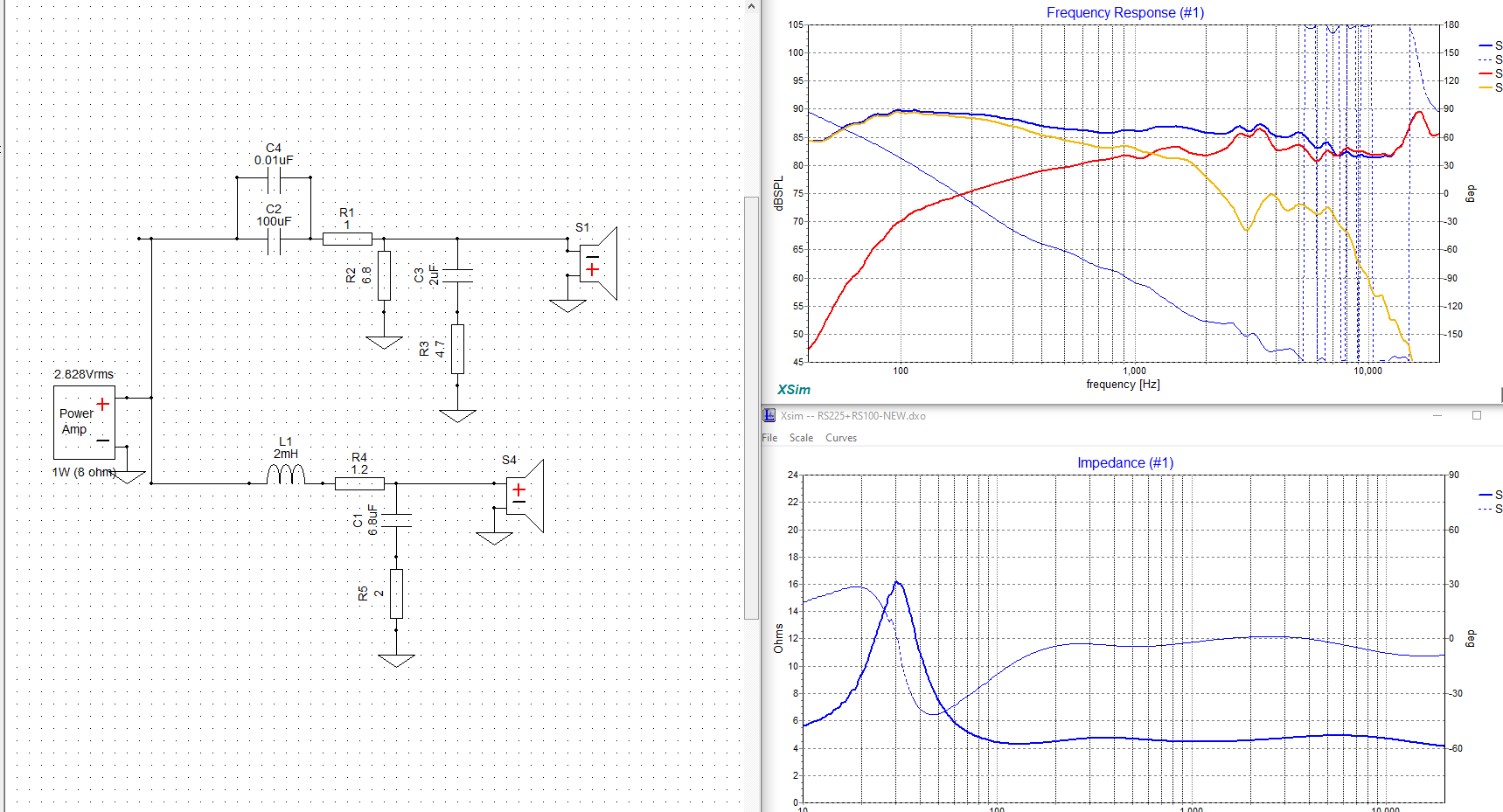

OP "the 10 stupid RS225-4 sitting in my basement going to waste, but seems that woofer is a pile to 2way without a gold mine XO."
see Post #1, #1019, #2537, #2538, #3765
post#1

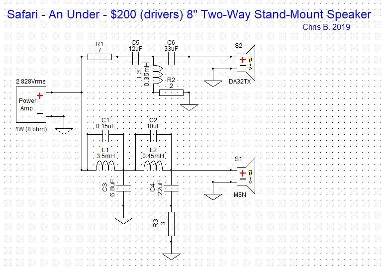

"Edit May 19, 2020: this is the XO for the 4ohm RS225-4. You can use your favorite 8ohm 3.5in full range on top. Just make sure it’s 8ohms and adjust R1 to taste."
