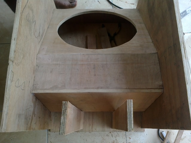

DIY PA Speakers Setup (Line Array)
26+26l 12inch bandpass + 8l 8inch midle

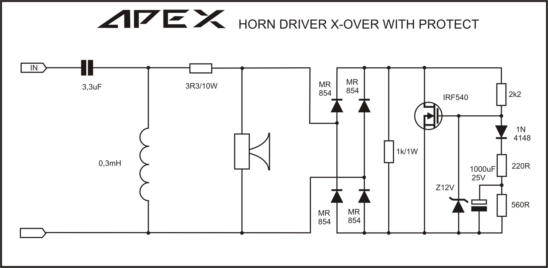

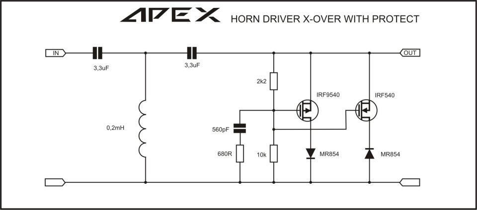

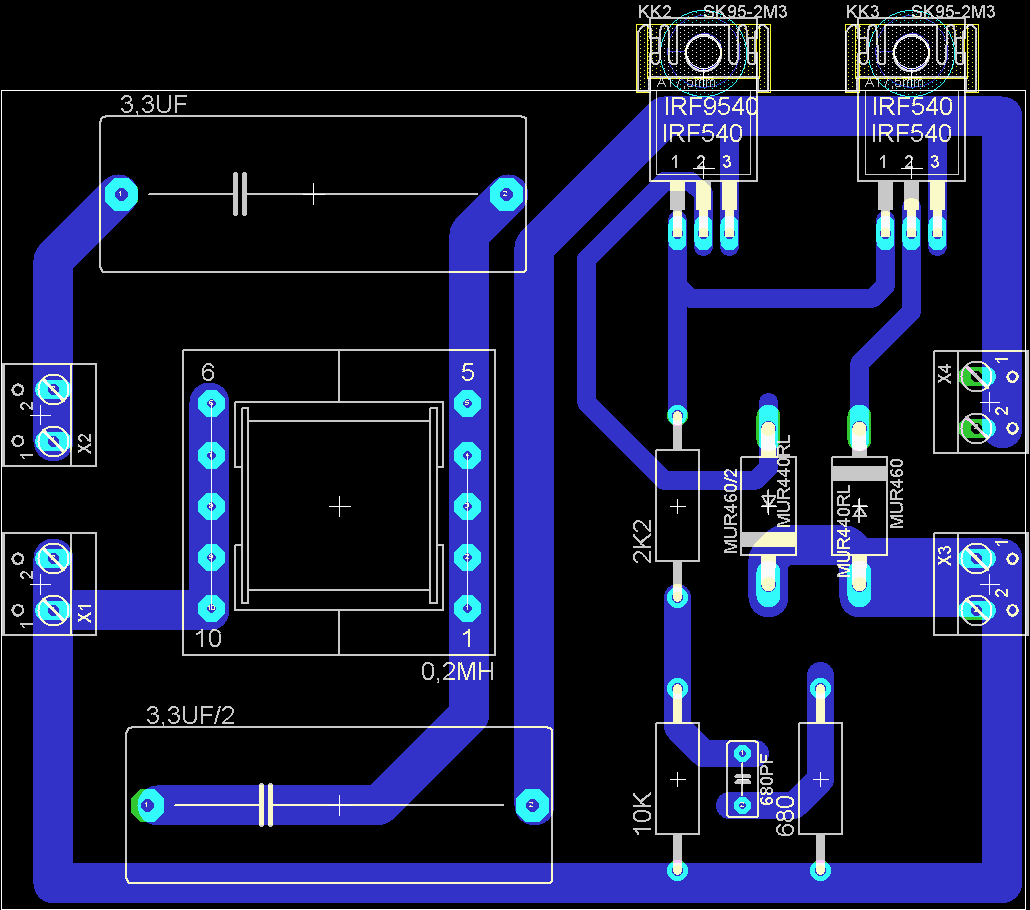

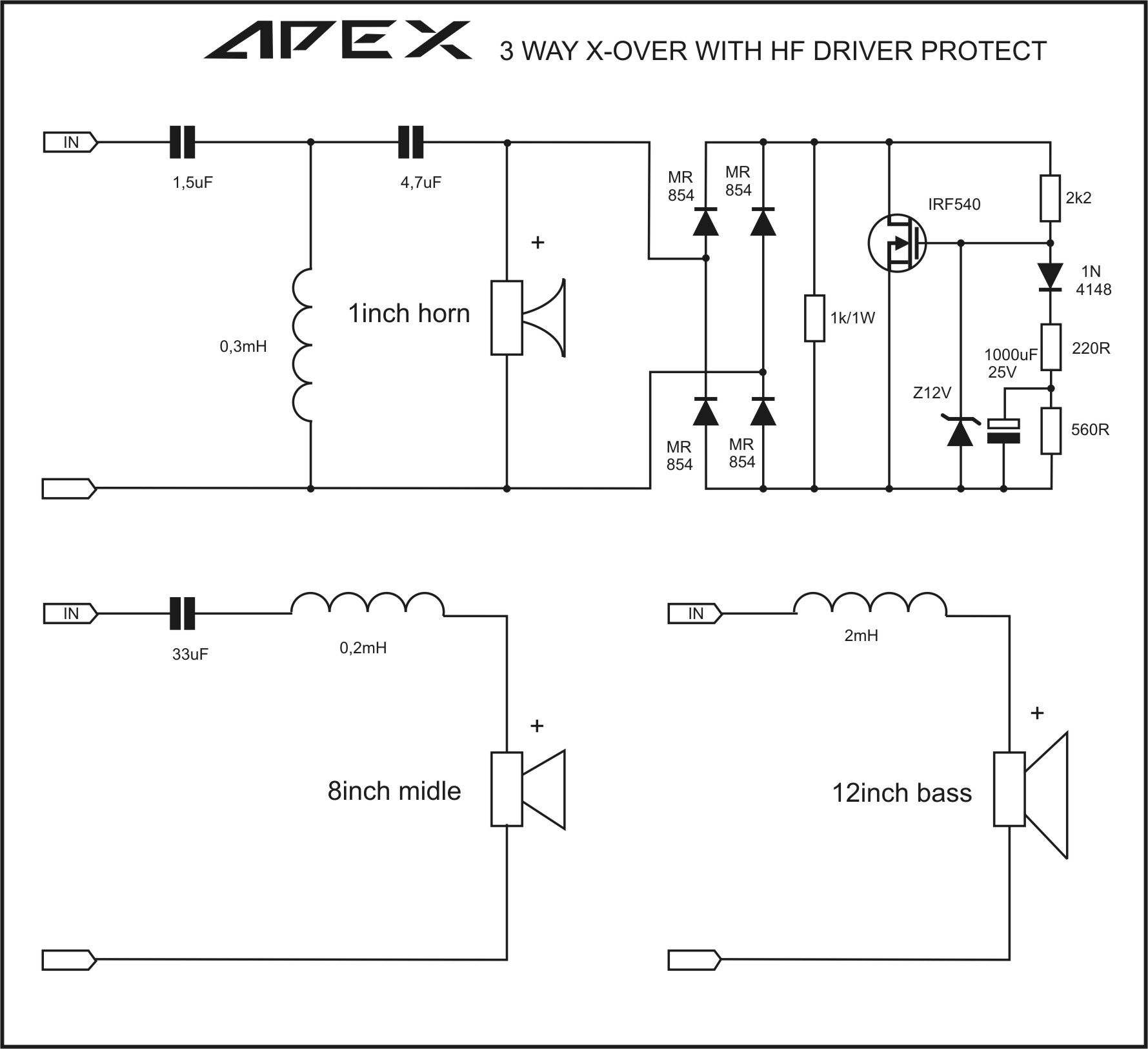

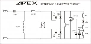

Dear Apex,
I understand from your post that Mosfet Xover are better than BJT based.
I have seen two types of Mosfet Xover.
Let me know the which is better?
Or advantages of both the circuits.
Or suggest which is best for using 2" throat driver.
