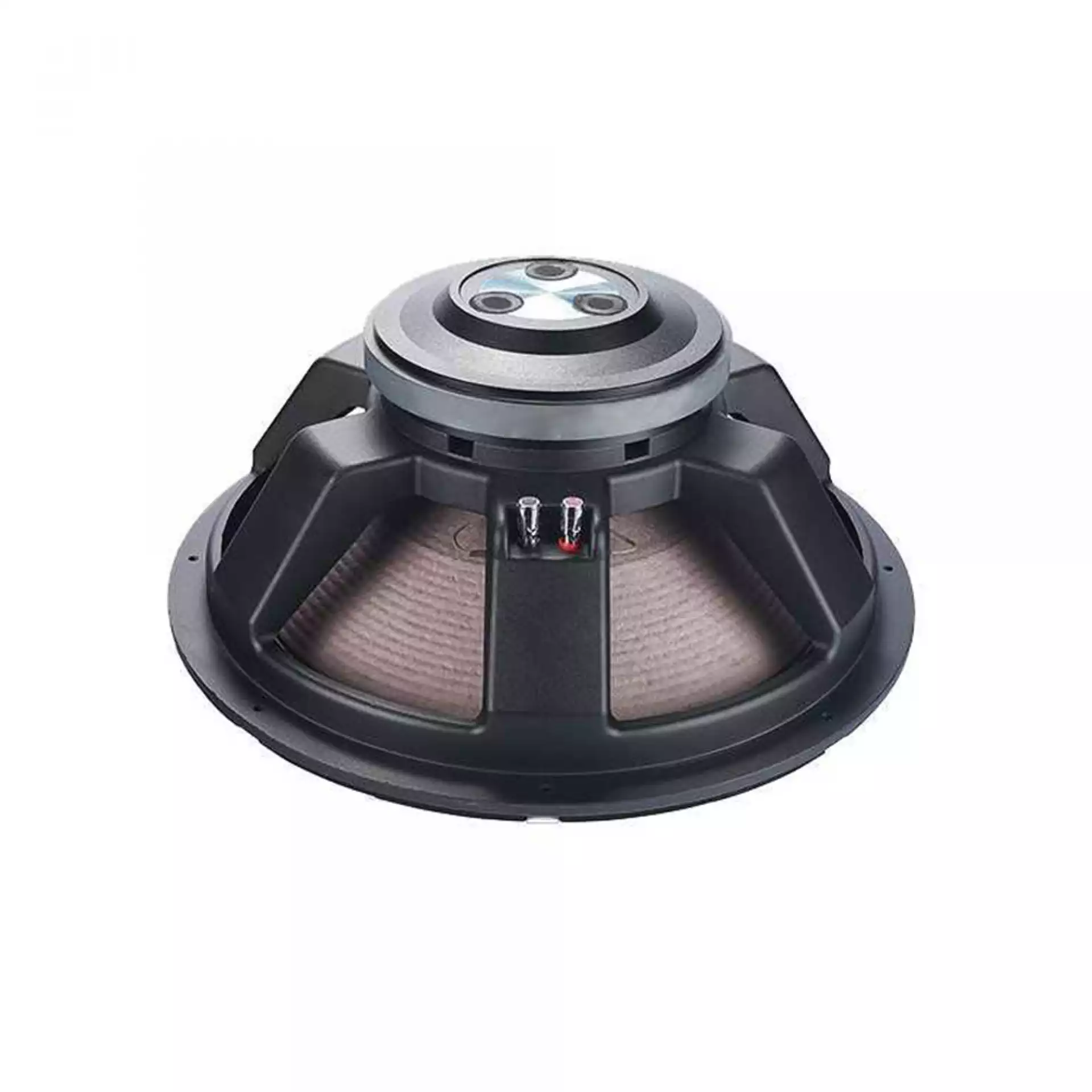

That 18" driver looks like a serious candidate given that its specs include a real world power rating of 750 W RMS (1500 W MAX) and the T/S parameters required to design a suitable enclosure.
P.S. RMS equates to the continuous power I mentioned earlier, and MAX equates to the peak power.

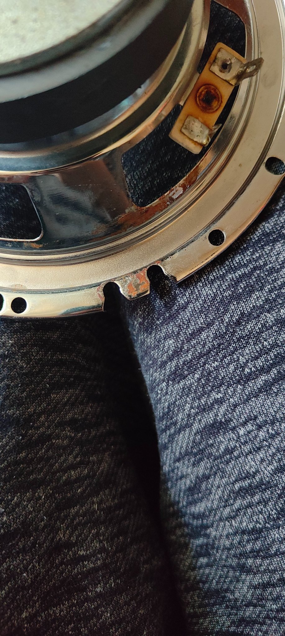

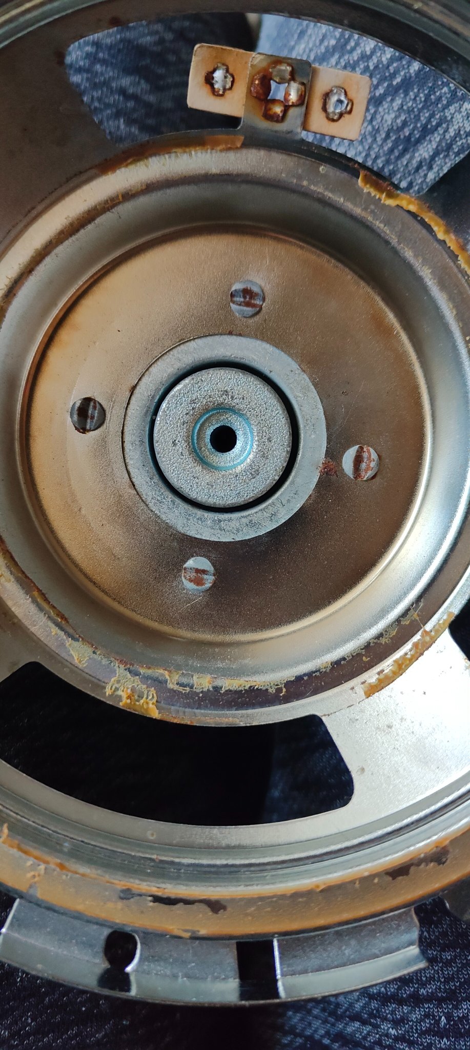

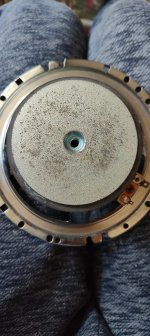

@Freedom666 here now sorry for the late response but the school started and i dont have much time for diy projects now there is like a lot of rust and can i use vinegar to like soke the metal parts idk about feride magnet. And now that i have access to the 3d printed i was thinking of making them powered to have like tpa3110 and a speaker on each channel.
can that sub be like in a rcf esw 1018 box
By "that sub" you mean the Martin Wisman HPLX 18 driver pictured in post #47: https://www.player.rs/ozvucenje/ugradni-zvucnici-i-oprema/18-inca-i-vece/martin-wisman-hplx-18
And the "RCF ESW 1018 box" pictured below is described as a "horn bass reflex" type:
For reference, here are the plans for the RCF ESW 1018 box:
You ask if the Martin Wisman HPLX 18 driver could be used in the box shown in the video above.
My answer can only be "possibly", as I am not in the position to do the mathematics to confirm that this would be an ideal match.
